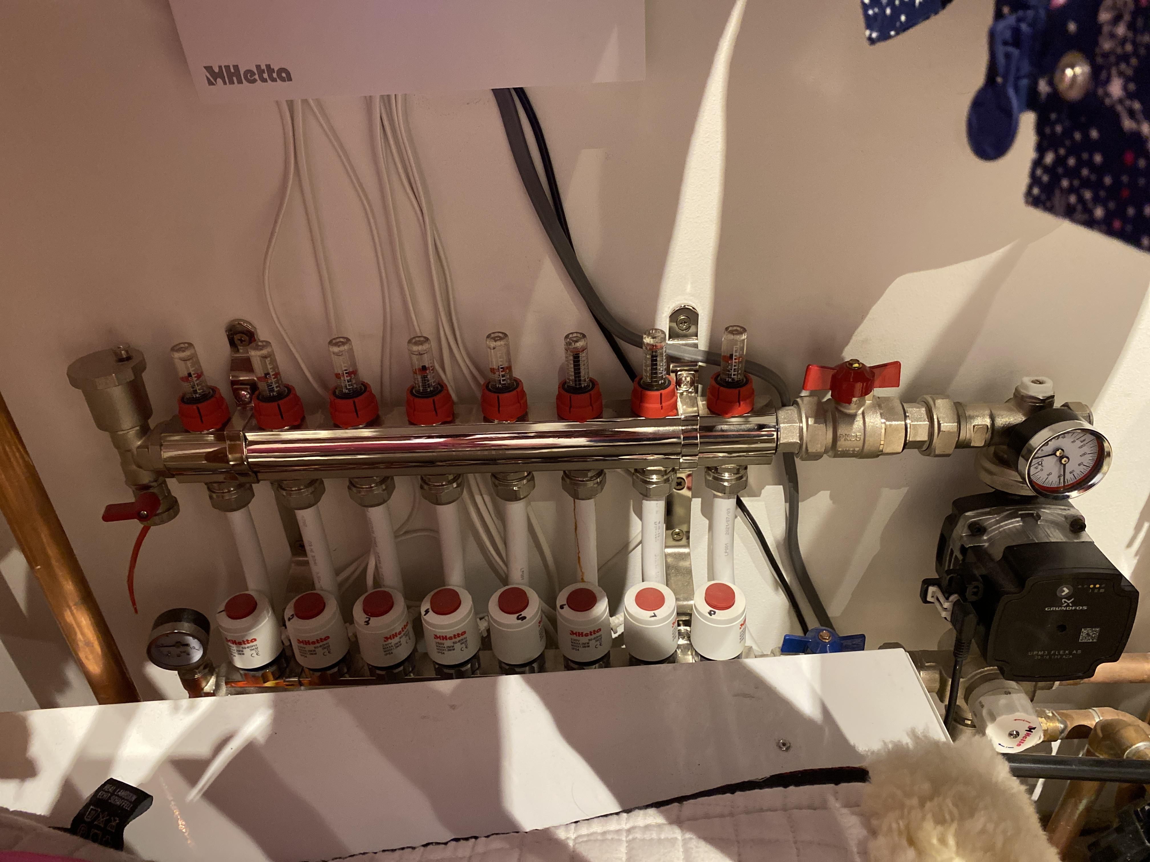

Do they only make left handed manifolds?
I am thinking ahead to the routing of the hot feed into my UFH manifold and it would be simpler to position the circulation pump to the right of the manifold. All examples I can find show the circulation pump to the left.
Is it feasible to position an UFH circulation pump to the right of a manifold?
My UFH installation will be for 60 m2 on the ground floor with just 4 loops and 2 zones.
Not mine, just Googled.  98% are left hand.  I guess it is simpler that way.  With the one below you may be more restricted with components that can be handed either way?  A plumber may give a proper answer, but they are too busy counting money at the moment.
Your photo offers encouragement.
I followed link from @Nickfromwales to the following product https://underfloorparts.co.uk/product/unimix-blending-4-port-underfloor-heating-manifold-with-grundfos-upm3-pump-uni-mix-temperature-control-mixer-valve/
In the description is says "the Uni-Mix Valve must be fitted on the left side" which got me thinking. So maybe the manifolds are ambidextrous but the add-on bits are left or right handed.
I had the same question! Ours arrived left handed and I panicked before having a quick look around. It transpires that most can be adapted easily enough to go both ways. Our set up is now right handed too!
good luck!
Mine is right handed too, 99% sure it could be set up either way around- I certainly can't remember any reason why it couldn't!
