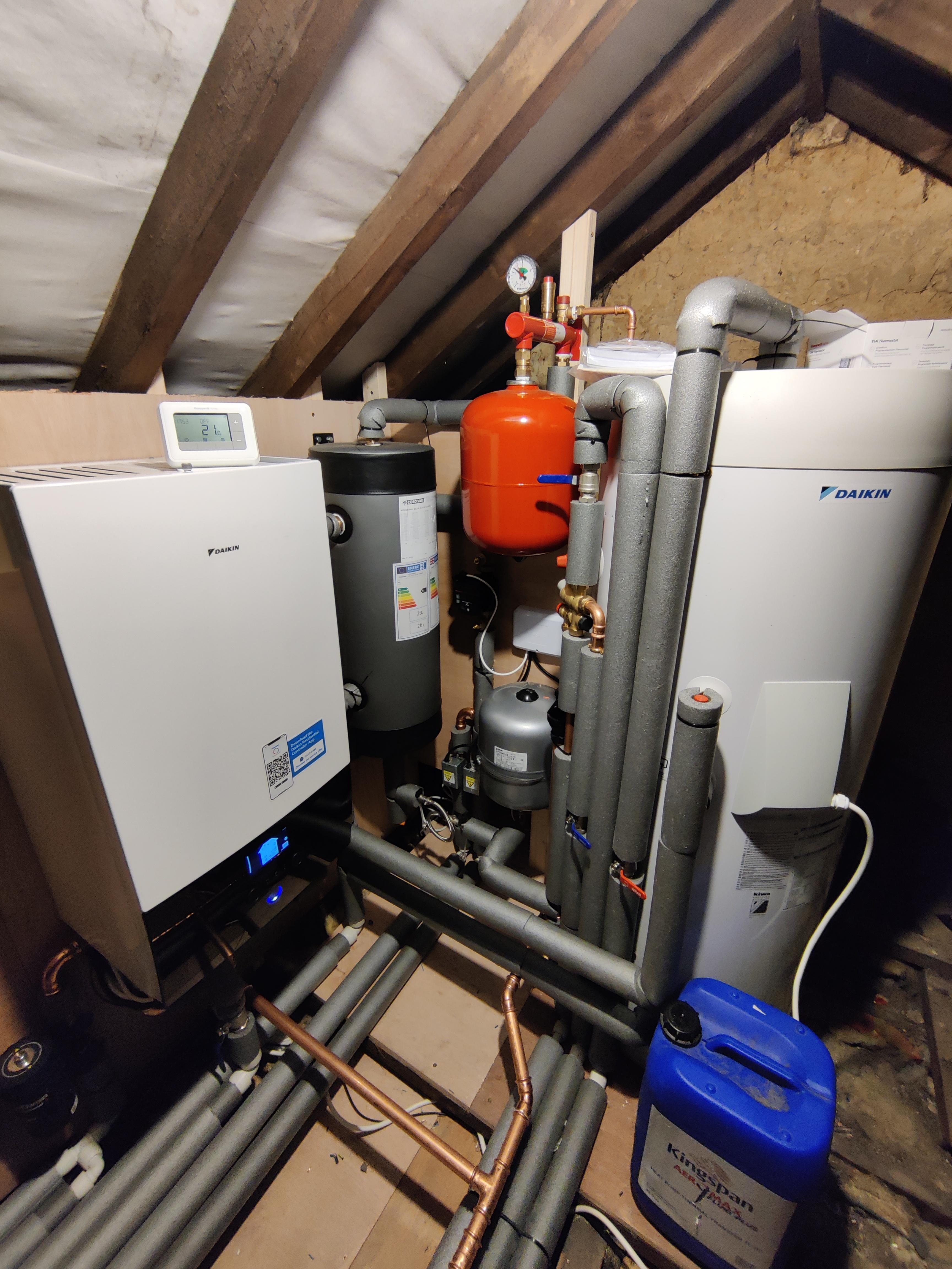

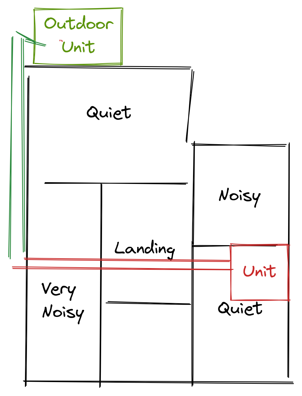

rhymecheat Posted January 24, 2022 Share Posted January 24, 2022 Hi all. I’ve got a split Altherma 3 H HT and the indoor unit is wall mounted in the loft. The loft is insulated but not boarder, apart from the base built specifically for this installation. I’ve attached a picture of the setup up there for clarity. I’ve noticed that if I leave the heating on overnight (at about 35/40C) I hear a constant humming on the top floor that is rather irritating during the night as there are no other competing noises. I’ve measured this noise to about 26dbA at ear level when lying in bed. The hum seems to come from the indoor units pump. It has a configurable pump speed which I’ve already set to the minimum (60%) but it’s still rather loud. Interestingly I would expect the hum to be stronger on the rooms directly below the unit but that’s not true. The room directly below the unit is actually quiet (as is the room that’s further away from the unit, but that one makes sense). It’s the other rooms that seem to have it worse. Again, attached a drawing of the layout for better understanding (green for ground level, black for first floor and red for loft) my questions: 1. Is this Normal and I should just turn the thing off when I want to sleep? 2. How can I reduce this noise further? 3. Why is it not the loudest directly below it? Thank you very much in advance Link to comment Share on other sites More sharing options...

Jenki Posted January 24, 2022 Share Posted January 24, 2022 Resonance in the pipework could also create this. I would look at clipping all the pipes, I can't see any clips on yours for insulation, but you could put some waste water pipe clips over pipe and insulation. Either 32mm or 40mm but you want to reduce any vibration. So smaller may be better. Link to comment Share on other sites More sharing options...
