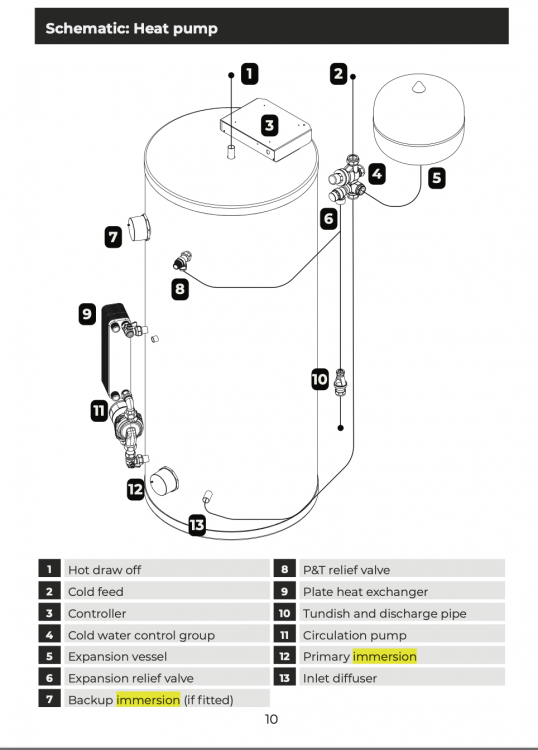

BartW Posted January 22, 2022 Share Posted January 22, 2022 Hi All, I thought I had it all selected, and decided on, but... Clearly not. So here goes: I was heart set on Vaillant Arotherm plus 7kW (or 9kW) + Unistor / tower and all gubbins (around 210L tank). Having read some posts here, I started reviewing. Vaillant is vague about COP in their literature. Only SCOP values get quoted... I looked at what other market options are available, and figure that most claim similar COP, i.e. 4.5 @ A7C/W35, 3.5 @ A2C/W35. Lower A temps are less of a concern for us, as we are in Oxfordshire, and whilst we may observe temps dipping below 0C at night, we could have things set to utilise excess energy from 5.5kWp solar PV to charge the tank, and generally use 5p/kWh night tariff if need be. But then come the choices: - Panasonic HP - Panasonic TCAP (expensive and really meant for severe Winter weather) - Daikin? - Samsung? (being 40% less than, say Panasonic) - Mitsubishi? - LG Therma V (similar money to Panasonic) The other dilemma is whether to go: - all separates - Monoblock + tank + buffer inside - Monoblock + All-In+One Any benefits to the above three solutions? And does paying £3.5k for a "good pump" pay off in the long run vs buying one for £2k? On a separate note, I can see that some sources (manufacturers) show Low Loss header in their schematics vs Buffer tank. Would one ever do that? I suppose, it's cheaper but surely the tank is the correct thing to consider? PS. The house is going to be 0.15 uVal all around and with MVHR. 180m2 build, if that helps things and the perspective. Apologies for the barrage of questions, but I have now managed to hit the wall without being any smarter, or more decided. Many thanks! Bart Link to comment Share on other sites More sharing options...
Dan F Posted January 22, 2022 Share Posted January 22, 2022 (edited) 1 hour ago, BartW said: I was heart set on Vaillant Arotherm plus 7kW (or 9kW) + Unistor / tower and all gubbins (around 210L tank). We have this one, also 7kW. Next size up is 10kW. We have it set up with the Vailant Hydraulic Unit (3-port valve, controller, diverter, backup heater) and a 25L non-vaillant buffer tank. Quote Having read some posts here, I started reviewing. Vaillant is vague about COP in their literature. Only SCOP values get quoted... They do also quote some COP figures in manual/literature, but I agree it is limited compared to other manufactuers. I have all the very detailed COP and power ouput data I found if you need it. 1 hour ago, BartW said: COP, i.e. 4.5 @ A7C/W35, 3.5 @ A2C/W3 The 7kW aroTherm gives you - A7/W35: COP 3.9 at 100% compressor providing 12.3kW output, COP 4.8 at 50% compressor providing 6.3kW output. - A2/W35: COP 3.3 at 100% compressor providing 10.4kW output, COP 4.1 at 50% compressor providing 5.4kW output. (No manufacturs quote COP at max compressor though, as the idea is that ASHP is sized to not need to run at full-filt.) Various other great manufactuers out there, but R290 does have some advantages in terms of range of operating temperatures and max flow temp. Edited January 22, 2022 by Dan F 1 Link to comment Share on other sites More sharing options...
BartW Posted January 22, 2022 Author Share Posted January 22, 2022 Thanks Dan, This is useful, and fills the gap in the spec that I was after. What were the reasons you went for the AroThermPlus? To me the initial choices were based on: - quieter than others (debatably?) - higher max temp, ref: Legionella heat cycle - it is prettier (ok, I know, I know...) - it is Vaillant Also, what is your setup? Did you go for the full unitower? Link to comment Share on other sites More sharing options...
Dan F Posted January 22, 2022 Share Posted January 22, 2022 (edited) 21 minutes ago, BartW said: What were the reasons you went for the AroThermPlus? I'm not sure if COP and sound were necesarily the best, but certainly amoung the best. But one of the things that pushed me towards this model was the fact it's R290-based which is: 1) Better for the environment (lower GWP) 2) Has really good operating range (can still do 60C DHW down to -10C for example, not many can) 3) Ability to easily reach 70C DHW temps in UK climate at almost any time of year (-5 -> 25C external) Why was I interested in high DHW temps: - Firstly, while the plan was to run UVC at low temps, I was concerned about capacity (e.g. when having guests). One way to solve this capacity issue (temporarily) is to use a hgher temperatures, and you can do this with aroTherm without needing to use immersion. - Secondly, I was really keen to be able to load-shift (i.e. heat tank at night, use water during the day). The two approach to load shifting I looked at (Sunamp, Mixergy) both required higher flow temperatures. Yes, higher flow temperatures have lower COP but; in my first scenario this is better than i) immersion of ii) running out of hot water, and in my second scenario heating 30% of the UVC/Sunamp with 60/65C water, is still better than heating a full tank to 50/55C if you might not use the full 300L for a few days. That was my thought process anyway. Ended up going with a Mixergy tank (so no Unitower) and we are heating it via top/indirect coil rather than low-temp heat-pump assembly to achieve what they call "partial charging" . It does actually work really well, just it doesn't keep partial charge state over multiple days as well like a Sunamp would. It's a bit more short-term (given losses and I assume heat transfer through thermocline etc.) Edited January 22, 2022 by Dan F Link to comment Share on other sites More sharing options...

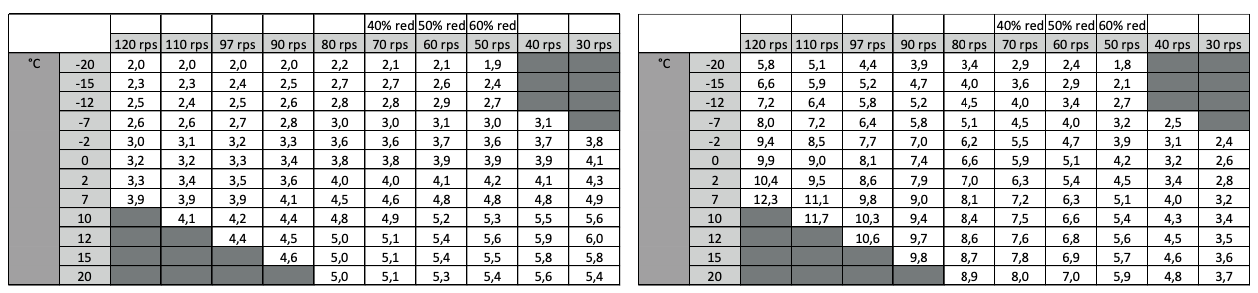

SteamyTea Posted January 22, 2022 Share Posted January 22, 2022 2 hours ago, BartW said: Vaillant Arotherm plus 7kW (or 9kW) 2 hours ago, BartW said: 4.5 @ A7C/W35, 3.5 @ A2C/W35. What are your calculated heat loads at those temperatures? 1 Link to comment Share on other sites More sharing options...
Kevm Posted January 22, 2022 Share Posted January 22, 2022 This is some detail from Mitsubishi for comparison. The grey rows include a defrost allowance. IMO it's more important to get the design and operation right than which reputable manufacturer you choose. I have the 14kW Ecodan installed with no LLH/buffers and it seems to work fine. 2 hours ago, BartW said: Link to comment Share on other sites More sharing options...
BartW Posted January 22, 2022 Author Share Posted January 22, 2022 1 hour ago, Dan F said: That was my thought process anyway. Ended up going with a Mixergy tank (so no Unitower) and we are heating it via top/indirect coil rather than low-temp heat-pump assembly to achieve what they call "partial charging" . It does actually work really well, just it doesn't keep partial charge state over multiple days as well like a Sunamp would. It's a bit more short-term (given losses and I assume heat transfer through thermocline etc.) This got me really interested, and I started reading about Mixergy tank. Really impressive! With the anticipated 200L tank as specified by BPC, would one choose same tank size in Mixergy? The price difference between 150L and 300L is within £200. So not a huge deal of a difference. Is there a point in "future proofing" for multiple guest visits? We would (eventually) be a family of 2 + 2, with potential parents, in-laws, and friends visiting (admittedly, not all at the same time). 1 hour ago, SteamyTea said: What are your calculated heat loads at those temperatures? Sorry, I don't think I understood you. I am just quoting "the brochures". 1 hour ago, Kevm said: have the 14kW Ecodan installed with no LLH/buffers and it seems to work fine. Does it not short cycle? Further to the above, I am starting to think that a cheaper pump would equally do the full job. I particularly am liking the Mixergy tech. The thought process here is that I could: - charge at night @ 5p/kW for four hours through the ASHP - utilise excess energy from 5.5kWp solar PV during the day, and either run ASHP at that time, or 3kW immersion heater element Now, is there a way to store energy for space heating during the day when excess energy is available, or at night when the tariff is cheap, with view to, say, discharging the heat into the UFH in time before everyone gets up in the morning? Thanks! Bart Link to comment Share on other sites More sharing options...

Dan F Posted January 22, 2022 Share Posted January 22, 2022 (edited) 2 hours ago, Kevm said: This is some detail from Mitsubishi for comparison. Seems Vaillant may be bit better than. It's also worth comparing operating ranges too. 57 minutes ago, BartW said: Sorry, I don't think I understood you. I am just quoting "the brochures". @SteamyTea Is making the point that before you specify an ASHP you need a clear understand of you heat demand, to ensure you spec the right size, to get best COP, avoid short-cycling and ensure your house is warm. Our heating load is 3kW, so easily covered by 7kW ASHP while running in eco mode with low compressor speed and high COP. 7kW doesn't give you a very fast UVC reheat time though, so that's another reason we used mixergy with a top indirect coil as it means you can fairly quickily heat the top 30% of the tank and take a nice shower without waiting as long as you'd typically need to wait if you had a heat-pump tank with a large coil lower down. 57 minutes ago, BartW said: Is there a point in "future proofing" for multiple guest visits? The view I took on this was to calculate tank size for the family based on 50C, knowing that if extra capacity was required I could increase temperature to, say 65C, confidently with the aroTherm. Assuming you aren't using something like Mixergy, this has the advantage of avoiding heating (and associated losses) a larger tank all year round. The other way we have increased effective capacity (showers you get from a tank of hot water) is via the use of WWHRS units which gives you an extra 30%+ shower time for same hot water usage. 57 minutes ago, BartW said: Now, is there a way to store energy for space heating during the day when excess energy is available, or at night when the tariff is cheap, with view to, say, discharging the heat into the UFH in time before everyone gets up in the morning? You could use a PCM43 Sunamp for this. But the simplest and very effective approach that many people on the forum use is to have UFH pipes in your slab and use it as a massive storage heater. This way you can dump heat into it at night quite easily and not get any real peaks in temperature. @TerryE has some great posts on this. Edited January 22, 2022 by Dan F Link to comment Share on other sites More sharing options...

BartW Posted January 22, 2022 Author Share Posted January 22, 2022 22 minutes ago, Dan F said: so that's another reason we used mixergy with a top indirect coil as it means you can fairly quickily heat the top 30% of the tank and take a nice shower without waiting as long as you'd typically need to wait if you had a heat-pump tank with a large coil lower down. Do you refer to the built-in Mixergy coil? I would imagine any night time tariff, and daytime solar PV discharge would nicely play together with it. 23 minutes ago, Dan F said: could increase temperature to, say 65C, It seems that other pumps do that too (perhaps not 65C, but 60C?) 24 minutes ago, Dan F said: WWHRS units which gives you an extra 30%+ shower time for same hot water usage. I considered that, and whilst it (apparently) boosts your SAP a lot, I am yet to establish if I will ever see a return on the £500 to £700 unit (multiplied by two out of three bathrooms). 26 minutes ago, Dan F said: many people on the forum use is to have UFH pipes in your slab and use it as a massive storage heater. This way you can dump heat into it at night quite easily and not get any real peaks in temperature. @TerryE has some great posts on this. Yes, this is what's rather logical and "free". But will I in effect overheat during the day? Or would I hope that MVHR would, somewhat, redistribute the mass of air across the rest of the rooms? 23 minutes ago, Dan F said: There is a speadsheet available in the forum that @Jeremy Harris put together that gets you really quite close, without having to pay a consultant to model it. If you are hiring someone to install an ASHP though, it's part of their job to run heat-loss calculations, before specifiying or installing anything. Not using a consultant, hence me trying to understand Hebrew by myself. Also, specifiers / suppliers like BPC , Nu-Heat and so on will specify whatever they want to sell, as long as their choices fall within the bands of criteria. So not unbiased... Above all, whilst I am trying to find a holy grail, I want to make sure that I am not overpaying for solutions that will never see me any return. I am not a purist, and not a tree hugger, either. But if I could make a wise choice, and not kill the planet, then surely I would feel better too. Also, it is likely it will not be a forever home. If it lasts us 10 years, then I think we have done alright. Chances are, we will build another one in 5 years time. Thanks! Bart Link to comment Share on other sites More sharing options...

Dan F Posted January 22, 2022 Share Posted January 22, 2022 37 minutes ago, BartW said: Do you refer to the built-in Mixergy coil? I would imagine any night time tariff, and daytime solar PV discharge would nicely play together with it. Mixergy doesn't have a built-in bottom coil as they recommended a different approach for using ASHP with an external PHE See: https://www.mixergy.co.uk/mixergy-heat-pumps-faqs/ This however, is not the approach I'm using, as aroTherm means the limitations mentioned here do not apply. This two-pager does a good job at summarizing the different approachs: https://www.dropbox.com/s/9091d4a0ut7i5am/Heat pump leaflet V1_compressed.pdf?dl=0 37 minutes ago, BartW said: It seems that other pumps do that too (perhaps not 65C, but 60C?) Yes, but you need to look at the operating range too. The ones I looked at could only supply 60C between 0-25C which I felt was a bit too tight given the approach I was planning to take. 37 minutes ago, BartW said: I considered that, and whilst it (apparently) boosts your SAP a lot, I am yet to establish if I will ever see a return on the £500 to £700 unit (multiplied by two out of three bathrooms). ROI from a pure energy usage perspective doesn't add up, unless you have very loong showers. But if you consider it's "greener" to recover rather than waste heat and it means you can get by with a smaller UVC, it did start to make sense from our perspective. (we didn't care about SAP, as house should score very high anyway). Link to comment Share on other sites More sharing options...

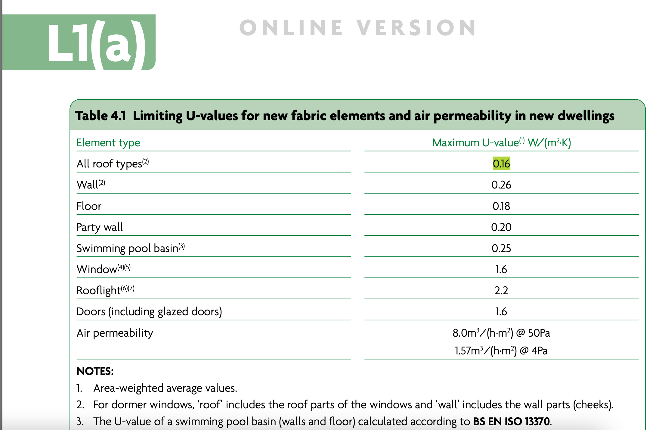

SteamyTea Posted January 22, 2022 Share Posted January 22, 2022 32 minutes ago, BartW said: 0.15 uValue all around, i.e. roof, slab, walls If you are having UFH in the slab you really want to improve on that. Top of my head I think roofs have to be a better U-Value. Link to comment Share on other sites More sharing options...
BartW Posted January 22, 2022 Author Share Posted January 22, 2022 2 minutes ago, SteamyTea said: If you are having UFH in the slab you really want to improve on that. Top of my head I think roofs have to be a better U-Value. Roofs uVal for new build I think need to be 0.18 (or 0.16). Graven Hill require 0.15. When I said slab, I meant beam and block with Jetfloor system specified to 0.15. Pipes would be in-screed. Link to comment Share on other sites More sharing options...
SteamyTea Posted January 22, 2022 Share Posted January 22, 2022 Just now, BartW said: Roofs uVal for new build I think need to be 0.18 (or 0.16). Graven Hill require 0.15. When I said slab, I meant beam and block with Jetfloor system specified to 0.15. Pipes would be in-screed. You may be right, I can't remember. Says here 1.1 https://www.burtonroofing.co.uk/blog/u-values-and-building-regulations-for-insulating-your-home/ If I was not on the phone I would download the regs and check. Link to comment Share on other sites More sharing options...
BartW Posted January 22, 2022 Author Share Posted January 22, 2022 3 minutes ago, SteamyTea said: You may be right, I can't remember. Says here 1.1 https://www.burtonroofing.co.uk/blog/u-values-and-building-regulations-for-insulating-your-home/ If I was not on the phone I would download the regs and check. I think the detail is in the "suggested". A bit clearer here: https://www.building-innovation.co.uk/the-hub/part-l-changes-2020-what-you-need-to-know Link to comment Share on other sites More sharing options...
SteamyTea Posted January 22, 2022 Share Posted January 22, 2022 1 minute ago, BartW said: I think the detail is in the "suggested". A bit clearer here: https://www.building-innovation.co.uk/the-hub/part-l-changes-2020-what-you-need-to-know If I get around to it I will reread the regs. Link to comment Share on other sites More sharing options...
BartW Posted January 22, 2022 Author Share Posted January 22, 2022 Just now, SteamyTea said: If I get around to it I will reread the regs. Here Link to comment Share on other sites More sharing options...
