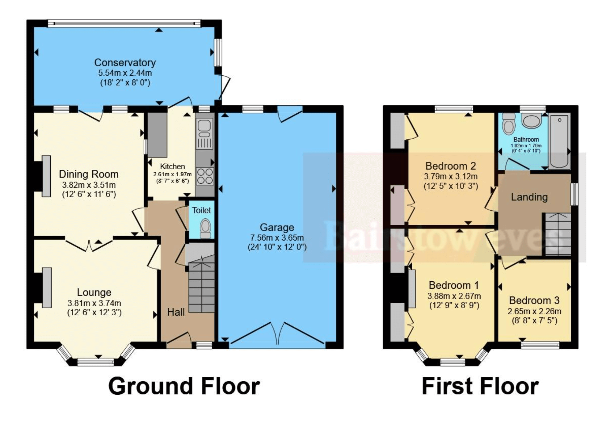

Current floor plan
35840583_Screenshot2022-01-17at11_39_00.thumb.png.56a3e4cb250c3235c03e5ebe611fa248.png

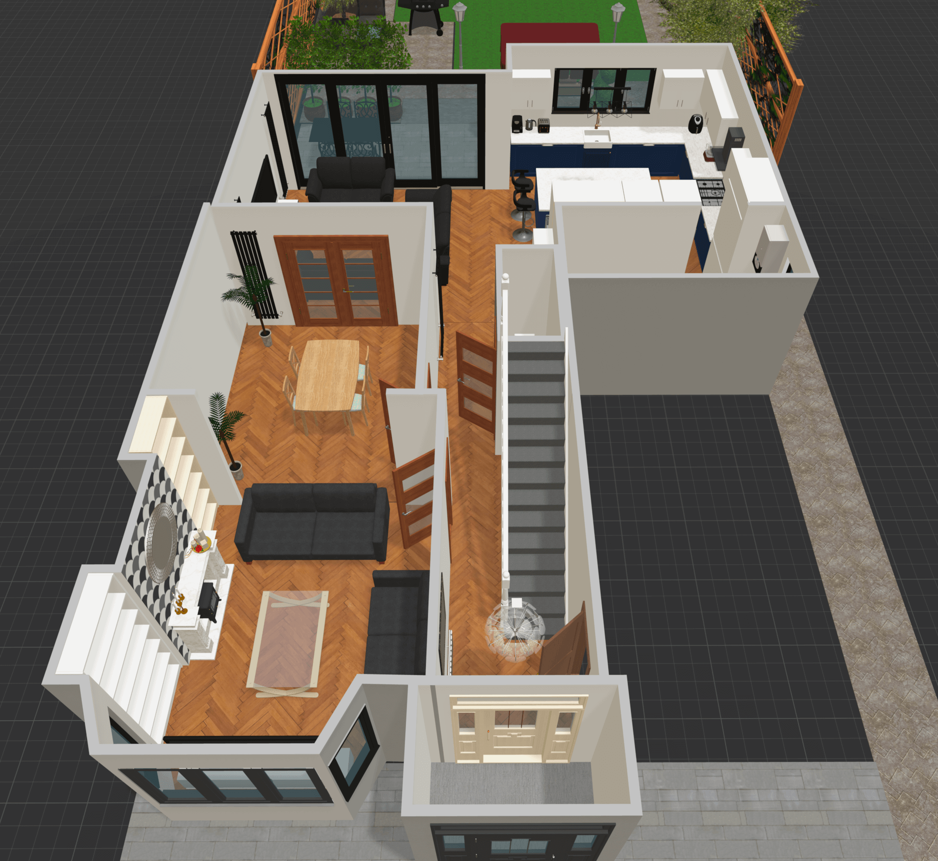

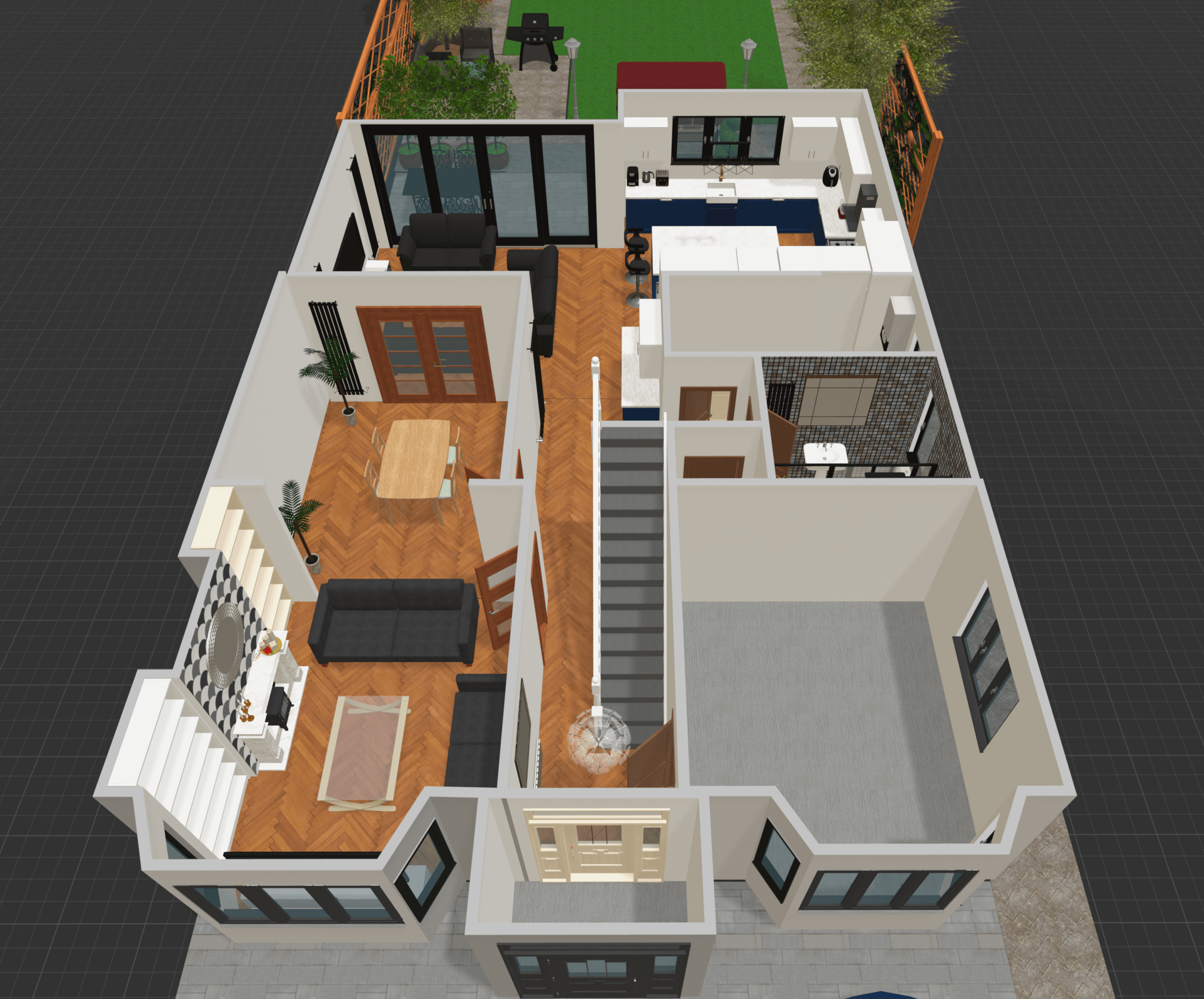

Proposed phase 1 ground and first floor
  • Refurb inside (new electrics, plastering, plumbing, boiler, floor, heating, doors, windows)
  • Knock down existing garage and leave empty (building foundations for future phase)
  • Rear extension approx 45m/sq (kitchen/diner + utility space)
1472352199_Screenshot2022-01-17at11_39_38.thumb.png.21fbbea51821849ce468103307f9a8e9.png
416373219_Screenshot2022-01-17at11_42_01.thumb.png.0dc67ca033c4eee617587305568e2f21.png

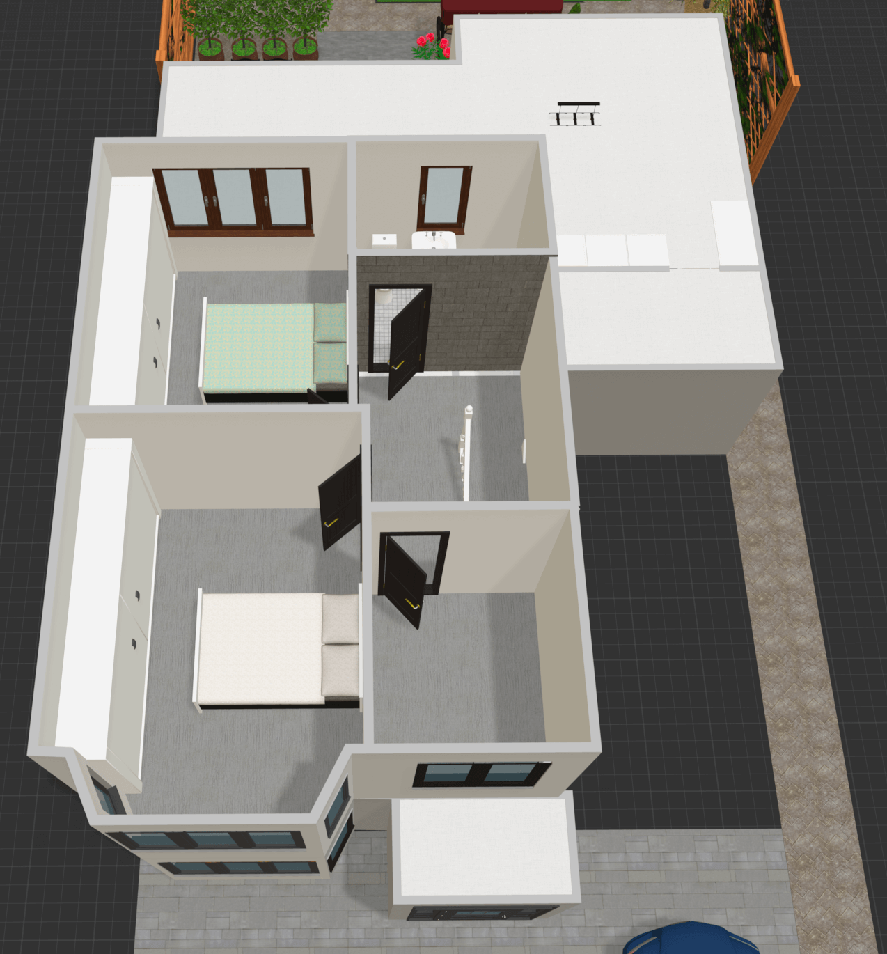

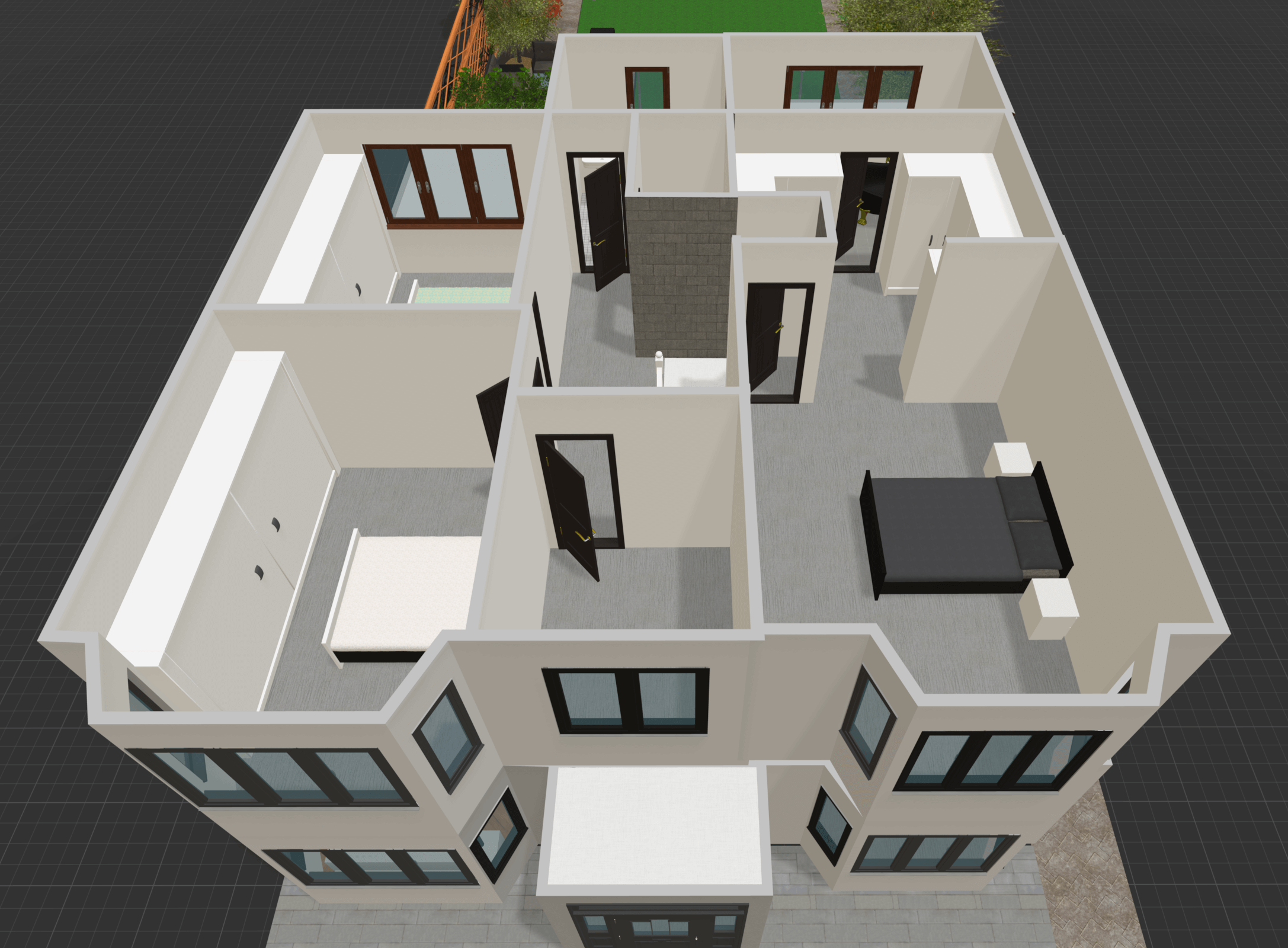

Proposed phase 2
  • Double side extension
  • Build over existing rear extension for part double rear
  • Loft - not part of design
1321758625_Screenshot2022-01-17at11_34_50.thumb.png.da6e1b51f103524a028c4eba1fc589c0.png
949342455_Screenshot2022-01-17at11_35_32.thumb.png.69f1e8a1a1d4bb76f243e8891bd6cf88.png
