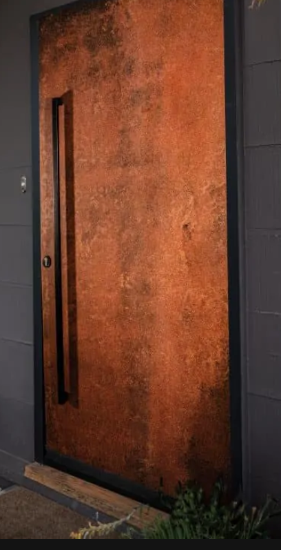

So we really really wanted a door like the pic below and a double garage door to match. The view of our house from the street is largely the garage and the house is built down a hill so looks fairly modest from the front so we wanted to hint at what lies behind the facade.
We can get the front door like the below image but getting the company to do panels to apply to either a sectional or up & over door is proving somewhat excessive on the budget! Especially as the garage door has to be industrial to take the weight! (note it is iron paint applied to wood not actual iron!)
So looking at other ways to achieve this and saw the video below from an Aussie company. Has anyone tried applying this kind of treatment to wood? I can get hold of Tricoya which is apparently the go-to base for this. May try and get some samples of the paint etc to see how it goes ? But would be good to hear if any artistic types have done something similar.

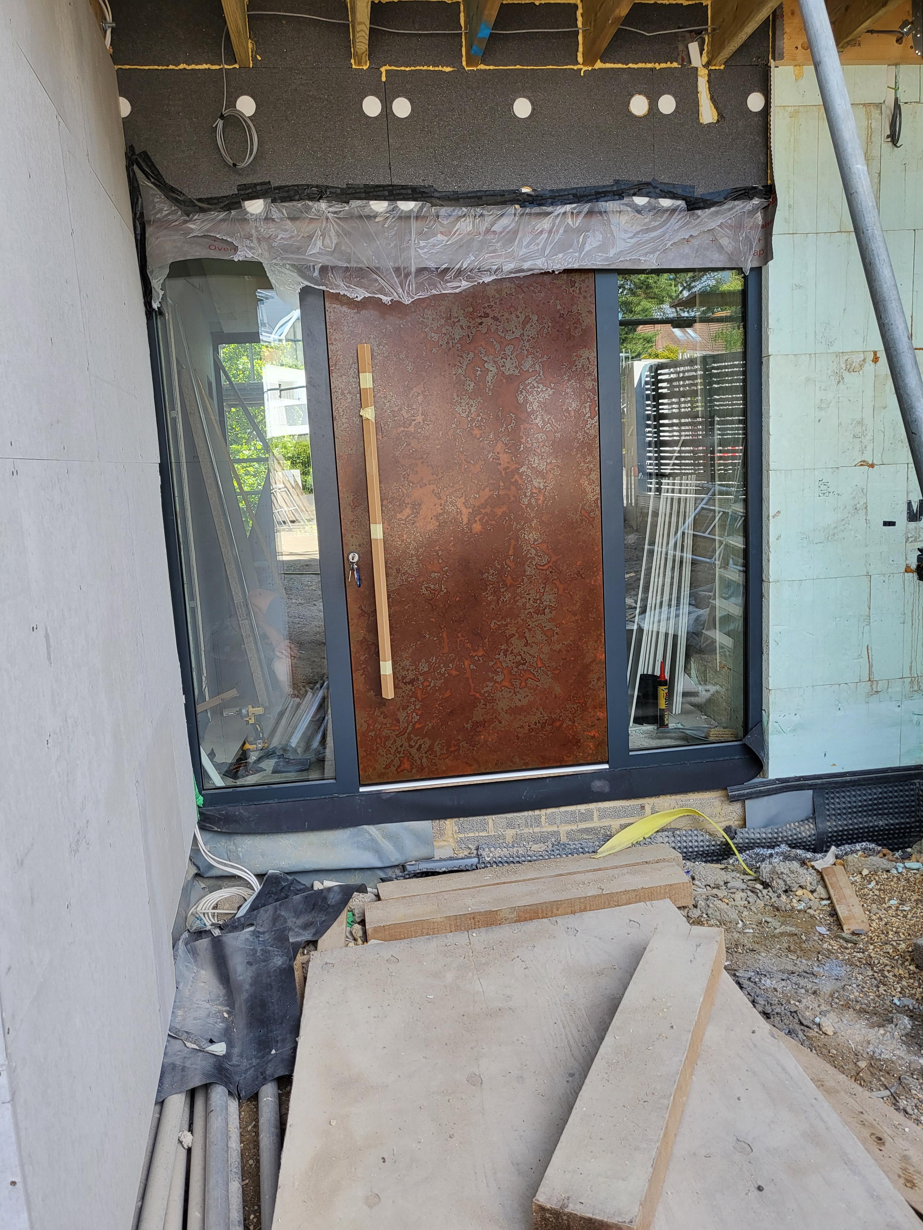

Hi, did you get your door from Camel Glass? It’s the only supplier we’ve found that does this. Thanks!
Hi yes we did and it's fantastic. I think my local joinery mentioned that a more local firm does this also but too late now.

On 12/09/2022 at 22:01, Adam2 said:
That looks absolutely fantastic! Is that and anthracite grey frame? We have that colour but single side light. What colour handle did you opt for. We’re in Suffolk so I don’t think we’ll conflict 😁

Hi Mark, I actually looked at your wife’s shop before posting. I didn’t realise she did doors too?
Hi - thanks, we're really pleased with it. Yes Anthracite frame to match glazing frames etc. Handle - ha ha I don't remember, it's still covered up will have a look to remind myself what we ordered
She doesn't make / post doors @janette
Too much heartache involved in ordering the doors themselves and you don't want to be the one to "sell the door" and therefore be the one to warrant all the door mechanisms etc.
If you had a door already (with a "weatherproof" painted finish already) she could probably key/prime this and apply the same kind of finish to it; which would be as durable as the varnish/lacquer applied over the top. Door would need to be demounted for this though as you can't work the finish vertically. Quite the faff to arrange during a build. Not so bad as an addon in spring/summer later though.
