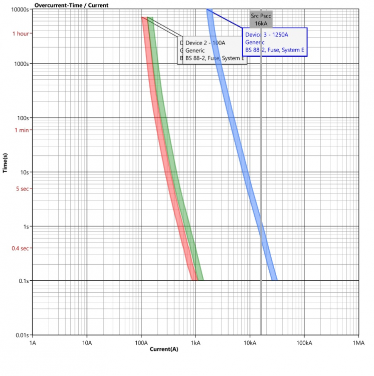

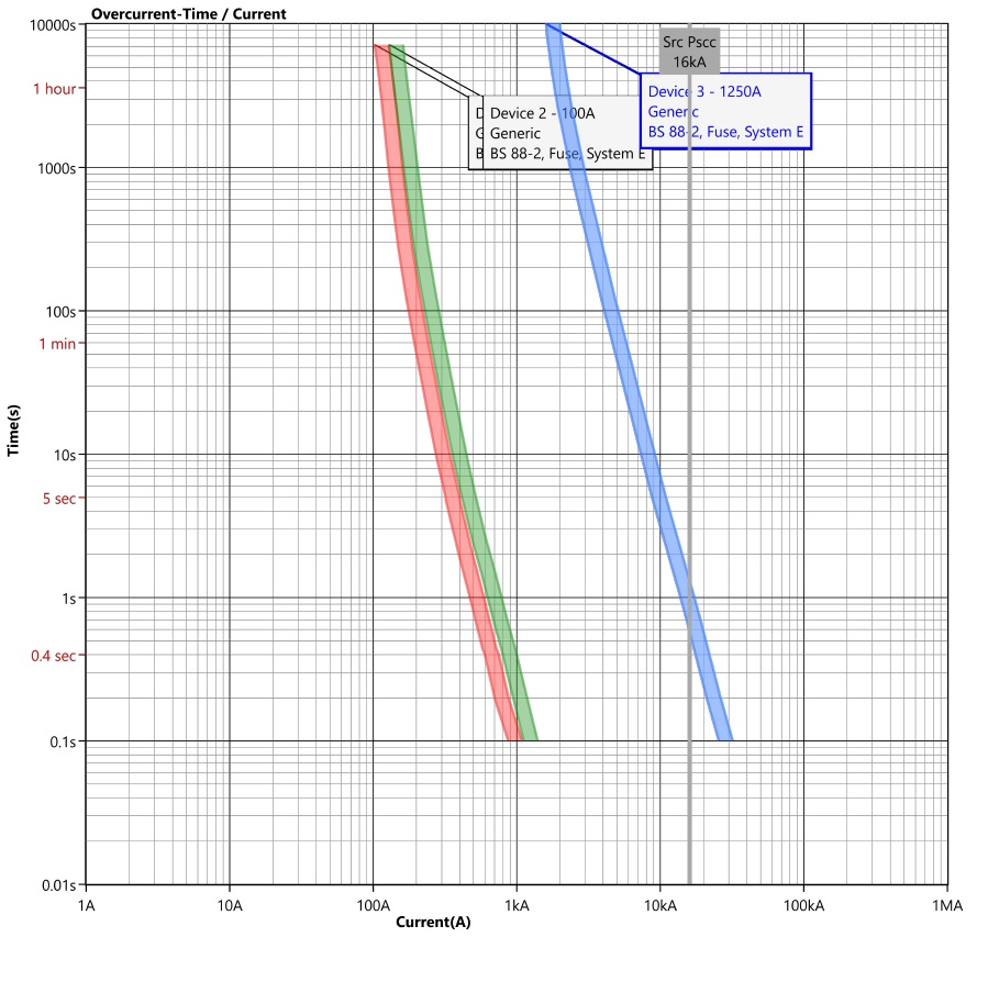

Pocster Posted January 13, 2022 Author Share Posted January 13, 2022 If you have an 80A fuse (modern wiring) is that sufficient to upgrade to 100A? - or does that require main inlet cable replaced? Link to comment Share on other sites More sharing options...
Carrerahill Posted January 13, 2022 Share Posted January 13, 2022 7 minutes ago, pocster said: If you have an 80A fuse (modern wiring) is that sufficient to upgrade to 100A? - or does that require main inlet cable replaced? It depends to be honest, but unless you are planning on sitting at high current for a long time you would probably be fine on an 80A even for 100A unless it was for days straight. You really only have a big issue after about 120A where even then you would get about 1000seconds before it goes. However, your main isolator would now be overloaded unless you happen to have a 125A - doubt it. So you need to be careful here, but the cut out and the cable are probably not going to be an issue for you, more your own electrical equipment. When they joint an LV lateral cable which runs from your cable head to the LV street network there is no protection at the joint, the local upstream protection will be at a substation outlet and could be 1250A or maybe 3000A, sometimes more in cities, so the cable might be jointed in the street and be say a 10m run of cable, so the BS88 fuse needs to sort of work in reverse to protect the lateral cable. Often in new builds I have spotted 80A BS88 but I suspect you could slip a 100A BS88 in no sweat, i.e. if the cable is 25mm, which will be concentric. It would be possible to draw about 150A for a limited time on the cable without any damage, it is all about current x time. Here is a quick protection study I did for an 80 (red) and a 100 (green) fuse and a 1250 (blue) upstream fuse - note that it would take over 1 hour at 100A really for both the 80 or 100 to trip - you will note that the 1250 would even allow 5000A to pass for about 100s. 1 Link to comment Share on other sites More sharing options...
Carrerahill Posted January 13, 2022 Share Posted January 13, 2022 (edited) 1 hour ago, pocster said: I decide to confuse myself more and use this... https://www.rapidtables.com/calc/electric/kW_to_Amp_Calculator.html I have an 80Amp fuse. A PW2 can draw at 5Kw. so 10Kw for 2. EV charger can draw at 7.5kw So sticking 17.5kw in = gives just under 73Amps I wonder how much 'room' they allow for normal house hold use on top of that? i.e. how near are you allowed to get to 80A.... Probably more like 77A as PF would not be 1. You are now beginning to see the issues that the network operators are having to contend with. There is a document called ESDD-02-012 which gives the SPEN ratings for supplies for various house types, for clarity this is not fuse size but supply rating, in other words how they work out how many supplies they can give from a given substation. A 5 bed property with gas heating is given as 2kVA - that is about 8.7A at 230V - that is what they are allowing. They used to give you 18kVA - but they realised that at that figure they didn't have enough capacity on the grid, so they just decided to drop the rating. This 2kVA is known as the After Diversity Max Demand. ADMD. They apply this city wide and sort of hope everyone is not charging EV's in the evening when they get home or making dinner... no wait... they are... why is no one talking about this? Oh, I remember because they are banning gas and petrol and diesel and the facts don't suit their narrative. Electric future... maybe in 2060 but not the next decade. They will start to make U-turns soon. Gas prices are only high because they want to use gas for electric generation as coal is too dirty, that is even before we all ditch petrol and diesel and gas domestically. Edited January 13, 2022 by Carrerahill 1 Link to comment Share on other sites More sharing options...
