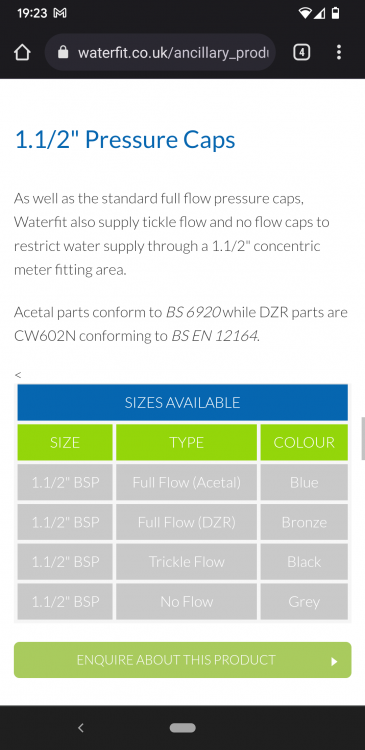

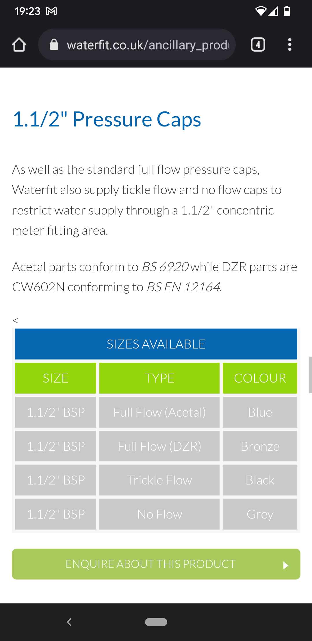

joe90 Posted January 10, 2022 Posted January 10, 2022 2 hours ago, patp said: They told us it would deliver a "trickle" until we are ready to go on the meter. Bah humbug, where is that written in their small print (plus no one here has come across this before!)
Conor Posted January 10, 2022 Posted January 10, 2022 As above, open the boundary box. If there is a red (blank) , grey or yellow (trickle) bung on top of the meter manifold, then you'll need to replace it with a standard white one. Eg. 1 1
patp Posted January 11, 2022 Author Posted January 11, 2022 Is this "legal"? During one long phone call one of them did say to "get your plumber to access the water supply". Husband is the plumber but has been retired for many years. No water meters in his day. As above he is very law abiding so will not tamper with the water meter if it is forbidden.
