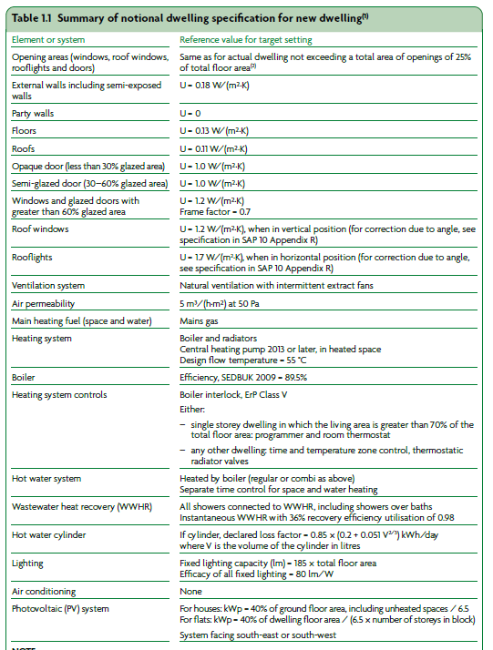

Andeh Posted December 31, 2021 Posted December 31, 2021 (edited) U value of 0.13 and 0.11 for flooring and ceilings, then 0.18 for walls seems a large step up from current which is nearly double some of these figures? Or am I reading it wrong? (page 12) Edited December 31, 2021 by Andehh 1

Andeh Posted December 31, 2021 Posted December 31, 2021 3 hours ago, Andehh said: U value of 0.13 and 0.11 for flooring and ceilings, then 0.18 for walls seems a large step up from current which is nearly double some of these figures? Or am I reading it wrong? (page 12) Sorry to bump my own comment, but im still trying to get my head around this? Have they really dropped the numbers by nearly half in some of these contexts? Vs current PART L values?

Marvin Posted December 31, 2021 Posted December 31, 2021 26 minutes ago, Andehh said: Sorry to bump my own comment, but im still trying to get my head around this? Have they really dropped the numbers by nearly half in some of these contexts? Vs current PART L values? The smaller the U-value the more thermal resistant.

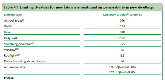

Mr Punter Posted December 31, 2021 Posted December 31, 2021 23 minutes ago, Andehh said: Sorry to bump my own comment, but im still trying to get my head around this? Have they really dropped the numbers by nearly half in some of these contexts? Vs current PART L values? The new standards v the 2016 ones are very similar. I think you are confusing the standards for the Notional Dwelling and the Limiting Standards, which are far more lax but can only be practically used for very small areas. 1
Andeh Posted December 31, 2021 Posted December 31, 2021 Thank you very much Mr Punter, that makes much more sense on a comparison point of view! Very grateful.
