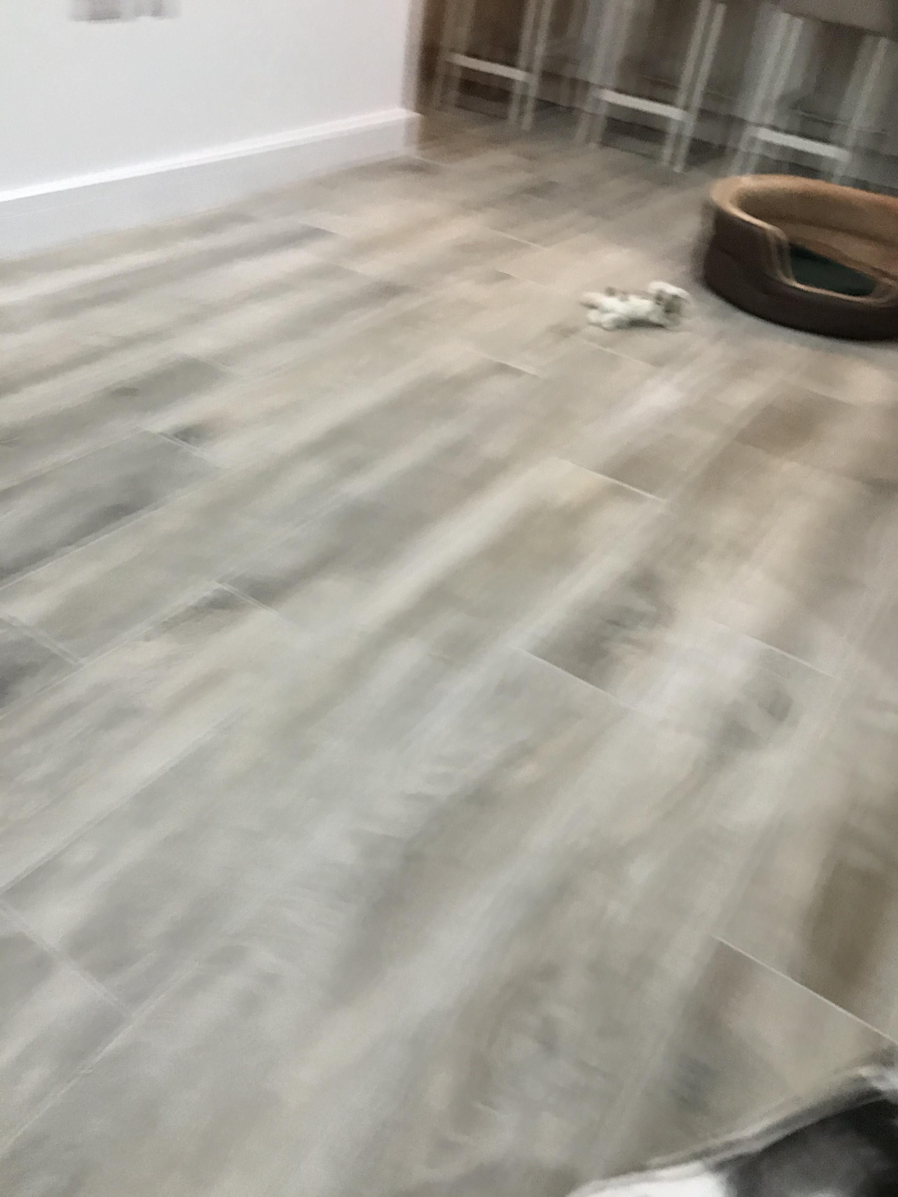

I laid Italian Porcelain slats on our build
Extremely hard wearing and works well with UFH
Most people think it wood
We plan to use the same or similar on the next one

I bright it in direct from The manufacturers
Via Rocia
