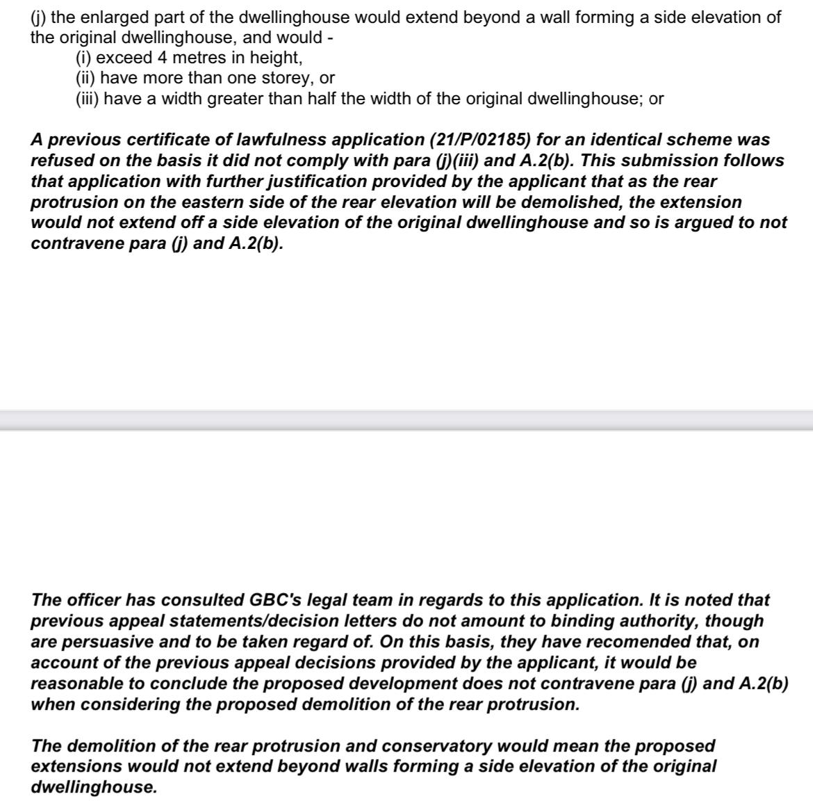

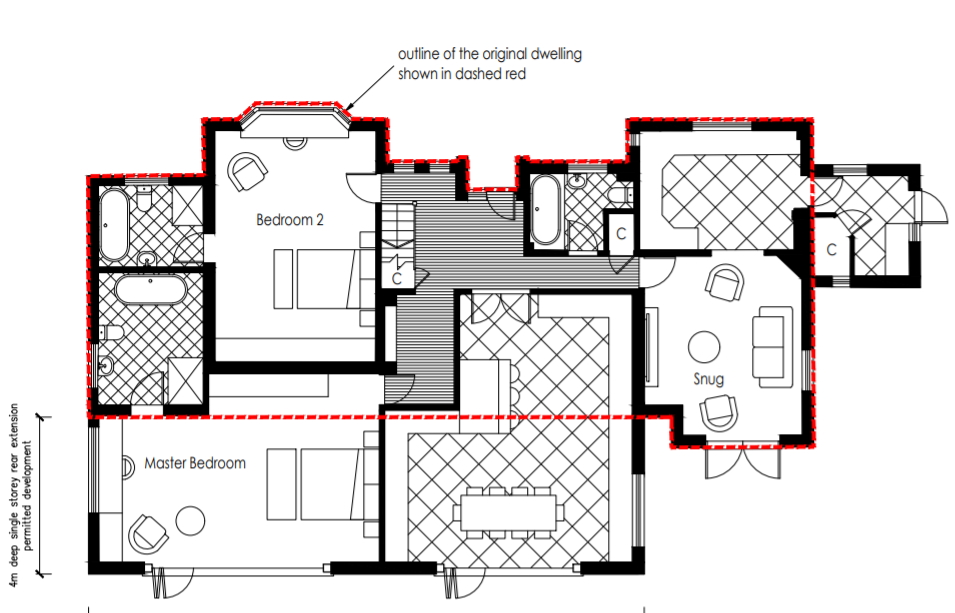

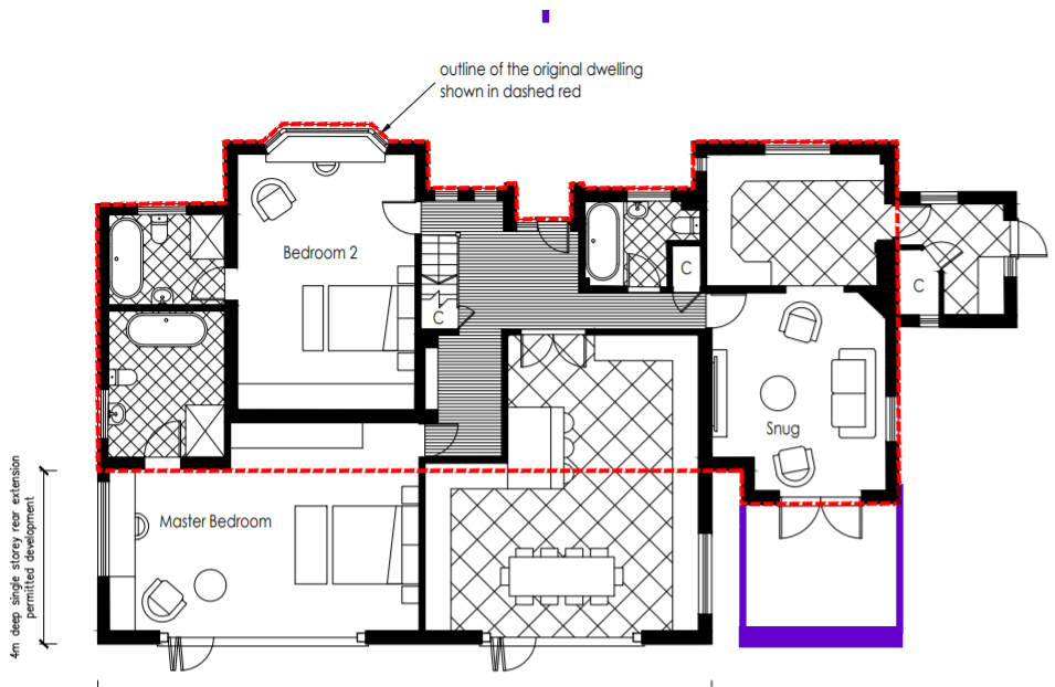

Gerhardt Posted February 22, 2022 Author Posted February 22, 2022 Baby steps.... but we now have three quarters of the back extension approved. As briefly touched on in a previous posts, this was ok to be more than half of the width of the house as we did not attach to the rear protrusion or "side wall" as it is defined by planning laws. We have two more applications awaiting approval, one for the same scheme that got refused but with additional justification citing planning previous planning appeals and a second for a 45sqm garden room. If the scheme is implemented we will end up something looking like below, existing conservatory attached to the rear protrusion is marked in blue - My understanding about the next steps is as follow, we will now submit a HH application trading the PD approved space and the conservatory to blend this all into one extension. We have already obtained planning for a 44% uplift on the first floor, how would the new application be assessed? We are happy to give up PD rights for this class of works but it is probably also worth noting that we intend to do a balcony on the back extension roof(we are completely screened off from neighbors), so wouldn't want do that if a balcony application requires that specific class of PD rights we give up. Any wisdom anyone can part with about a similar set up or previous experience would be greatly appreciated.
