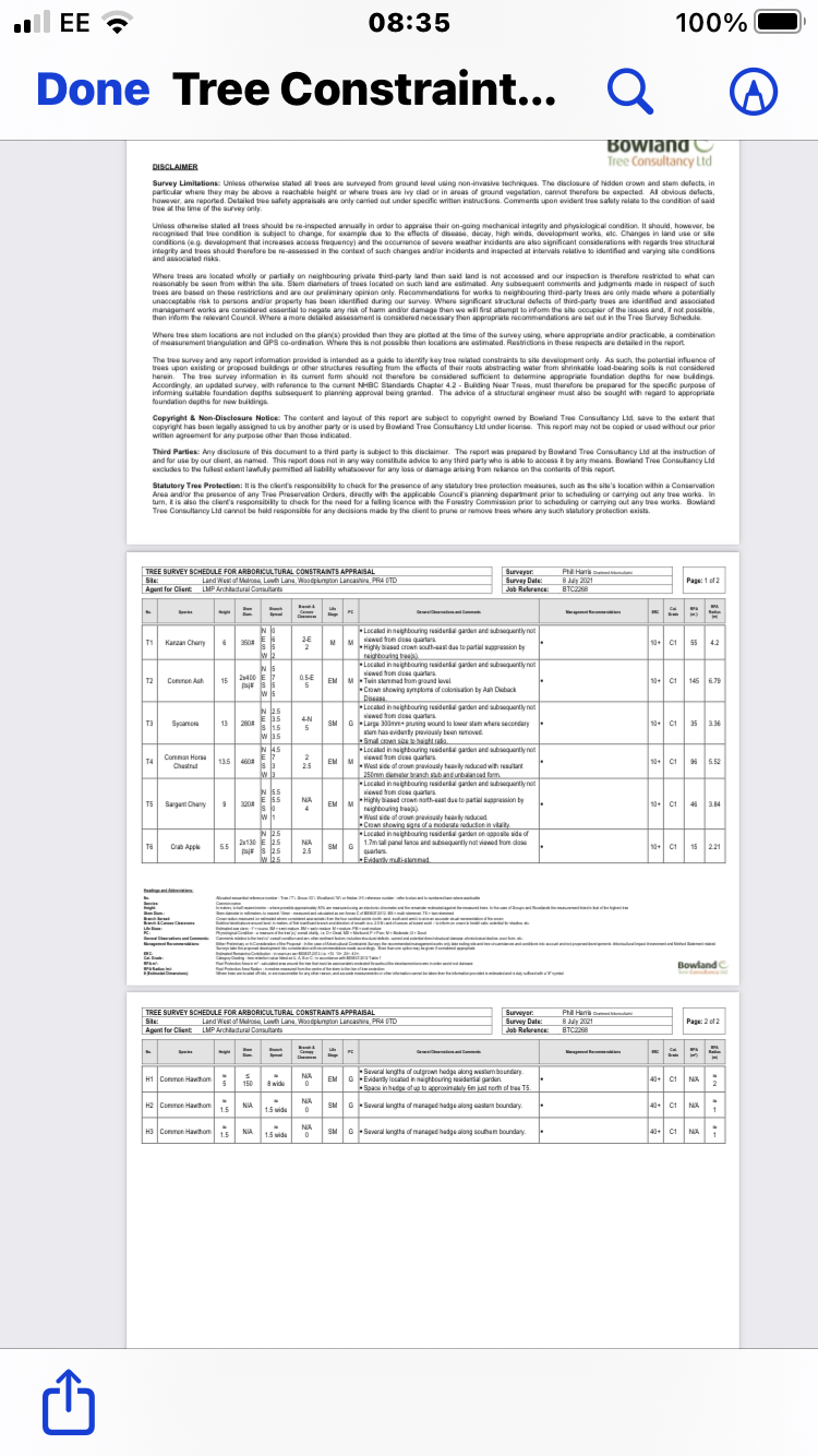

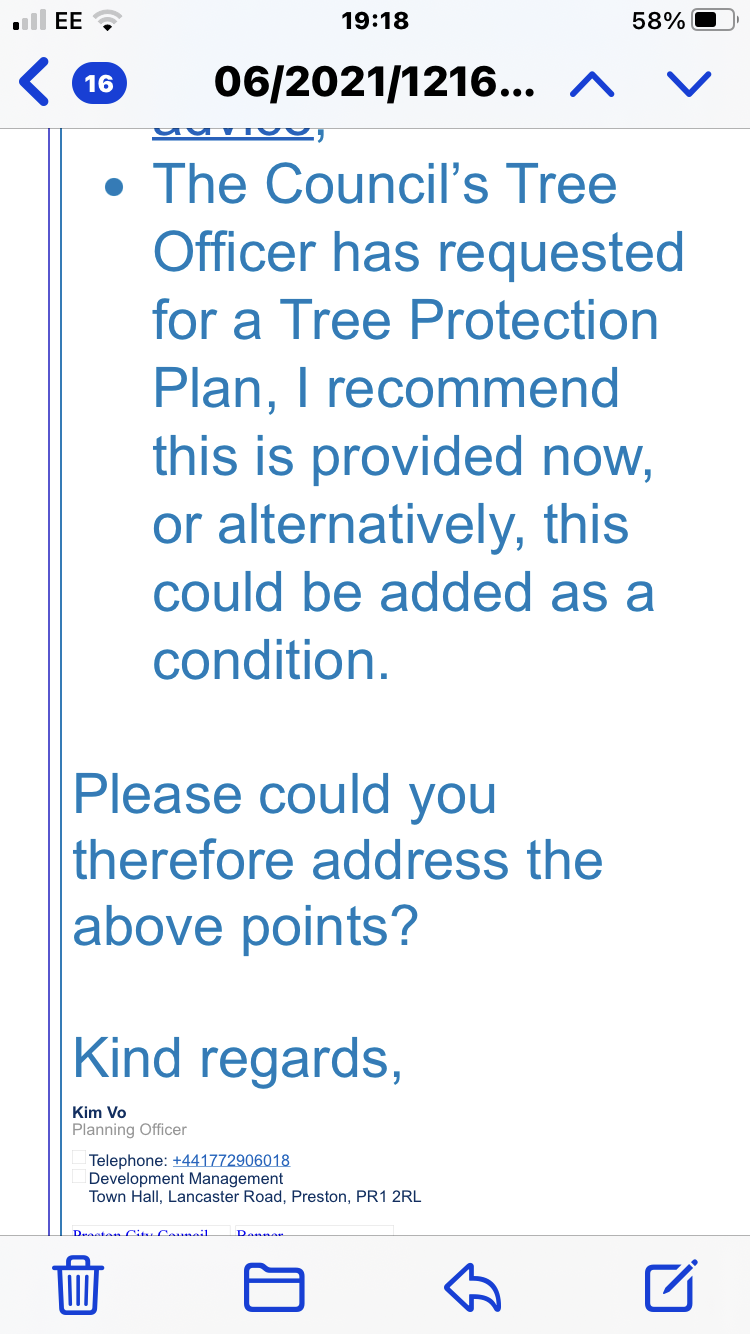

nod Posted December 18, 2021 Share Posted December 18, 2021 (edited) One of the final things that planners have requested is root protection plan There are four low value small trees about 6 metres from the side of the house We had submitted a full tree survey It does include sketches of how to protect these tree roots Ie Herras fencing with stays etc Ive contacted them tree survey company and they say that they will get a quote together on Monday Is this really necessary Or can I highlight what they have advised and agree to Corden the route area off I’ll include a copy of what they are asking in the hope that others have come across this We protected two large oak on our previous build with chapter 8 plastic barriers Edited December 18, 2021 by nod Link to comment Share on other sites More sharing options...
joe90 Posted December 18, 2021 Share Posted December 18, 2021 Our planners wanted a professional company to design our root protection zone but I simply contacted the councils own department for trees etc and gave them a plan showing 1meter high sheep fencing on posts around the area and they agreed that would suffice, I then told the planners their own in house “experts” agreed with my plan which gave them no ammunition to make me spend more money ? 1 Link to comment Share on other sites More sharing options...

BadgerBadger Posted December 19, 2021 Share Posted December 19, 2021 If you don't need to do any work in the root protection zones, I think you could comfortably do this yourself without a specialist. Work out the root protection zone diameter ( there's a standard based on multiplying trunk diameter) then mark it on the plans as an exclusion zone that will be fenced as you'd previously submitted. If you need to do stuff in that exclusion zone then it does get more complicated. 1 Link to comment Share on other sites More sharing options...
nod Posted December 19, 2021 Author Share Posted December 19, 2021 1 hour ago, BadgerBadger said: If you don't need to do any work in the root protection zones, I think you could comfortably do this yourself without a specialist. Work out the root protection zone diameter ( there's a standard based on multiplying trunk diameter) then mark it on the plans as an exclusion zone that will be fenced as you'd previously submitted. If you need to do stuff in that exclusion zone then it does get more complicated. The annoying thing is We have all the information from the tree survey and the Architect seems to think we need to pay again Link to comment Share on other sites More sharing options...
