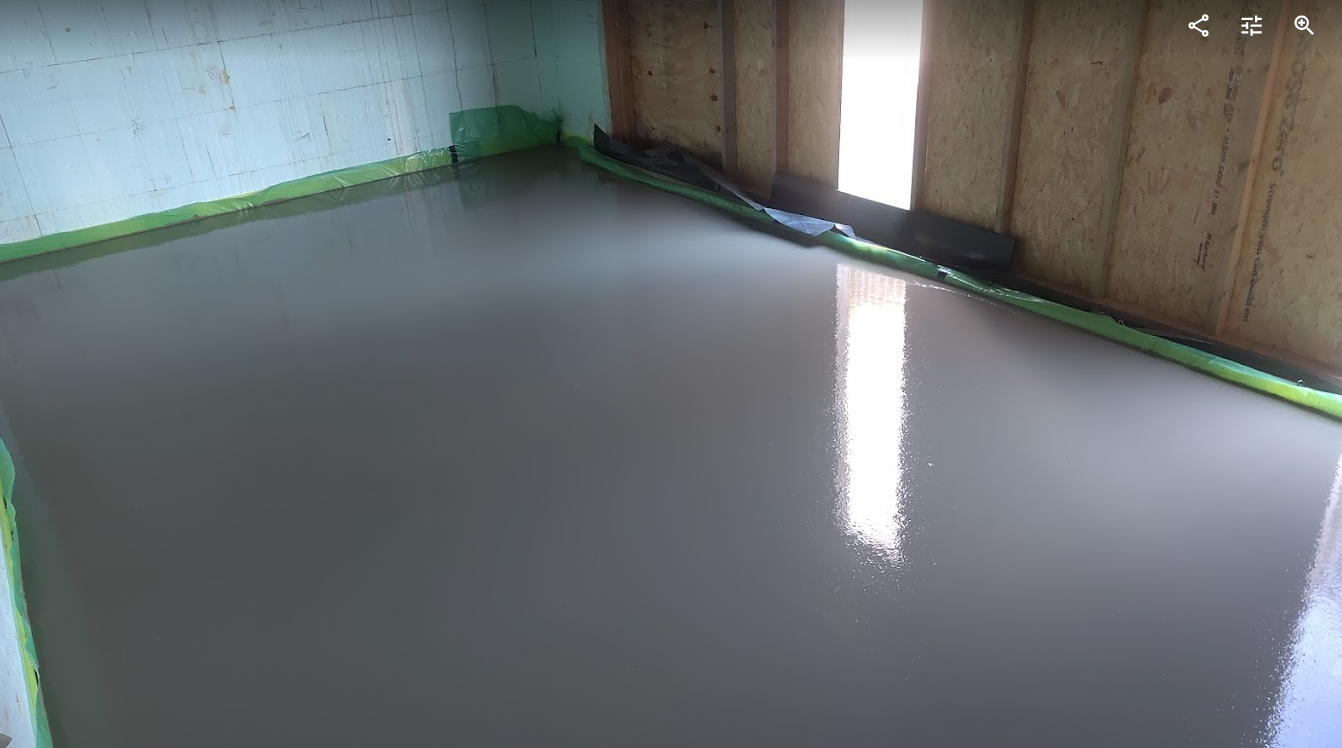

you may find that options will depend on local supplies, it was easier for me to get Longfloor - I was initialling looking at Cemfloor. The installer says Longfloor is what they mainly used as plant was only 20 mins away whereas Cemfloor was 1.5hr and they preferred less time in transit. Outcome is pretty good - couple of minor cracks - we poured about 16m3. Regarding cracks, they will use crack inducers but generally not as they usually result in some lipping at the inducer location apparently. They will come back and inspect in a few weeks and fill anything over 2mm. Depth wise - on my concrete slab bases we went with 50mm/55mm as they were pretty true. On the upper floors with precast planks I thought we should go with 65mm to be sure of pipe cover BUT in fact we used dried sand under the insulation (25mm) to ensure no voids which meant the insulation was very flat so could have gone with less. Longfloor & Cemfloor both being cementious screeds. On our pour day we had the bonus of the plant boss + the longfloor rep being there to do some videos - if this wasn't done right it never will be!
Thanks - looks very good. We've a Cemfloor supplier about half an hour away and I've asked for a quote.
