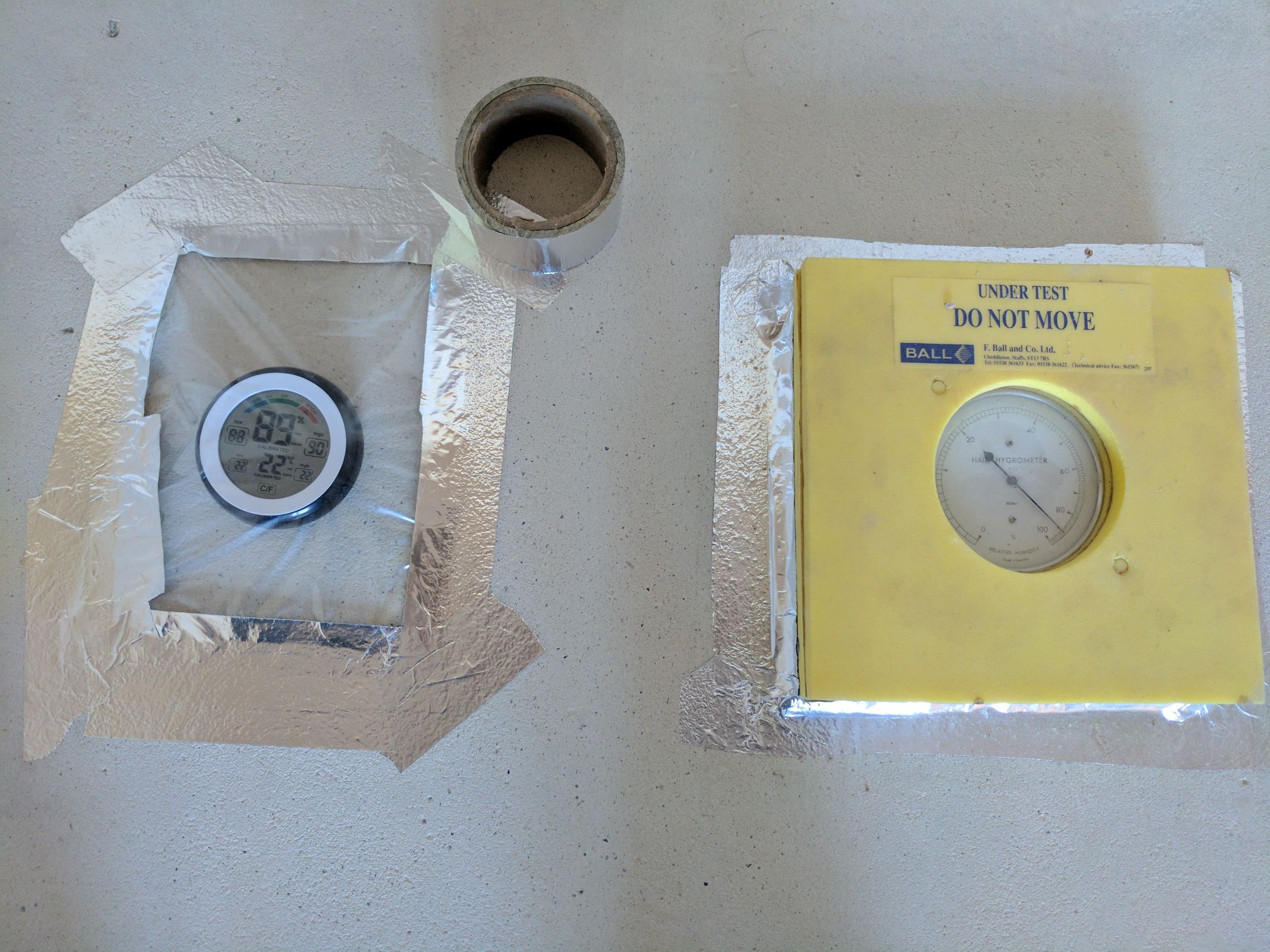

readiescards Posted April 20, 2017 Share Posted April 20, 2017 Any recommendations for a suitable tool/device to purchase to monitor my ufh screed dryness? Thanks Paul Link to comment Share on other sites More sharing options...
ragg987 Posted April 20, 2017 Share Posted April 20, 2017 I used one of these which I purchased off eBay, though mine was an older model with an analog dial and not a digital display (no batteries required!) http://www.merlinlazer.com/Hygrohood-Relative-Humidity-Floor-Box I probably still have it around, so if interested we can do a deal. 1 Link to comment Share on other sites More sharing options...
readiescards Posted June 1, 2017 Author Share Posted June 1, 2017 Thanks @ragg987 meter working great :-) As a comparison I seal a calibrated (or so it says on box) cheap digital temperature and humidity meter in a plastic bag - gave approx the same reading: 1 Link to comment Share on other sites More sharing options...
ProDave Posted June 1, 2017 Share Posted June 1, 2017 What guys do up here is simply tape a bit of clear plastic over the floor. If you see any moisture under it, it's too wet to lay the flooring. 1 Link to comment Share on other sites More sharing options...
