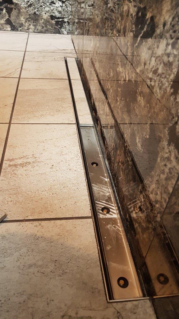

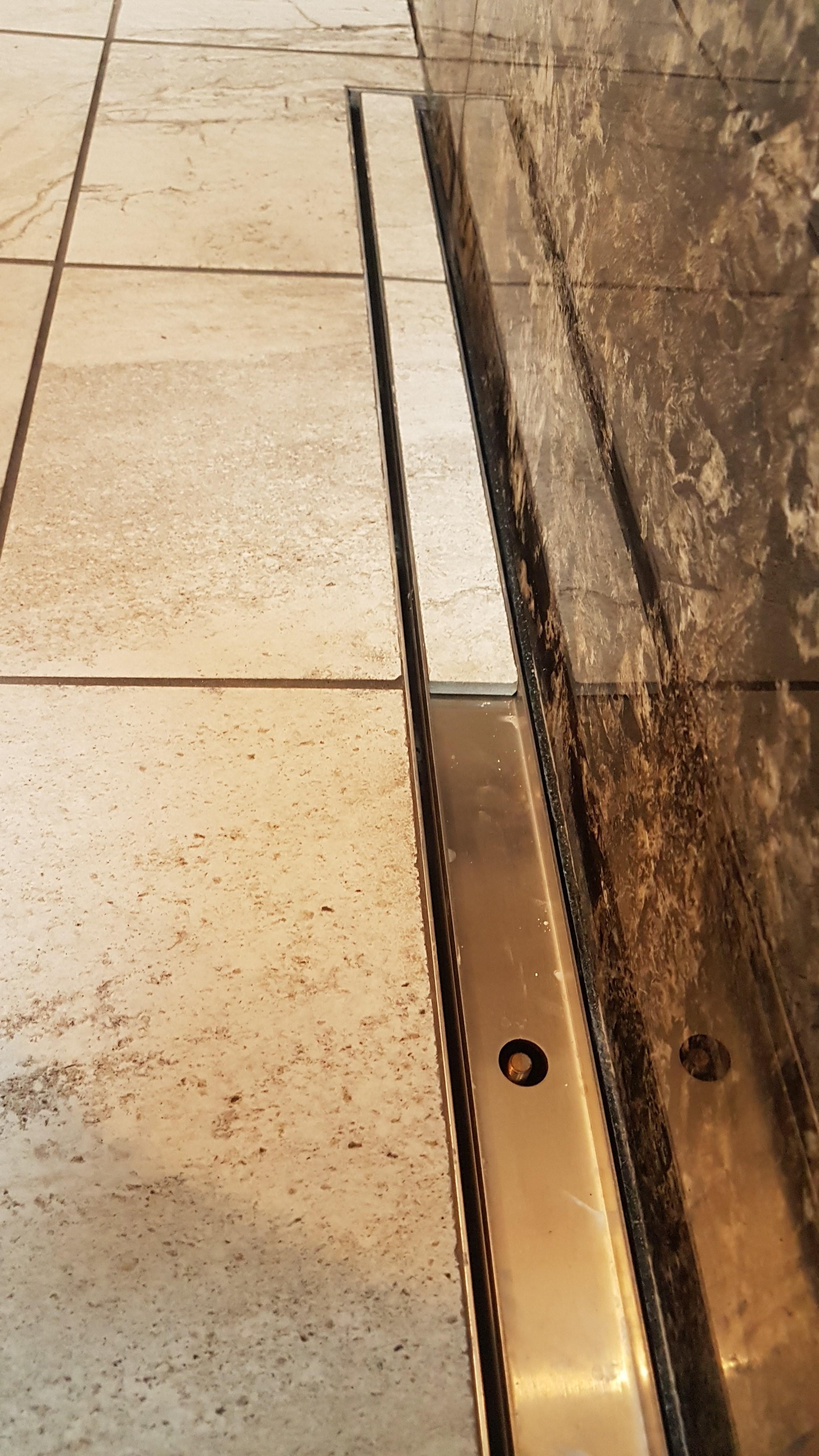

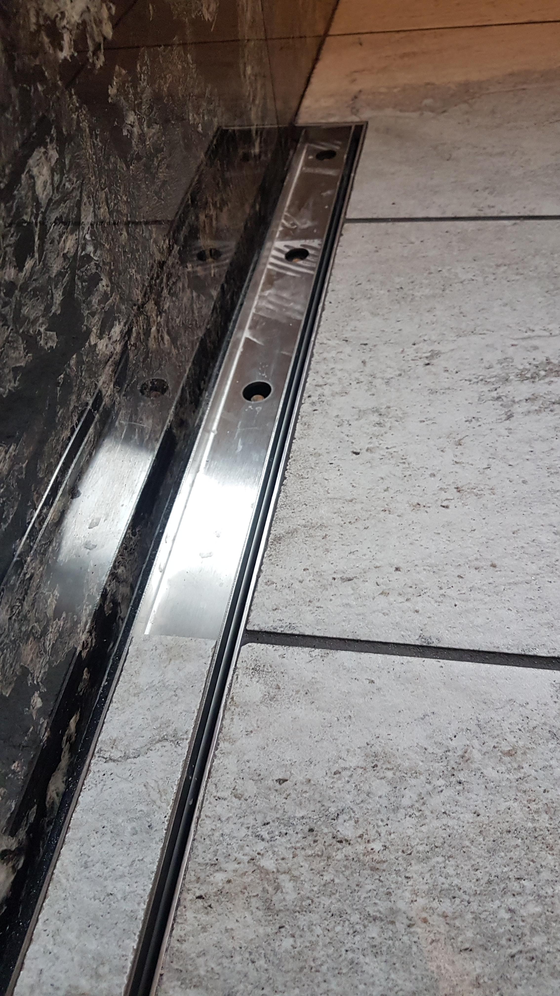

7 hours ago, Onoff said:
That's just a trap cover???
no, it's a tileable drain. I've taken some pics so you can see how the tiles need to go ;)
6 hours ago, tonyshouse said:
Better to design fail safe than to rely on sealants, even good sealants.
The CT1 would be to stick the tiles in, doesn't really need to create a seal as the water drains around it

On 15/12/2021 at 17:06, Russell griffiths said:
I would ct1 it, but full bed with no voids so the tile cannot snap.
Thanks Russell, went with your suggestion and it only needed a thin spread of CT1, so should work well.
