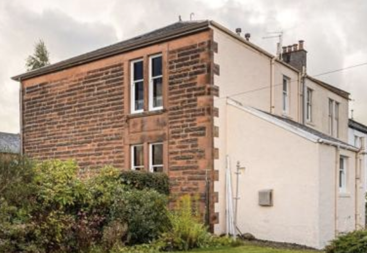

I am thinking to perhaps externally insulate the rear wall, which already has some sort of rendered finish.

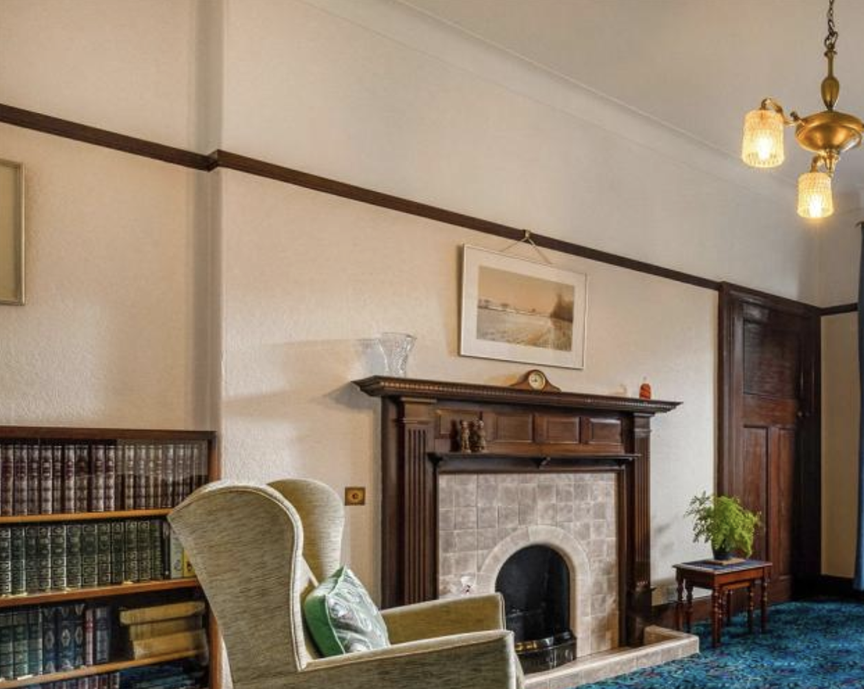

However, I doubt I can externally insulate the sandstone on the rest of the building so am hoping to add some internal wall insulation. The side of the building has old (unused) chimney flues as shown in the pictures. Don't be thrown off by the door in the interior picture - this is the exterior wall behind there ?

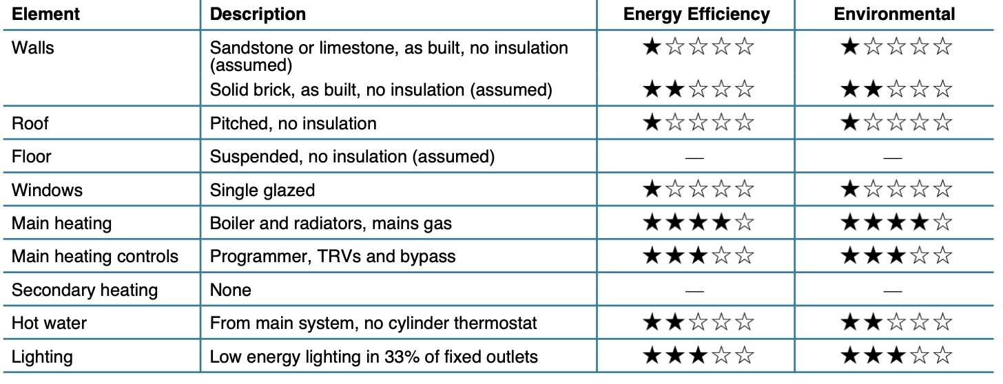

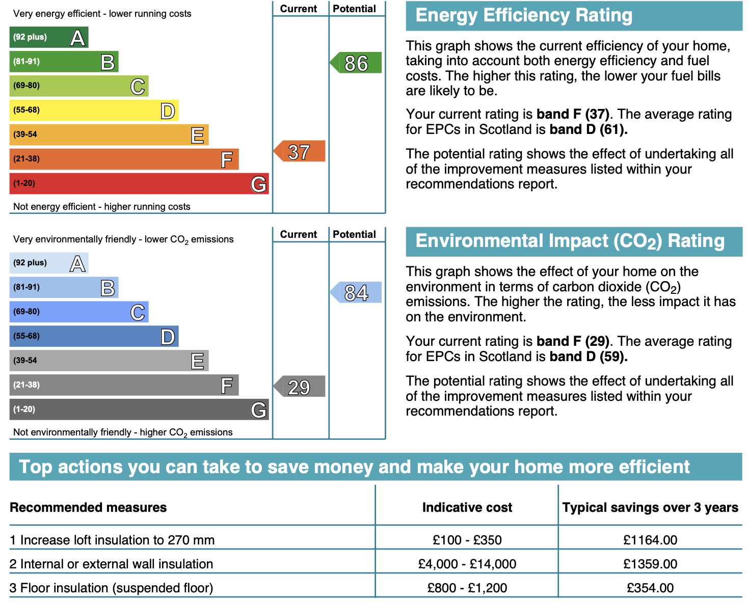

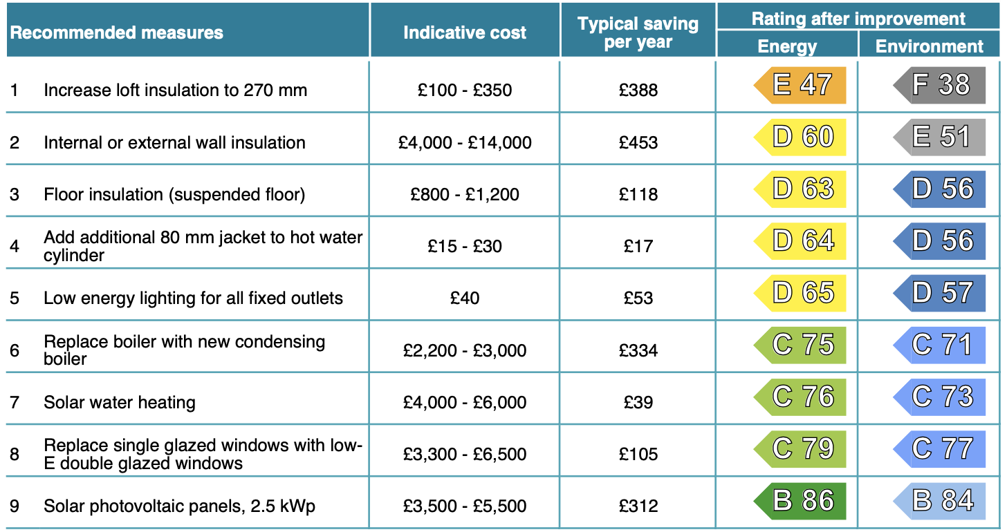

Attaching excerpts from the EPC if this at all useful for context.
