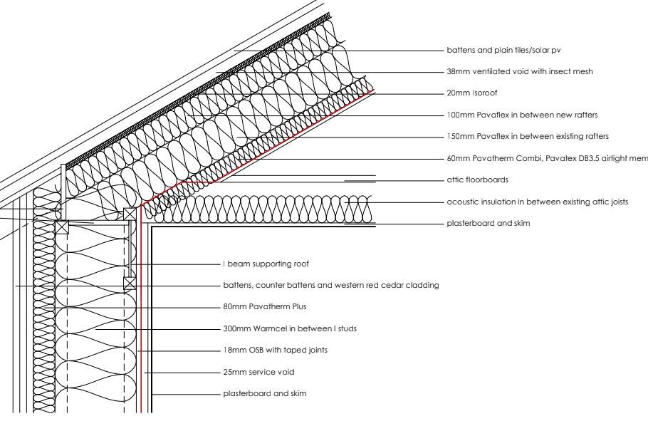

Here's our retrofit build up

I have just done a quick and dirty sketch of what I was talking about if that helps make things a bit clearer. There is also a room in the roof conversion, which has approx 100mm fibreglass insulation all around it. I am also planning on replacing this.
@joth Does this help at all?
 @AliG I have plenty of height on the ceilings so I will add the extra 50mm below the rafters. Between the walls and first floor ceiling I was only really hoping to deaden the sound transfer not too worried about heat transfer between the rooms upstairs. And yes I totally agree there are a lot of things that seem like extra hassle that I hadnt considered doing before I started but as you say it makes complete sense to do these other jobs now while I have a blank canvas, this will be my house im not just flipping it so I want to everything right and to the best standard that I can. Do it once, do it right as they say!
