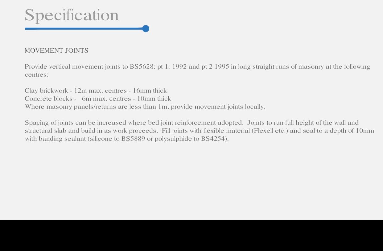

James94 Posted November 12, 2021 Posted November 12, 2021 (edited) I’m not sure if every build is different, maybe depending on materials? But this was ours specified by our architect. James Edited November 12, 2021 by James94

Barryscotland Posted September 15, 2023 Author Posted September 15, 2023 On 31/08/2023 at 21:17, MarkW1979 said: Hi Barry, Maybe we have the same Structural Engineer. I'm in a similar position - exactly the same wording on approved building warrant plans - how did you get on with your approach? Cheers, Mark We ended up just going with where the brickey recommended, building control never looked twice at them when he was out. He did check we had weep vents in all needed locations. Think as long as you don't go over the max distances in the guidelines you be fine.
