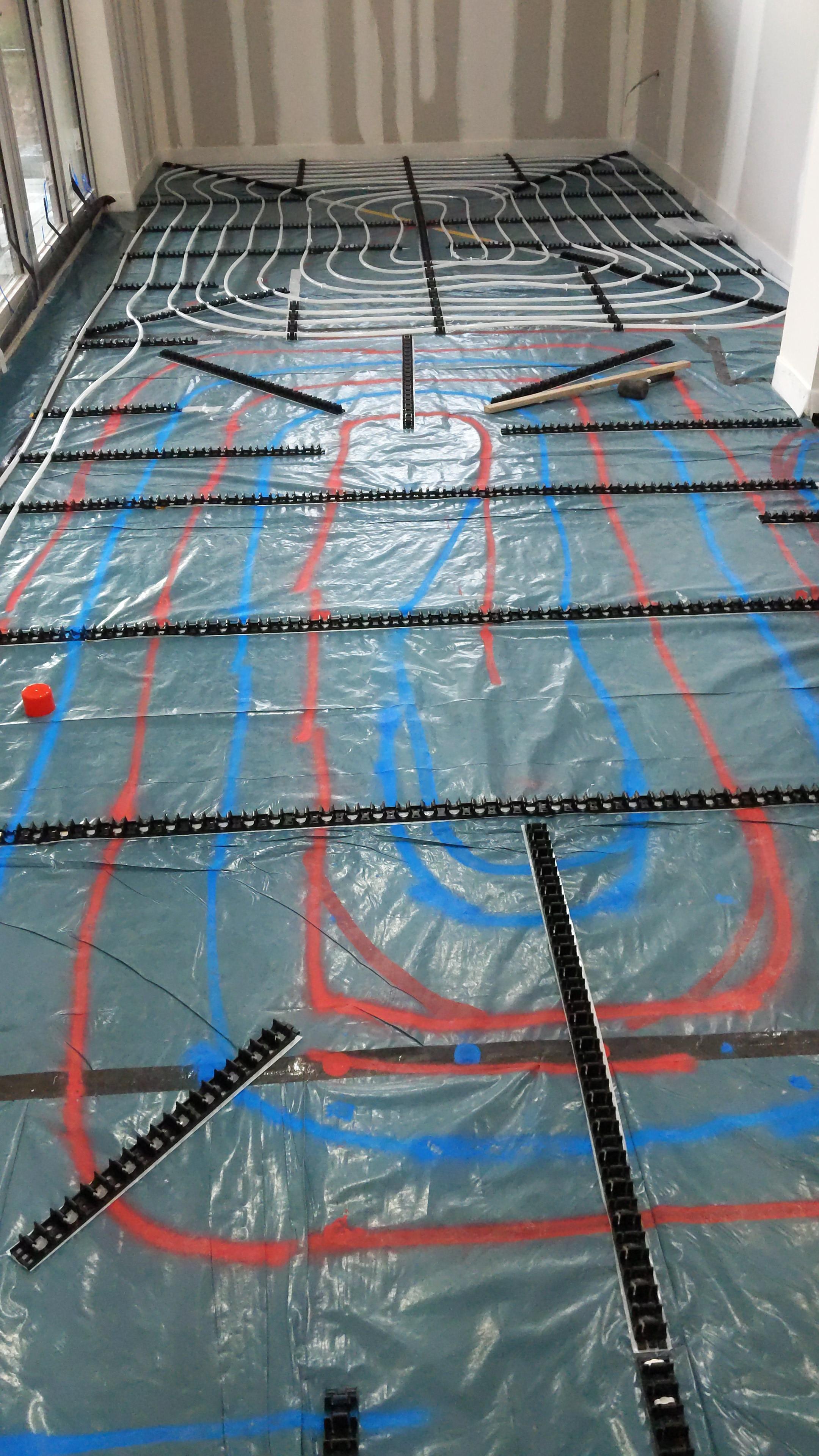

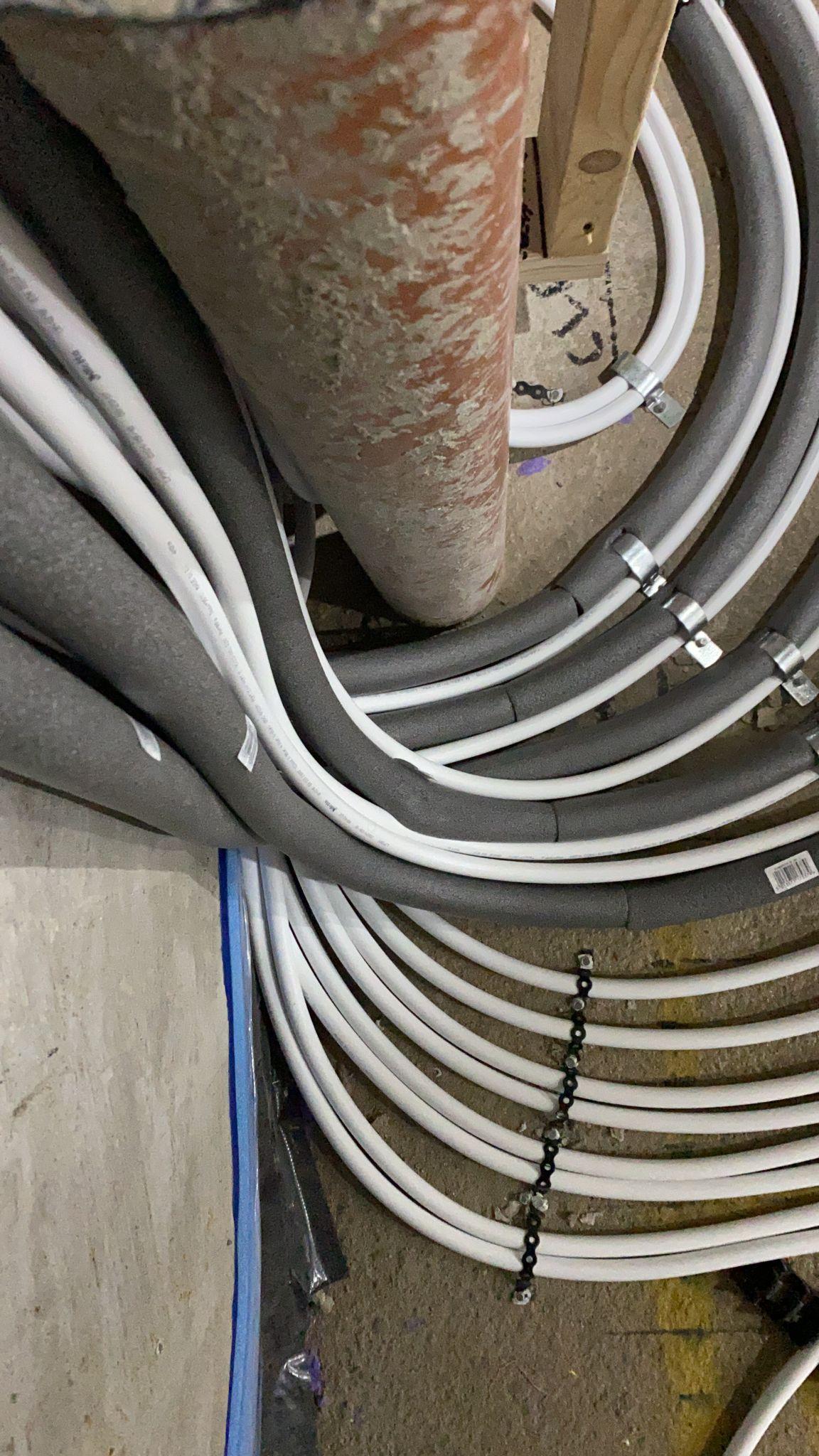

Nickfromwales Posted November 12, 2021 Share Posted November 12, 2021 I bought a Spit Pulsa 40e gas nailer ( concrete and steel fixings ) for £499 and it paid for itself with this one job. All those rails and metal P clips for here and there fixed down with 25mm concrete nails. 1 Link to comment Share on other sites More sharing options...
Conor Posted November 12, 2021 Author Share Posted November 12, 2021 Work of art. Link to comment Share on other sites More sharing options...
Nickfromwales Posted November 12, 2021 Share Posted November 12, 2021 6 hours ago, Conor said: Work of art. 2 days with marker pens, then line marker paint, and more head-scratching than the pics show. That one was "measure 6 times, cut once" and I still had to 'improvise' with a few of the tricky areas. So you know, I literally painted a 100x100mm grid onto the floor in each room, in yellow paint, and then painted the actual pipe runs on with red / white / blue as the lines to follow when affixing the clip rails and laying. Anything less would have resulted in "work of art" being "looks like shart" A lot of hard work, head work, and time to get that down I assure you. Link to comment Share on other sites More sharing options...

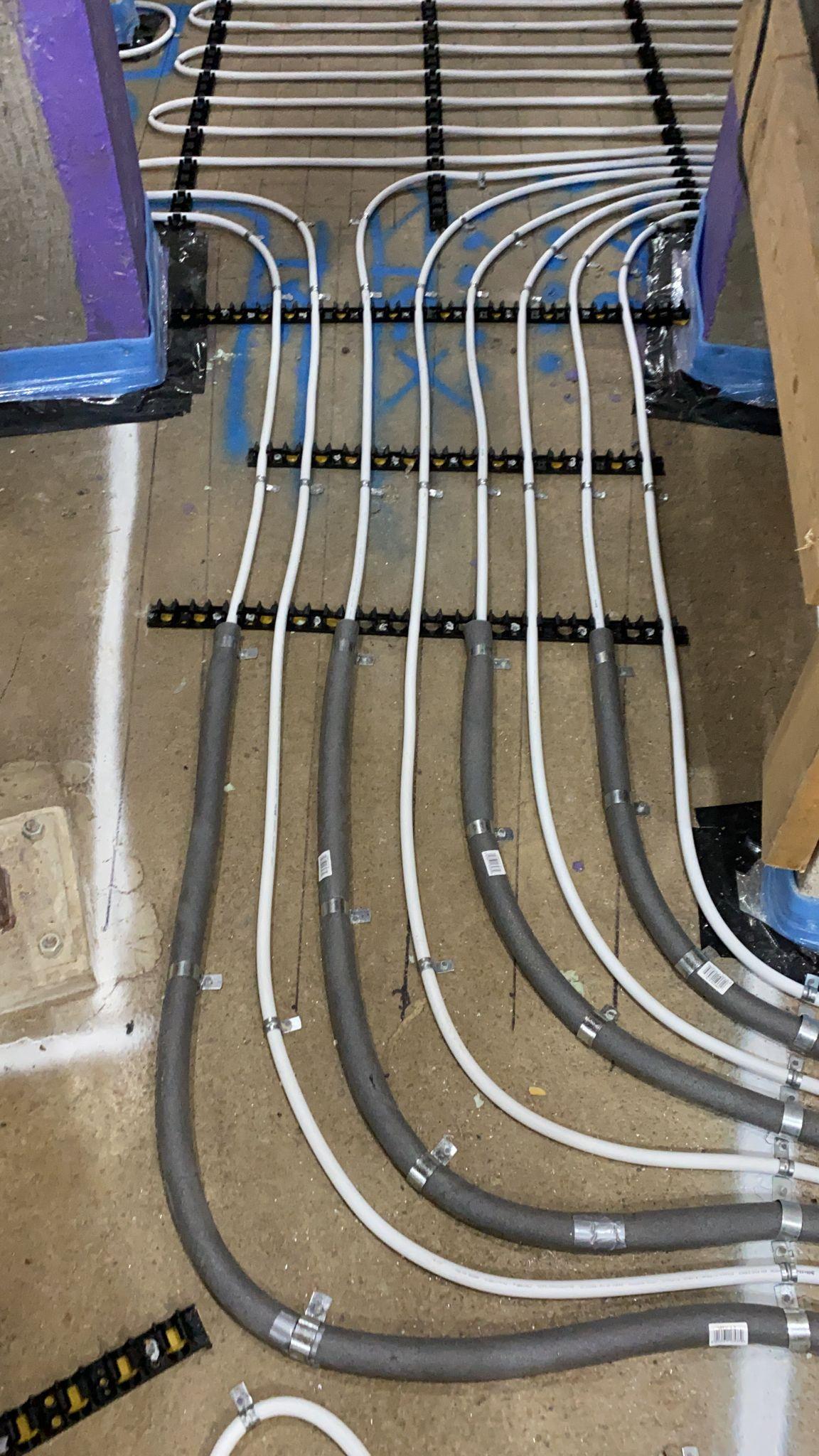

Nickfromwales Posted November 12, 2021 Share Posted November 12, 2021 (edited) 9 minutes ago, Mr Punter said: I don't like the way you end up with loads of pipes close together on the home run in ufh layouts. With PH it’s very much academic to look at ‘hot-spots’ as the flow temps and room temps delta are ridiculously close together, but even with my current job which will smash PH I still had to follow my heart and isolate the longest runs ( with Insulaton ) to preserve the temps at point of origin to the rooms / zones that it was to service. For clarity, Flow pipes only were insulated. Edited November 12, 2021 by Nickfromwales Link to comment Share on other sites More sharing options...

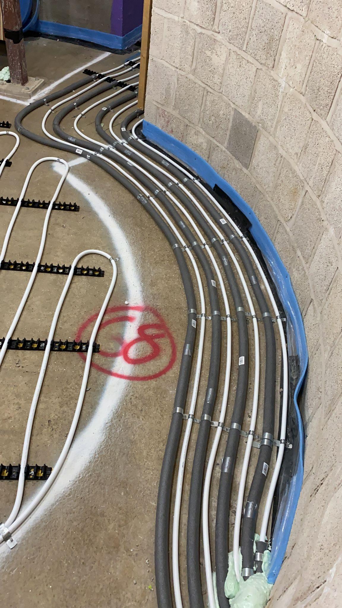

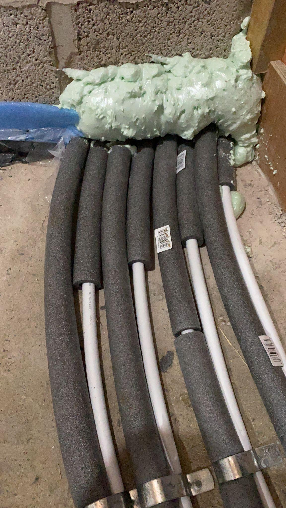

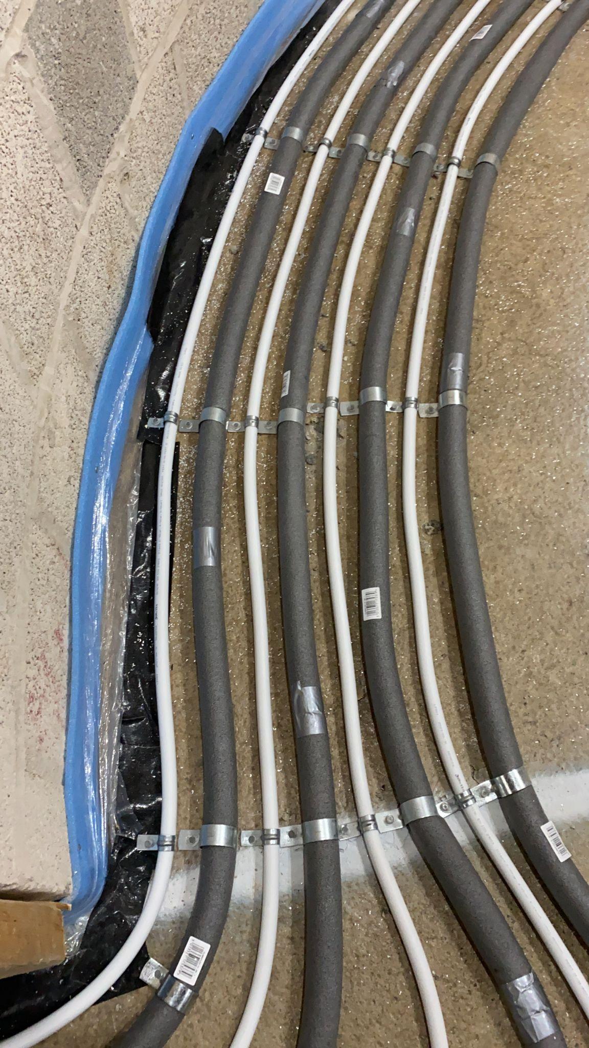

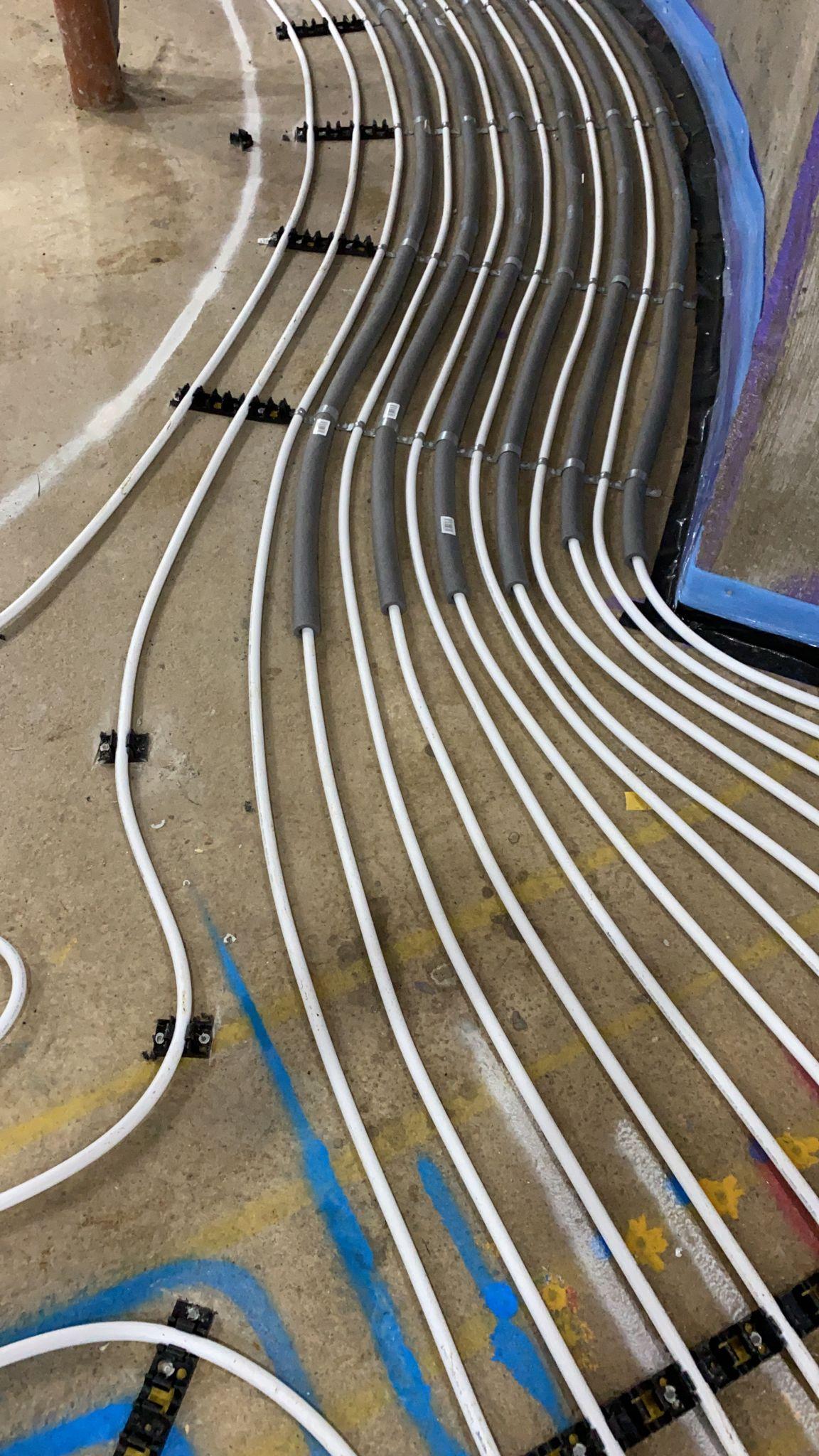

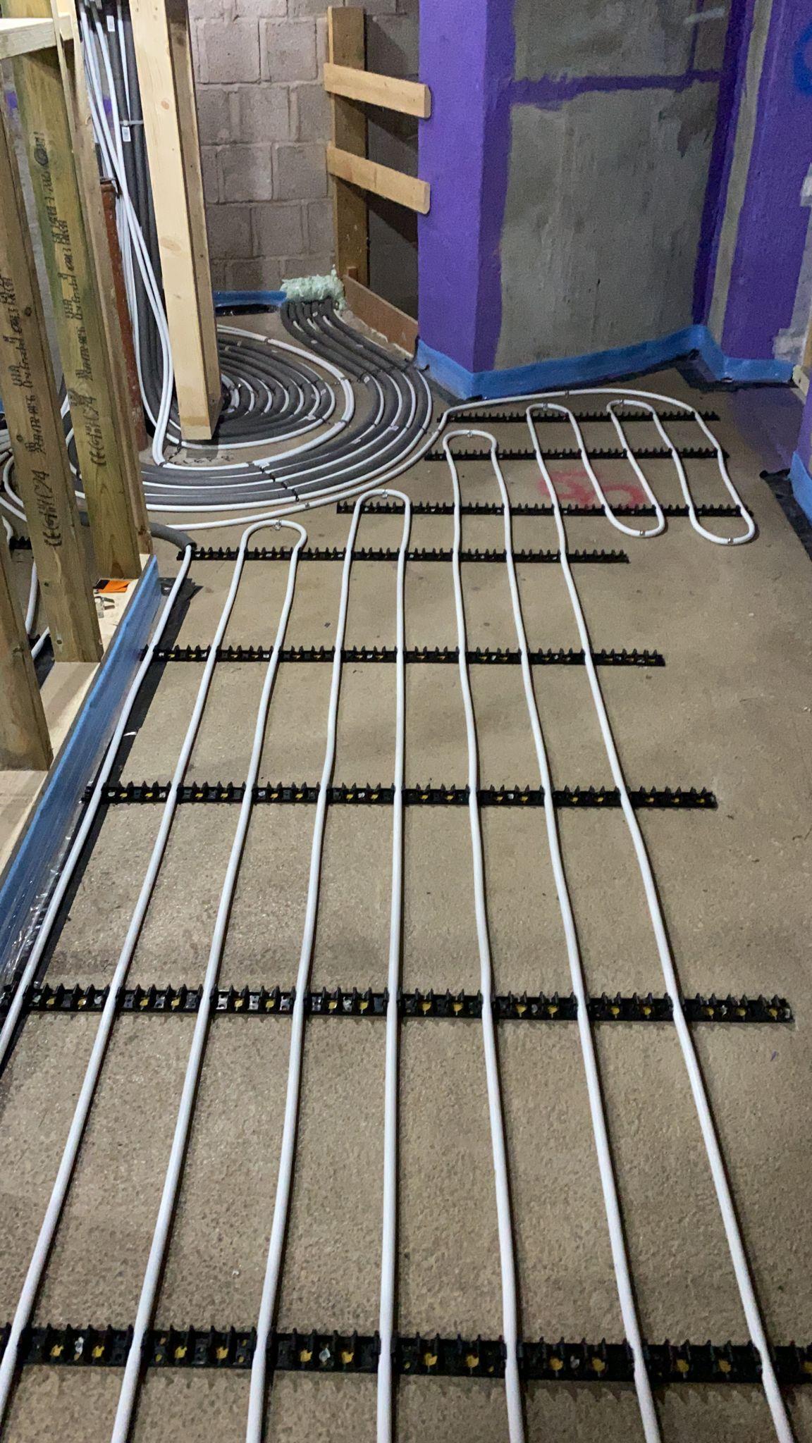

Conor Posted November 22, 2021 Author Share Posted November 22, 2021 (edited) Not nearly as neat as @Nickfromwales work but we're getting there. Plumber has already told me off for not going close enough to the bi-folds ?♂️ How important is it to insulate the flow pipes out of the manifold? And for how long? I've 4 flow and 4 return going through the one doorway and narrow route through the kitchen. We've only 40/50mm of liquid screed so I'm not sure we've the depth for insualtion. Flexible conduit? Edited November 22, 2021 by Conor 1 Link to comment Share on other sites More sharing options...
Nickfromwales Posted November 22, 2021 Share Posted November 22, 2021 4 minutes ago, Conor said: Plumber has already told me off for not going close enough to the bi-folds Actually you are spot on to leave a perimeter there, and I don't run into the openings either as that's the 'coldest' part of the floor in terms of difference in the cold from the sliders and junction with the outside walls vs the heated slab / screed. The amount of time you'll be stood barefoot on the "cold" 100mm of floor you've not piped = never. That one can go into the 'chill out' folder Makes it a lot easier to lay out with a few markings on the floor for ongoing sanity!! Top job With 40-50mm of screed, you wont be insulating any of it. I mostly do that where we are employing slab cooling for a client, vs no 'real-world' need when heating only, so don'y beat yourself up over that. Just be sure, very sure, that your pipework cannot lift ( float ) upwards when the pour goes ahead. With 40mm as the least amount you'll want zero movement from the pipe. Looks like you've got that covered TBH as you've gone on about the same gaps as I do, eg belt n braces. Tres bien, Rodney. Link to comment Share on other sites More sharing options...
