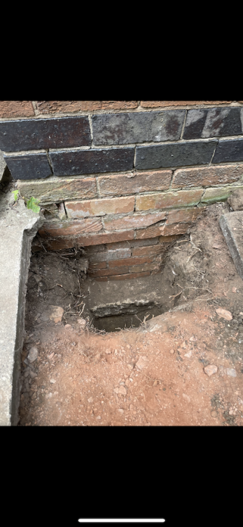

Brickie Posted November 12, 2021 Posted November 12, 2021 2 hours ago, richo106 said: Yes that's correct we want to change the outer skin so all of the house is of the same brick Thanks So you’re taking down to DPC(I presume)? Has anyone considered the possibility of taking right down to footing level & starting from scratch with a much wider cavity?
richo106 Posted November 12, 2021 Author Posted November 12, 2021 26 minutes ago, Brickie said: So you’re taking down to DPC(I presume)? Has anyone considered the possibility of taking right down to footing level & starting from scratch with a much wider cavity? Yes taking it right down and new DPC installed Please see attached image of our foundations Thanks again
