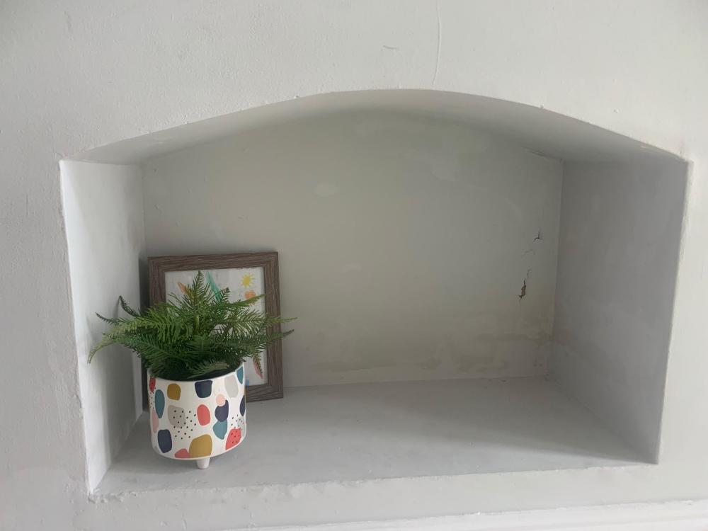

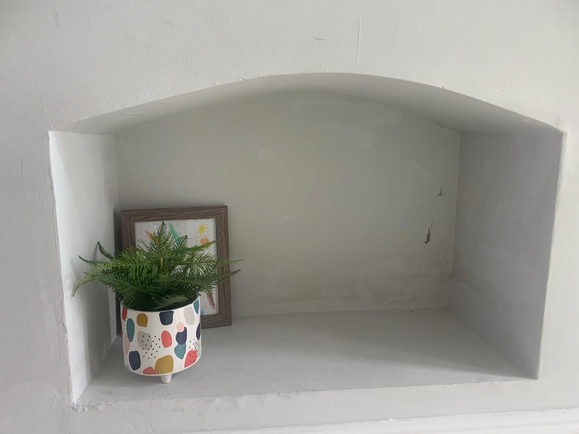

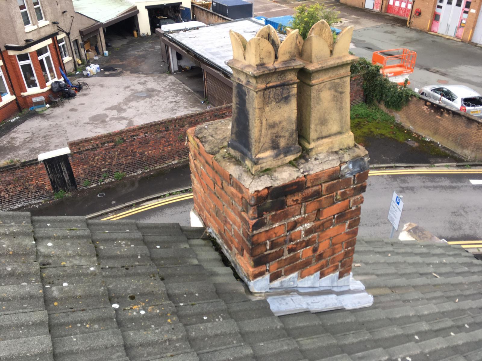

Bex Posted November 9, 2021 Share Posted November 9, 2021 Hi - I have a roofer coming to cap and seal an unused chimney breast on my 1900 property. The chimney will also be re-pointed and flashing secured. My question relates to the distal end which is currently blocked off and plastered. An air brick will be fitted externally but does there need to be distal ventilation at the lower aspect of chimney too? Many thanks Link to comment Share on other sites More sharing options...
Carrerahill Posted November 9, 2021 Share Posted November 9, 2021 (edited) You should vent it, particularly in your case to keep the structure flowing with some air driving off moisture coming from the exposed wall. As it is boarded/bricked up, I would probably just core it and fit a nice vent grille. Far less effort than trying to fit a brick. I'd also maybe initially opt for a smaller vent, like a 75mm core, you just want some air movement but don't want a huge open escape route for all your warm air. I personally have not ventilated one of our sealed chimneys but it is, internal to the house until roof level and is directly adjacent to 2 active chimneys. It is fitted with a vent cap. My feeling is that the warmth in the chimney structure will help keep the capped one dry. Think washed out milk carton sitting in the sun it does dry out. Edited November 9, 2021 by Carrerahill 1 Link to comment Share on other sites More sharing options...
Marvin Posted November 9, 2021 Share Posted November 9, 2021 is the gable end of the building the footpath boundary? Link to comment Share on other sites More sharing options...
tonyshouse Posted November 9, 2021 Share Posted November 9, 2021 Take it down! Link to comment Share on other sites More sharing options...
Bex Posted November 9, 2021 Author Share Posted November 9, 2021 1 hour ago, Marvin said: is the gable end of the building the footpath boundary? There is a footpath alongside it, yes. Why? Link to comment Share on other sites More sharing options...
Bex Posted November 9, 2021 Author Share Posted November 9, 2021 36 minutes ago, tonyshouse said: Take it down! Yeh the roofer mentioned this as an option 1 Link to comment Share on other sites More sharing options...
Marvin Posted November 9, 2021 Share Posted November 9, 2021 36 minutes ago, Bex said: There is a footpath alongside it, yes. Why? Can't then vent through side of wall. Link to comment Share on other sites More sharing options...
Bex Posted November 10, 2021 Author Share Posted November 10, 2021 12 hours ago, Marvin said: Can't then vent through side of wall. thanks, yes, good reminder Link to comment Share on other sites More sharing options...
