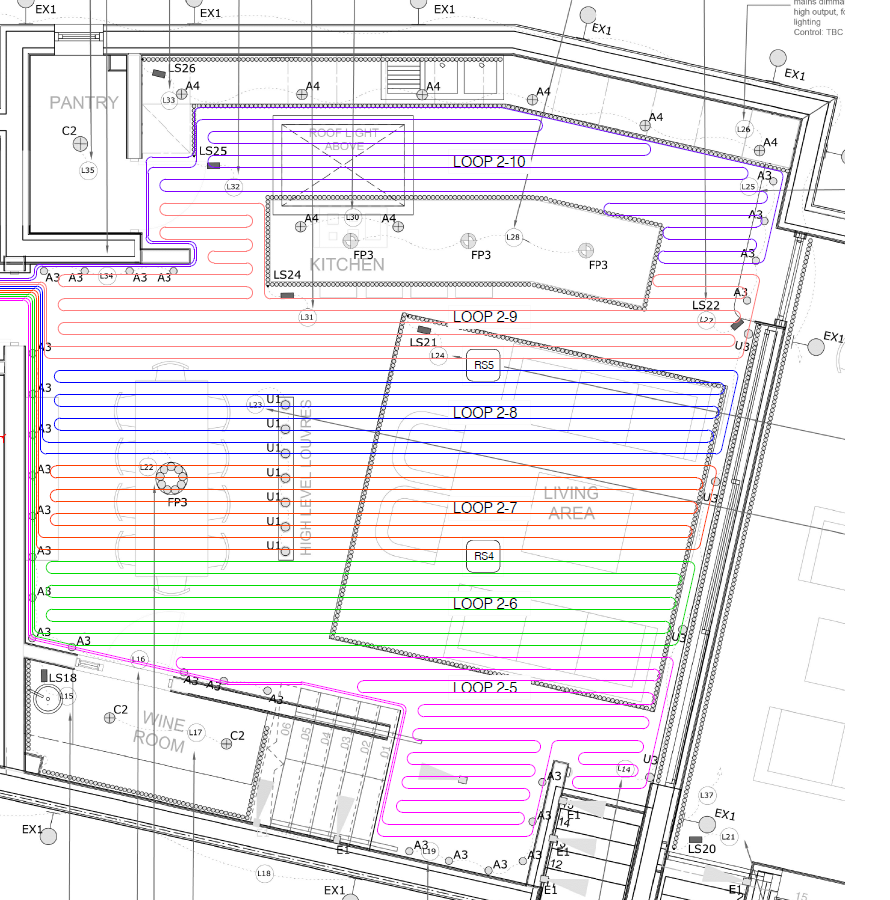

Wunda have done my plan and I made a couple of small changes but they didn't respond to my question about handling solar gain. Each floor has an area facing S/W with a 6m opening which I expect will mean that the part of the floor closest to the glazing will heat up through the solar gain - I figured that if I had the loops running across the room (90 degrees to current plan) then these loops would turn off earlier so saving energy rather than as they are now which will continue to add heat into the solar heated area. Maybe this is such a small impact I shouldn't waste time on it - appreciate your thoughts on that or any other observations.
Pipes are 150 centres, heating by ASHP, concrete floors and ICF wall construction
One option is to do as you suggest and use Salus auto-balancing actuators on each loop.  You shouldn't need to expliclty turn off the loops next to the window, but rather the actuators will automatically reduce the flow in these loops based on the return temperature.  Wunda sell these actuators.
The other way of thinking about it though, is that the layout they proposed may do a better job of distributing heat across the whole areas as all loops will continue to circulate water.
Yes I think I was at one time aiming for that - may be best to stick with this.
The auto-balancing actuators are in the plan ?
I have noticed one improvement - the lower ground (with plant room + utility), I can probably distribute the the congestion in the hallway to reduce Loop 2-2 and instead use that loop in the WC so removing loop 2-1
Why do all the designs I have seen run the pipes as what I understand is is called Single Serpentine, rather than the Double Serpentine or Concentric Layout.
To me Single layout doesn't seem to distribute the heat evenly or is there so little change in water temperature from when it enters to leaves a loop?
+1
Concentric if possible seems the best to me....
