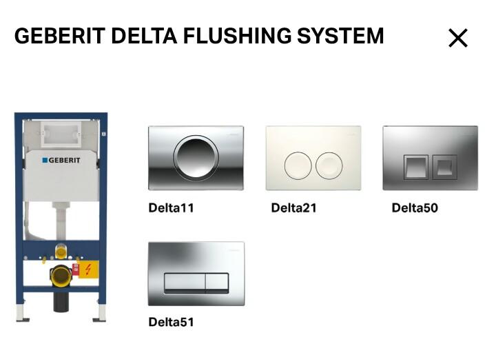

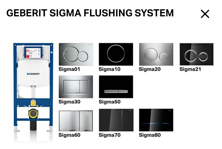

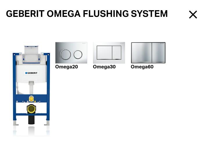

Moggaman Posted October 30, 2021 Share Posted October 30, 2021 Hi. I will be putting in 2 wall hung Toilets in the new build. I am looking at geberit wall frames. There seems to be different ones.. I have no constraints at the location on terms of heights etc.. Can u let me know which one I should go for Link to comment Share on other sites More sharing options...
James94 Posted October 30, 2021 Share Posted October 30, 2021 I've just got two UP320 frames, not fitted them yet. must be careful as there are quite a few model numbers and i noticed some are cheaper than others, but you may get the waste with one and not the other or wall fixing kit and so on. Regards James Link to comment Share on other sites More sharing options...
Onoff Posted October 31, 2021 Share Posted October 31, 2021 I think the Geberit Sigma range offers the best choice of flush plates. Link to comment Share on other sites More sharing options...
Moggaman Posted November 1, 2021 Author Share Posted November 1, 2021 Thanks all.. the geberit frame with sigma cistern is way more expensive than the geberit with omega or delta...why is that? Link to comment Share on other sites More sharing options...
Onoff Posted November 1, 2021 Share Posted November 1, 2021 23 minutes ago, Moggaman said: Thanks all.. the geberit frame with sigma cistern is way more expensive than the geberit with omega or delta...why is that? Less flush plate options for a start on the Omega and Delta. With the Sigma you can end up paying hundreds for an LED touchless plate. I don't think the Omega or Delta offer the squirty up the ar$e Aquaclean or odour extraction systems either? 1 Link to comment Share on other sites More sharing options...
Russdl Posted November 1, 2021 Share Posted November 1, 2021 And, for what it’s worth, the flush plates are different sizes for the different models so make sure if you do get a Geberit you get the correct flush plate for that model. 1 Link to comment Share on other sites More sharing options...
