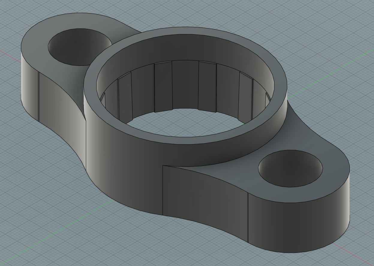

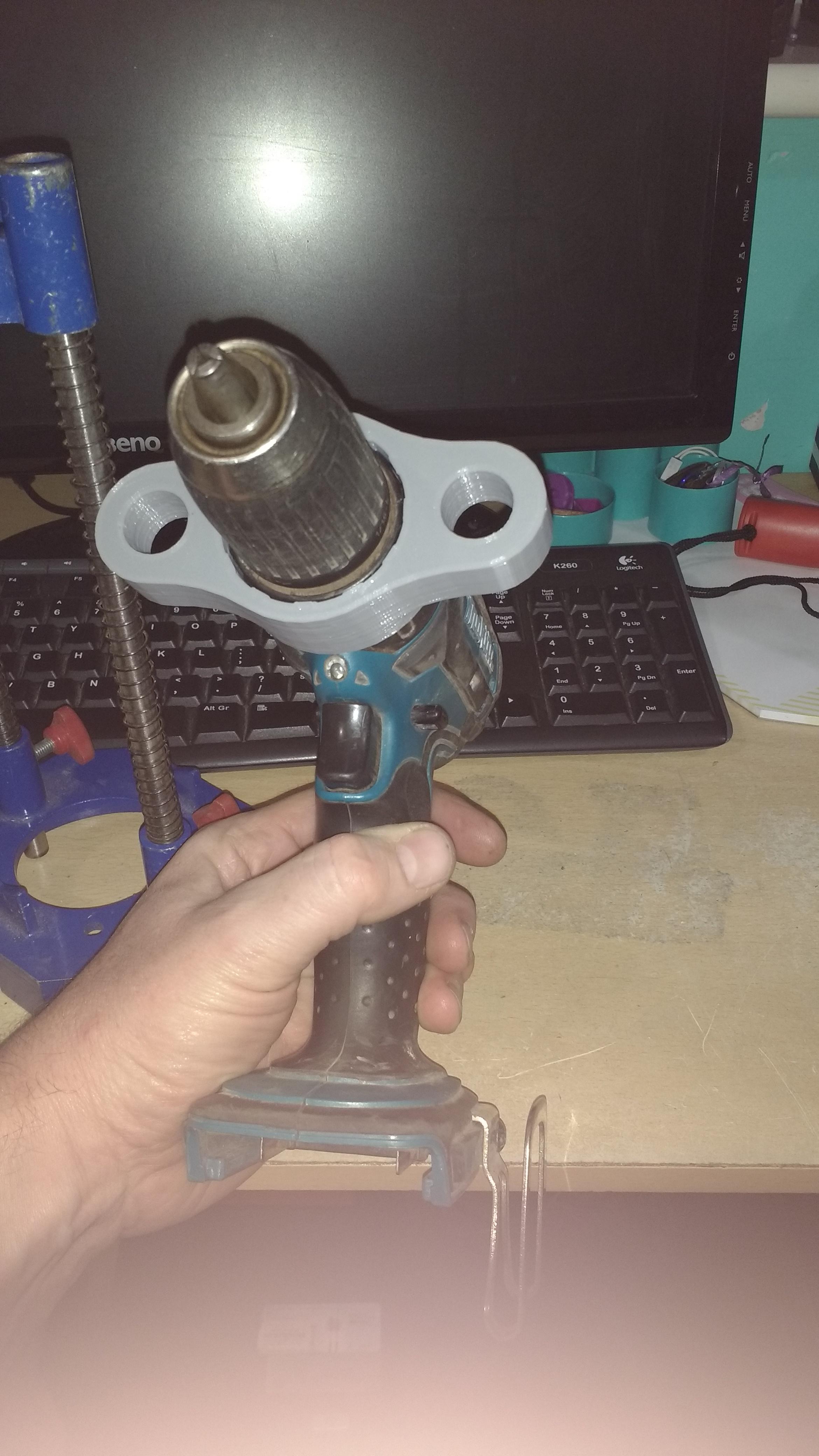

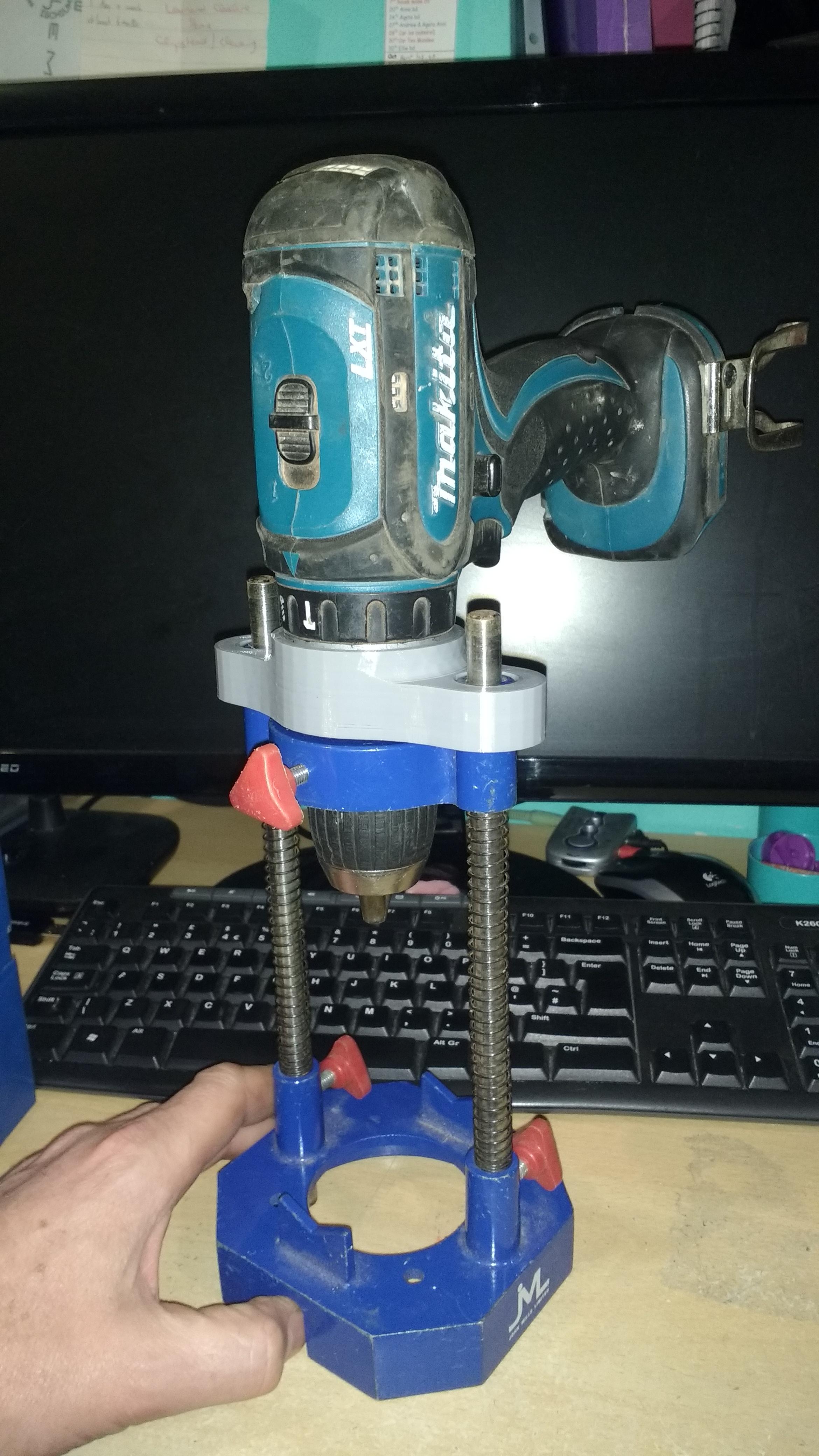

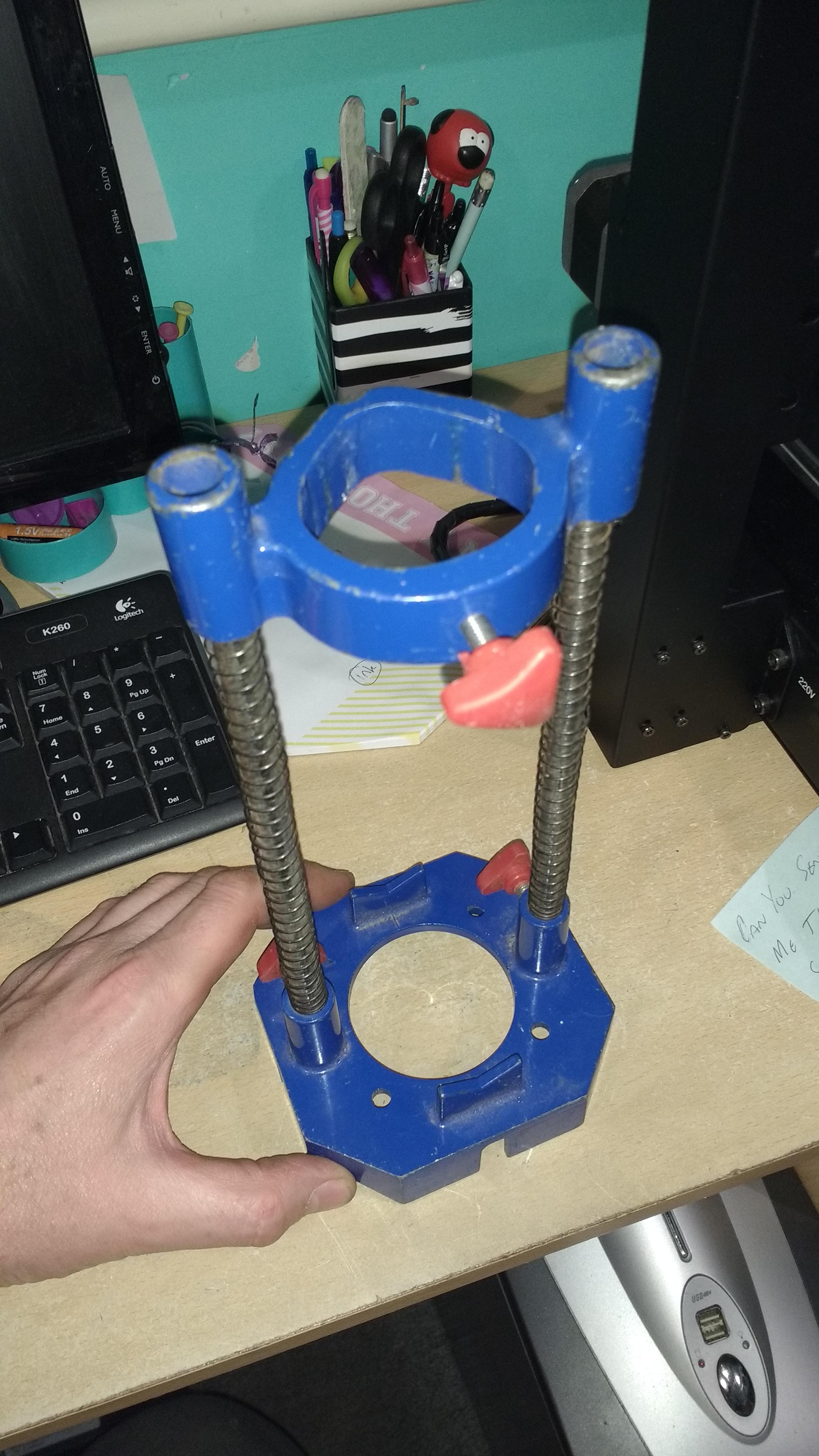

Got one of those little drill presses years ago, the type you'd lock your B&D mains drill in to drill reasonably plumb holes. Nothing I've got now fits it.
Gave it, one of my Makitas and a Vernier to No.1 son and left him to get on with it.
Came up with this:
This slips onto the drill that slides over the blue casting.
Appears to fit nicely. Where the drill fits in is actually tapered and he's got that pretty much bang on. Got to find the original plastic, ,"top hat" liners that go inside the blue casting. If not will print a pair!
As it was a test, only 5% infill but surprisingly strong.
