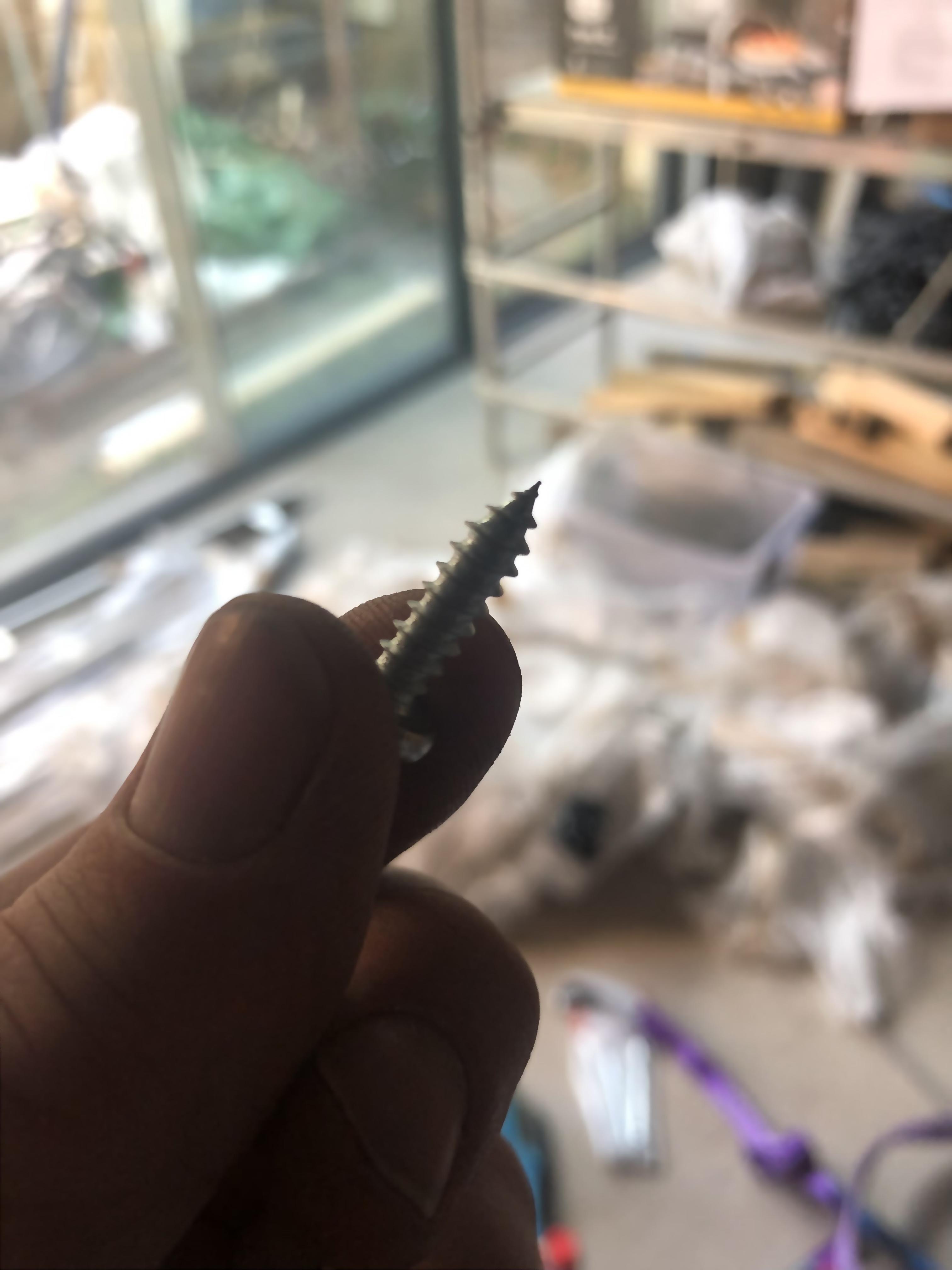

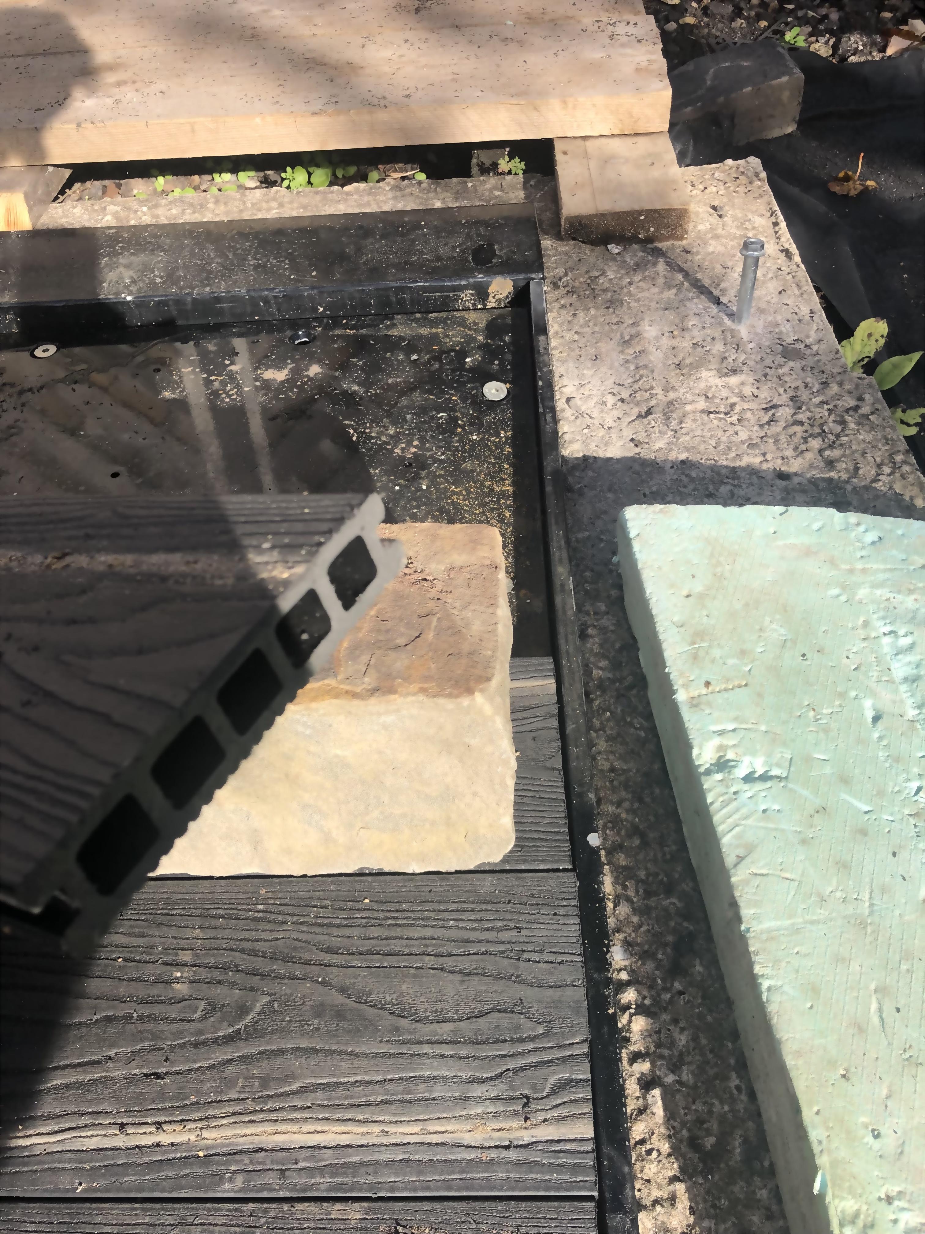

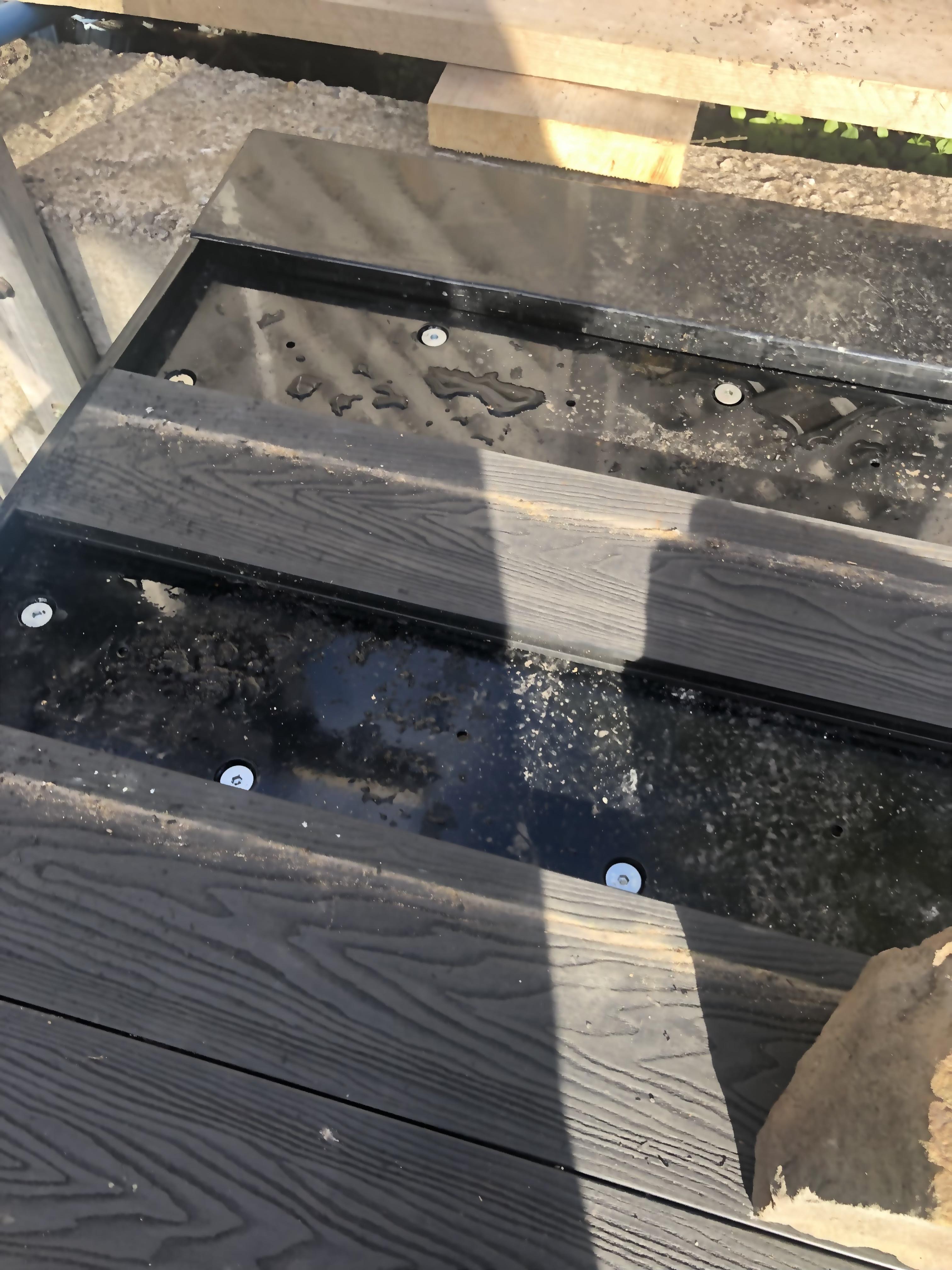

Pocster Posted October 21, 2021 Posted October 21, 2021 (edited) Cracking on with these external stairs . The steps etc are all steel . The tread is this stuff . They supply self drilling screws to attach it from underneath. But they don’t bite as well as I’d like . What I really want to do is fix down through the composite tread into the steel - just at the edges of each tread . So a shallow bolt head would be fine . What should I use though ?? Edited October 21, 2021 by pocster

Pocster Posted October 21, 2021 Author Posted October 21, 2021 (edited) 25 minutes ago, Mr Punter said: Clean the materials and stick down with https://www.screwfix.com/p/sika-sikaflex-ebt-all-weather-sealant-grey-300ml/79250 Yeah I thought about that . But if they get damaged and need to come up …. I could just drill a hole through tread and steel then nut and bolt . But it’s a pita trying to tighten the nut when you can’t reach the bolt . No friends syndrome again ?? Edited October 21, 2021 by pocster
Pocster Posted October 21, 2021 Author Posted October 21, 2021 42 minutes ago, dpmiller said: Tekscrews? They look interesting. Maybe with a washer on so they don’t pull through the composite tread . Might be worth an experimentation first …. ?
Conor Posted October 21, 2021 Posted October 21, 2021 Of all the things I've tried for fixing to steel, the best by far have been concrete screws. The hardened steel cuts a really good thread and the screws stick better than anything else. Probably overkill for this case tho.
Pocster Posted October 21, 2021 Author Posted October 21, 2021 32 minutes ago, Conor said: Of all the things I've tried for fixing to steel, the best by far have been concrete screws. The hardened steel cuts a really good thread and the screws stick better than anything else. Probably overkill for this case tho. Really , concrete screws ? . Overkill maybe ; but if it makes a rock solid fixing I’d be happy .
Conor Posted October 21, 2021 Posted October 21, 2021 Yes. For a 7.5mm screw, drill a 6 or 6.5mm pilot hole. I use the 70mm ones from Screwfix. An alternative could be coach screws. 1
