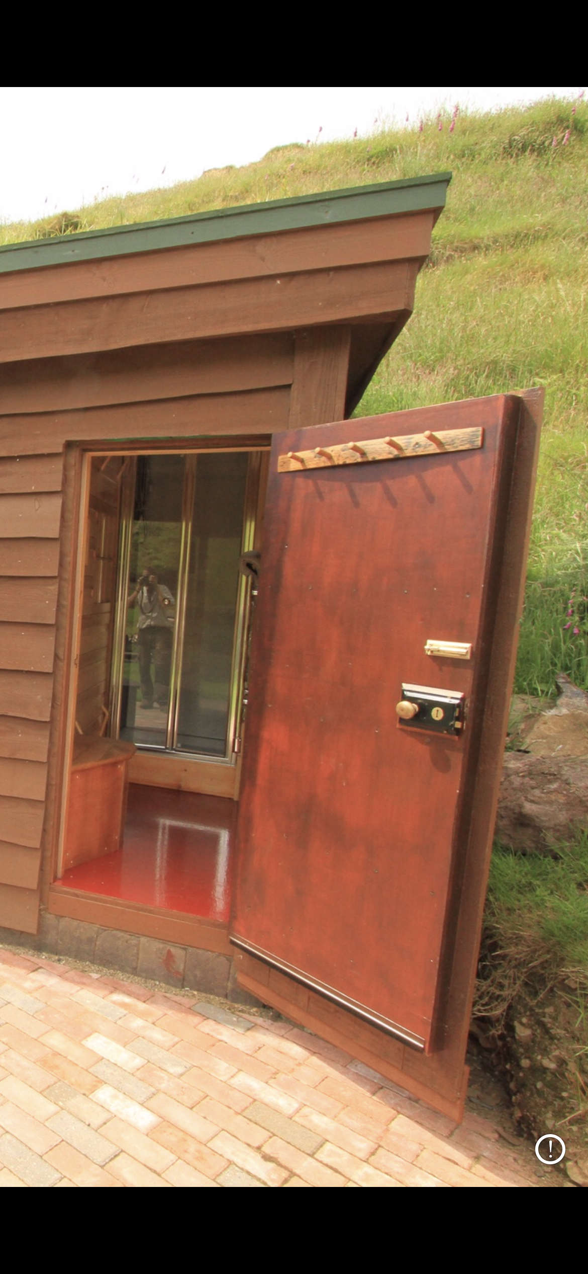

Cpd Posted October 18, 2021 Share Posted October 18, 2021 May not work for you but I have added kingspan to many of the doors on my property, I put 50mm on some doors but usually just add 25mm and then put a sheet of ply over it, if I am being fancy I put edging strips on to hide the kingspan but mostly I just seal the edges with tape. The door in the photo is to my heated shower room in my cabin, it’s got 27mm if larch on the outside, 50mm of kingspan and 10mm ply on the inside with edging. It’s all very rustic and not for everyone but I like knowing I am not loosing loads of heat from this room. Link to comment Share on other sites More sharing options...
