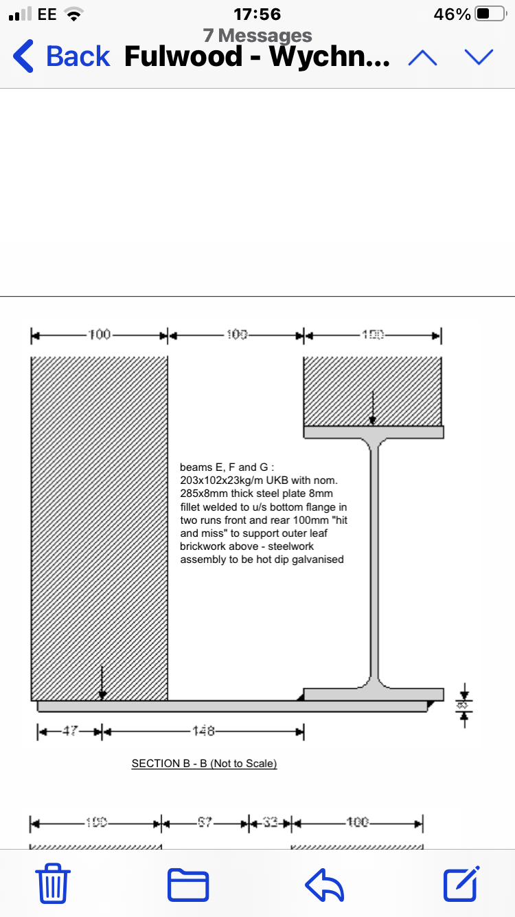

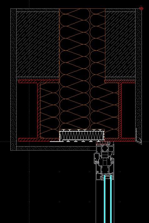

Moonshine Posted October 17, 2021 Posted October 17, 2021 i have two bi-folds one 3.6m and one 3m, due to a cock up in ordering i am now using steel beams over the openings, with beam sizes specified by the SE Below is the rough detail i have drawn (there will need to be a cavity tray and weep holes above the opening), and i am scratching my head how to support the render and wet plaster over the areas of the beams, and also what to do about the area of the exposed beam on the outside just above the bi-folds. Any 0ther comments on the detailings would be welcome (e.g. cold bridging
George Posted October 17, 2021 Posted October 17, 2021 Plasterboard on the inside and cement board on the outside. To hide it, either just paint the steel black or some sort of wrap around power coated flashing. . Make sure the spec of the steel paint in the outer leaf is corrosion resistant (or galvanised).
markc Posted October 17, 2021 Posted October 17, 2021 I would have the beam galvanised, even a very good paint spec will need maintenance
nod Posted October 17, 2021 Posted October 17, 2021 I would use one steel over the bifolds with a hit and miss plate welded to the underside to catch the outer skin of block
Dave Jones Posted October 17, 2021 Posted October 17, 2021 for a normal 300mm wall, have a 290mm (to hide the joint) plate welded to the steel to sit the ourside brickwork on. The SE should be speccing this anyway.
Moonshine Posted October 17, 2021 Author Posted October 17, 2021 5 hours ago, nod said: I would use one steel over the bifolds with a hit and miss plate welded to the underside to catch the outer skin of block Do you have a detail / diagram for this?
nod Posted October 17, 2021 Posted October 17, 2021 17 minutes ago, Moonshine said: Do you have a detail / diagram for this?
