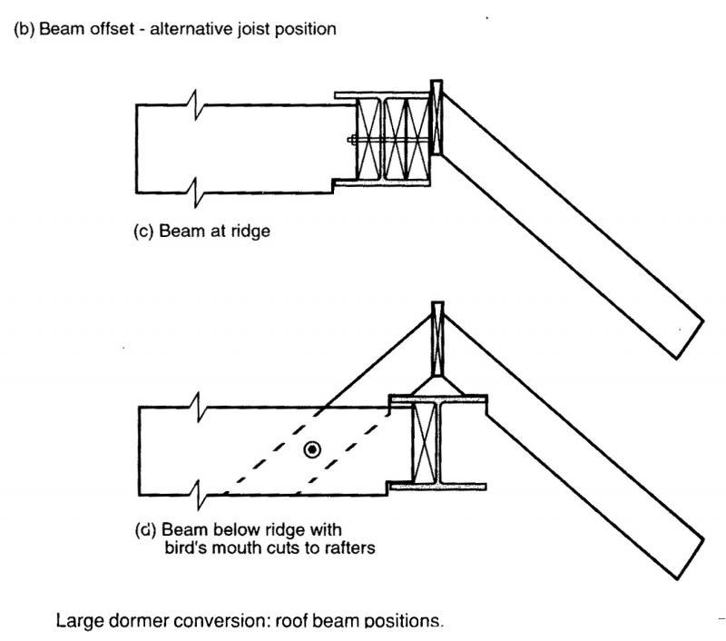

Temp Posted October 12, 2021 Share Posted October 12, 2021 Are you allowed to have a ridge beam bridging the insulation in a loft these days? eg Is Option (c) "Beam at Ridge" with insulation between the rafters allowed? Link to comment Share on other sites More sharing options...
Carrerahill Posted October 12, 2021 Share Posted October 12, 2021 (edited) 15 minutes ago, Big Jimbo said: I doubt that your existing ceiling joists on the first floor will be man enough to become the floor joists of your new second floor. Normally much larger joists are placed inbetween the existing ceiling joists in order to form a new floor. So i doubt that at 2.15m you have enough height for a loft conversion that would give you a 2m internal floor to ceiling height. He will if they put in new engineered or metal joists in between and just slightly higher than the existing. It can probably be done, there is just not enough thinking happening. Another consideration is replacing the ridge with a smaller steel - can be done from the inside. Not my original ideas but a very clever structural engineer friend of mine who gets things working in tight spaces! Edited October 12, 2021 by Carrerahill Link to comment Share on other sites More sharing options...
