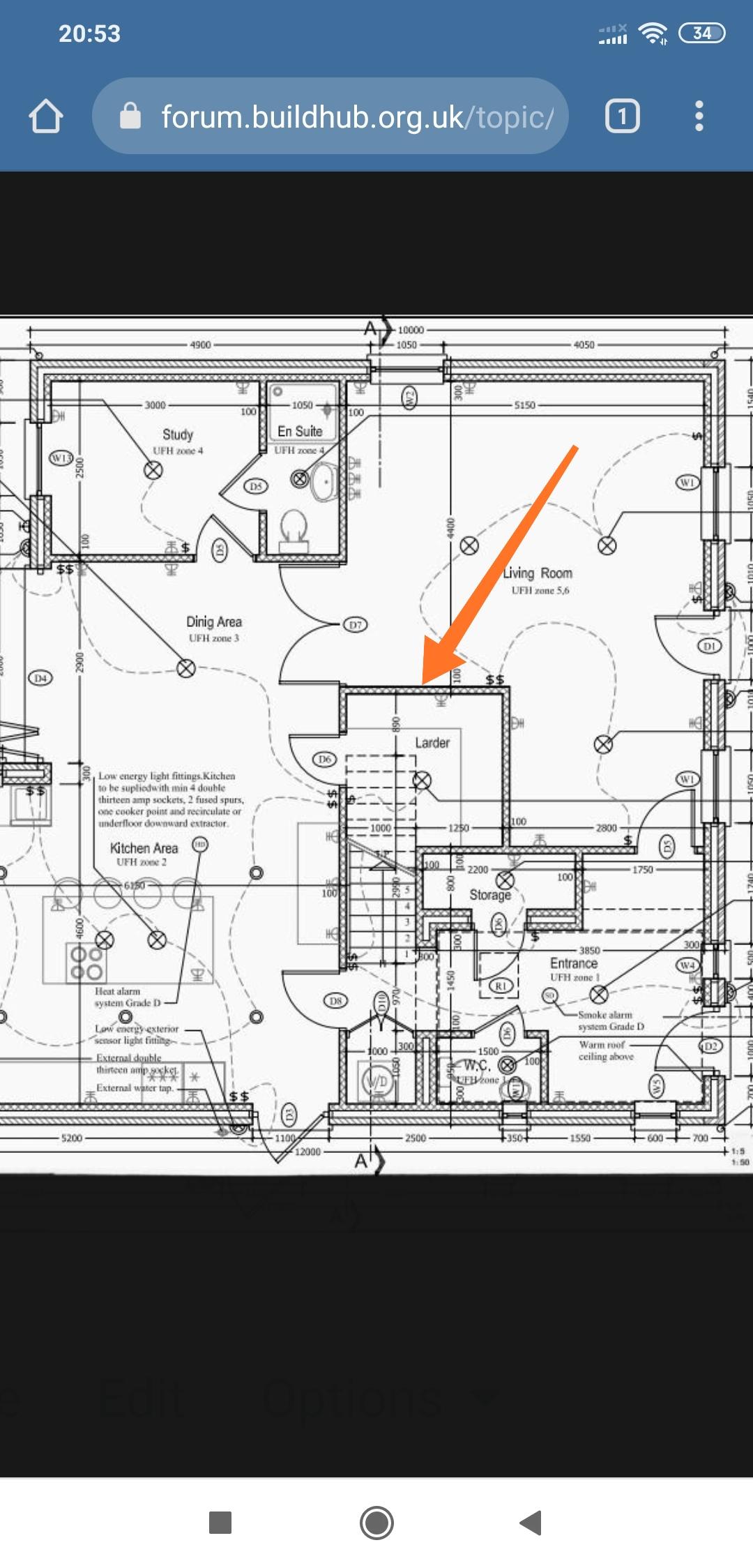

WWilts Posted October 11, 2021 Share Posted October 11, 2021 One wall (fat red arrow) moved in error by builder during internal setting out. Goes down to foundations (concrete slab on hardcore on trench fill). Has consequences, as highlighted in pic. Esp stairs vs bedroom door. Brainstorming for options to set things right (short of digging up slab and redoing the wall). That internal wall is still only at finished floor level, nothing atop DPC yet. For various reasons, digging up would be the very last resort. Suggestions? Link to comment Share on other sites More sharing options...
Moonshine Posted October 11, 2021 Share Posted October 11, 2021 5 minutes ago, WWilts said: One wall (fat red arrow) moved in error by builder during internal setting out. Goes down to foundations (concrete slab on hardcore on trench fill). Has consequences, as highlighted in pic. Esp stairs vs bedroom door. Brainstorming for options to set things right (short of digging up slab and redoing the wall). That internal wall is still only at finished floor level, nothing atop DPC yet. For various reasons, digging up would be the very last resort. Suggestions? - change the stairs to put a quarter tern or something in? its impossible to know if this is doable without layouts (can you post) - Thinner door? looks pretty small anyway - steeper stairs, max to BR is 42 degrees. - how wide was the trench under the slab, check with the SE and ask how much does it have to have either side of the wall, it maybe o.k to have the wall off centre on the trench line. 1 Link to comment Share on other sites More sharing options...

WWilts Posted October 11, 2021 Author Share Posted October 11, 2021 ground floor Link to comment Share on other sites More sharing options...

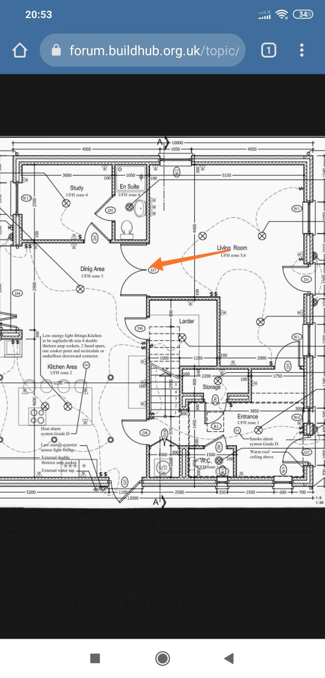

Declan52 Posted October 11, 2021 Share Posted October 11, 2021 Is it this wall??? Link to comment Share on other sites More sharing options...
WWilts Posted October 11, 2021 Author Share Posted October 11, 2021 1 minute ago, Declan52 said: Is it this wall??? Yes Link to comment Share on other sites More sharing options...
Declan52 Posted October 11, 2021 Share Posted October 11, 2021 How far out is it?? How much depth of floor insulation and screed did you plan on using?? Was the wall on this pic built up during the foundations?? Link to comment Share on other sites More sharing options...
WWilts Posted October 11, 2021 Author Share Posted October 11, 2021 (edited) 32 minutes ago, Declan52 said: Was the wall on this pic built up during the foundations? Yes, foundations are in place for the wall that has the double doors. Structural wall moved by 180mm from plan. However, 40mm of that is attributable to the increased width of the blocks from 100mm to 140mm, as agreed. Of the 140mm remaining error, 100mm has been clawed back by another error. So, on looking carefully again, there is 40mm shortening of stairs required. 14 stairs in all incl landing Original plan ground floor to ceiling 2600 (above 100mm Celotex & 65mm screed, hard wood flooring) Flooring to flooring 2830mm in original plan (over 14 stairs) Edited October 11, 2021 by WWilts Link to comment Share on other sites More sharing options...
