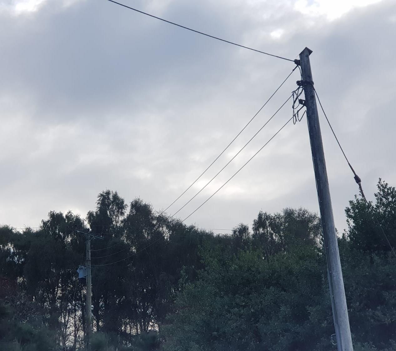

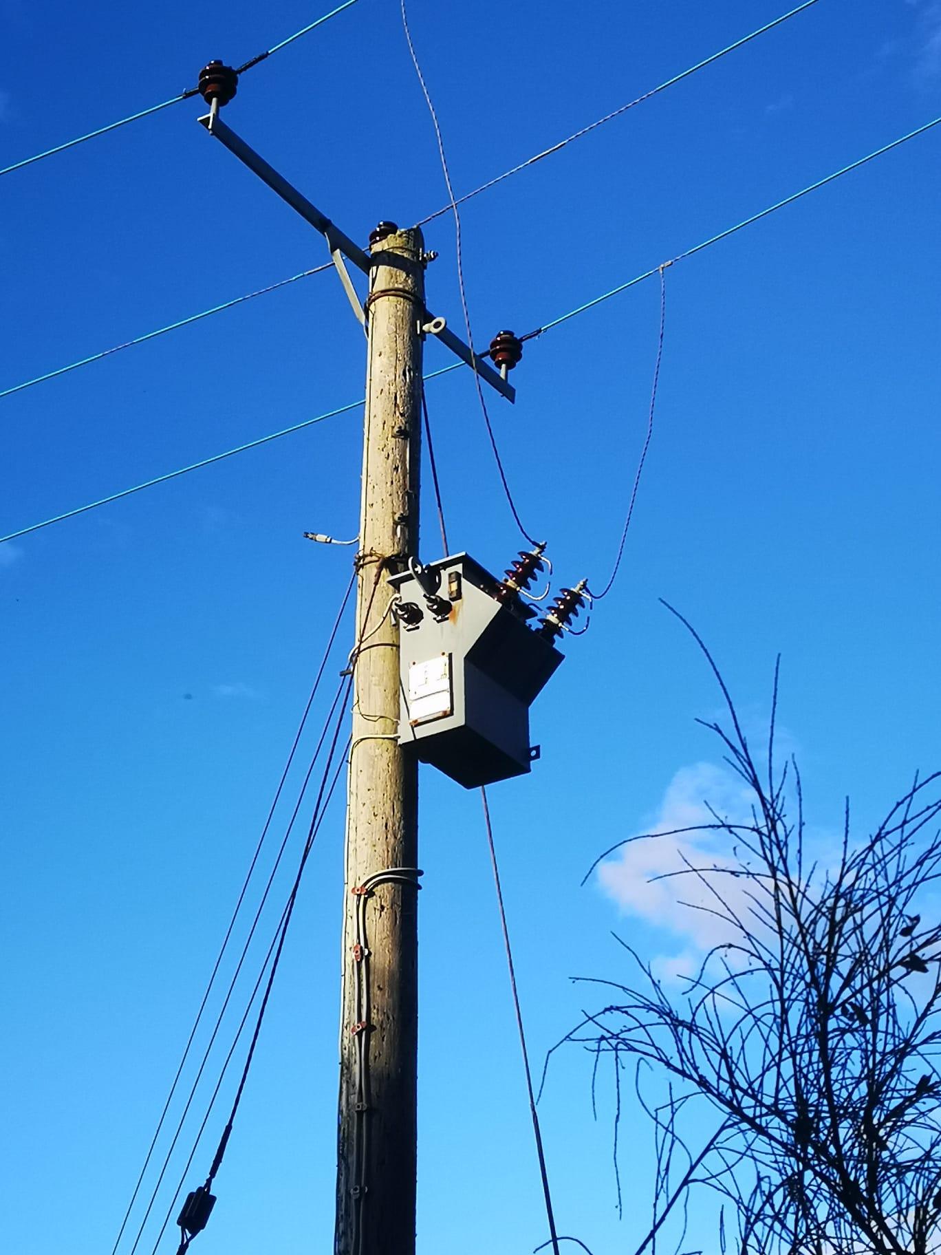

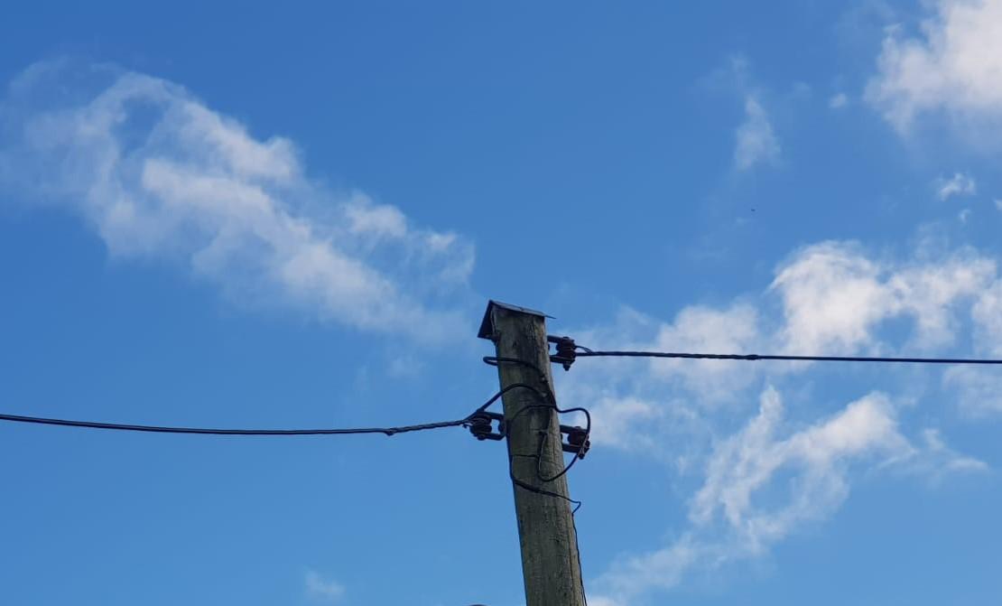

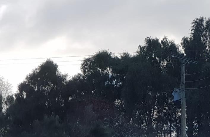

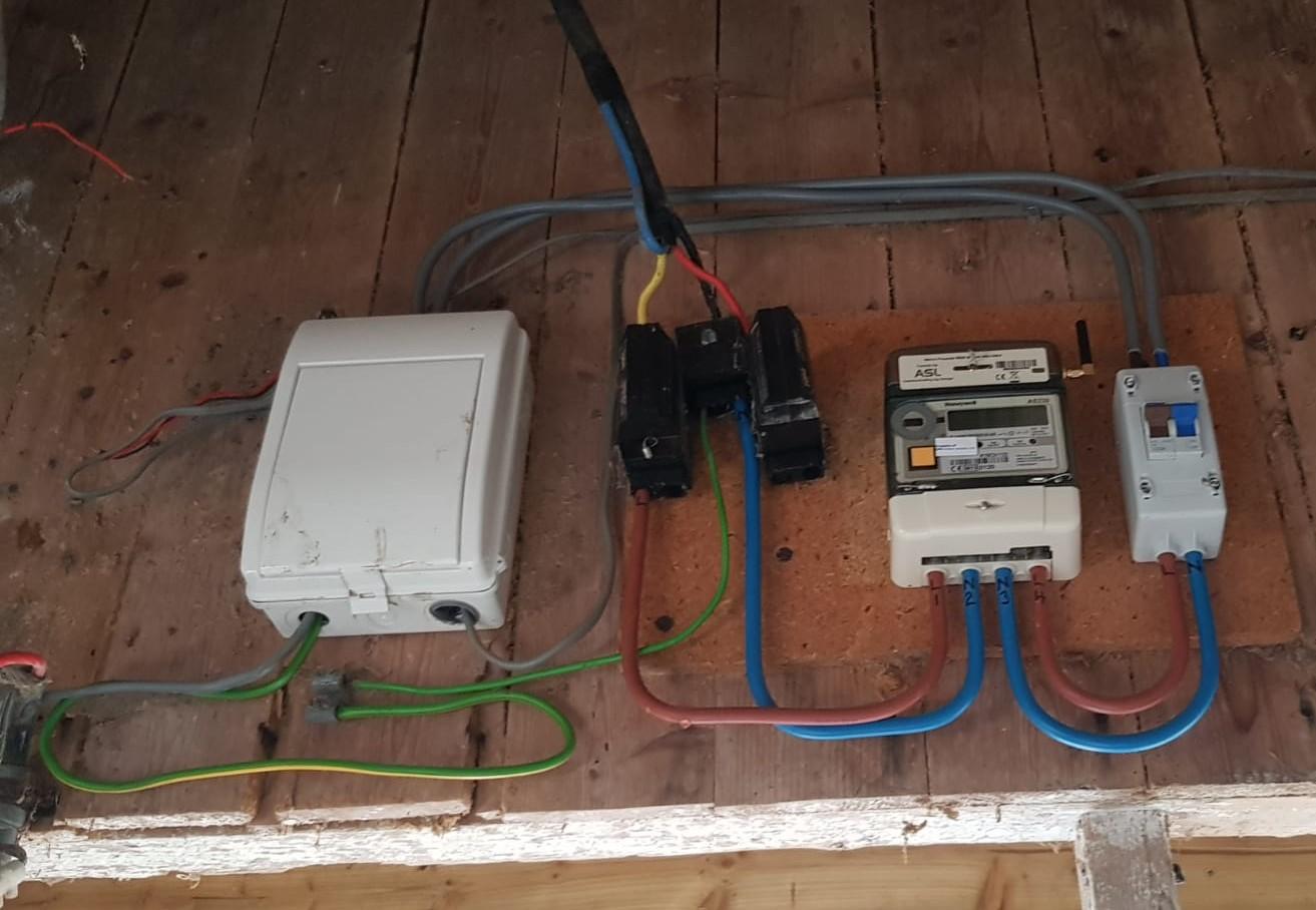

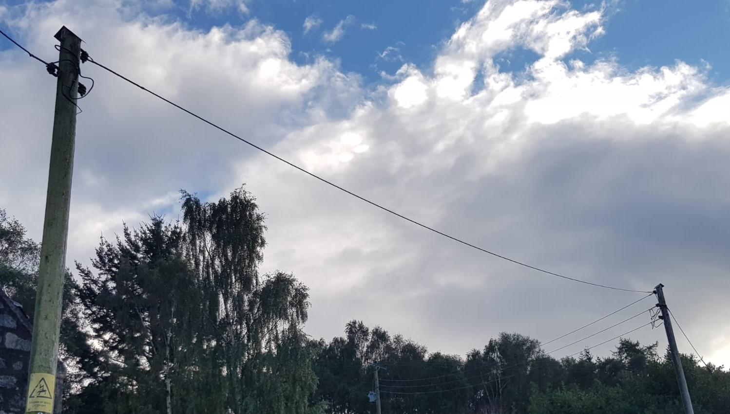

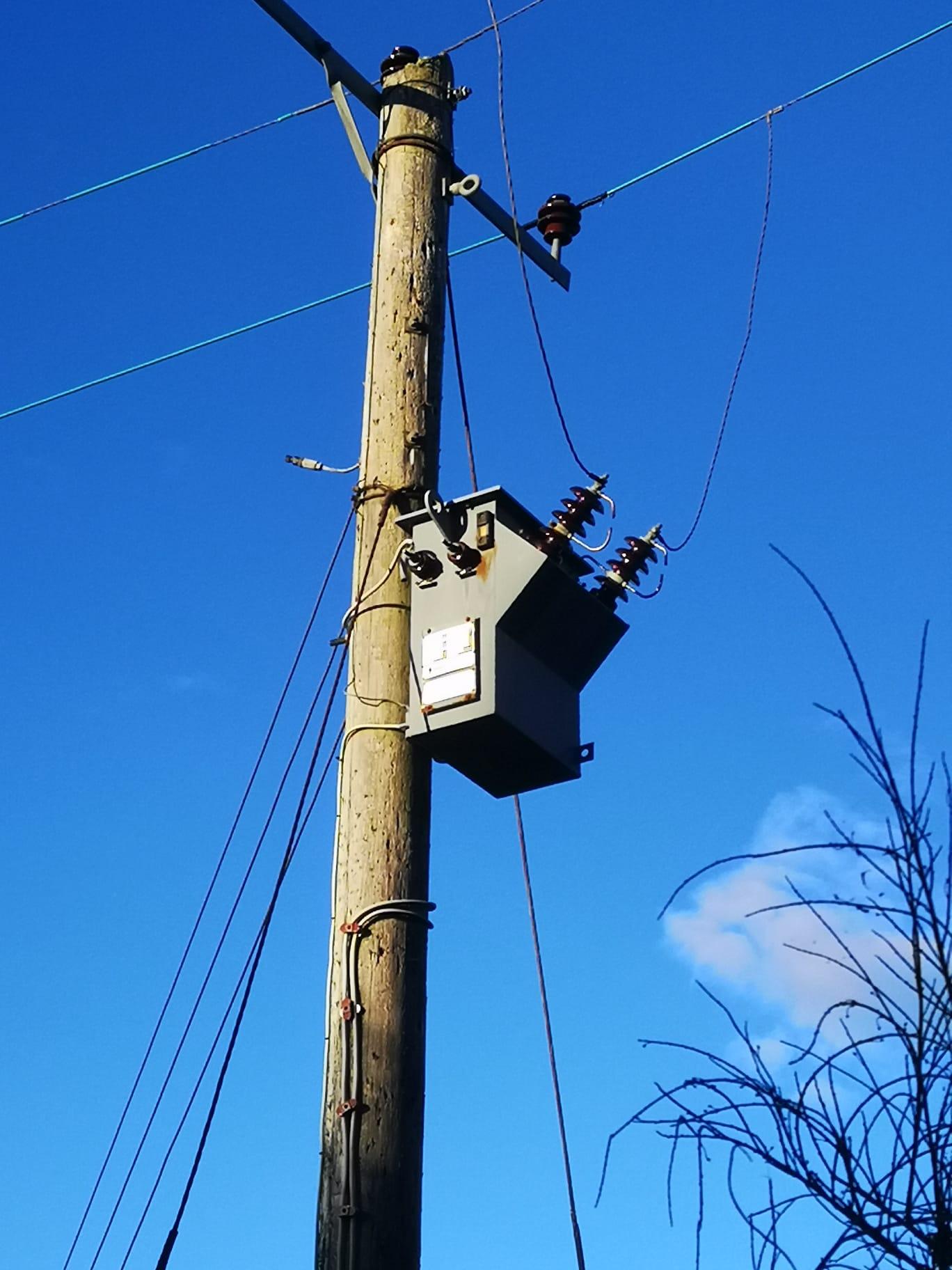

saveasteading Posted September 27, 2021 Posted September 27, 2021 Photos below. have included the overhead cables in case you can 'read' them. 1. transformer on the left post and 3 cables to next post, on our land. and single cable off. The transformer post is on the main through run of cables 2.. the connection, which is live single phase, blue wire bent back. 3. Intermediate post, with cable to the building. 4. all 3 posts from further back 4 photos from the connection, to the first post
TonyT Posted September 27, 2021 Posted September 27, 2021 (edited) Looks like 2 phase supply, assuming that it’s actually energised at the cut out. bit rough leaving the blue conductor not terminated Edited September 27, 2021 by TonyT
saveasteading Posted September 27, 2021 Posted September 27, 2021 6 minutes ago, TonyT said: Looks like 2 phase supply Does that effectively mean 2 supplies of 240 volts? Might that be all we need for a domestic supply plus an ASHP? According to the sparky who remade the connection, it was already live, even though unused for many years. He didn't mention the blue. We only asked for a caravan and builder's socket so maybe it is all just ready to use. I'm pretty sure we are only paying for a single domestic connection. Supplier hasn't been to see.
ProDave Posted September 27, 2021 Posted September 27, 2021 How many wires are there on the "through" line on the pole where the transformer is (I have tried zooming in but can't see against the backdrop of the trees) Whatever that supply is, I would say the cable size is substandard and the cable in from the pole should be upgraded.
saveasteading Posted September 27, 2021 Posted September 27, 2021 Three. We have a plan with all the voltages from a neighbour's old enquiry, so can find a few voltages etc.if that is of any use.
ProDave Posted September 27, 2021 Posted September 27, 2021 Okay so that's a 3 phase supply to the transformer pole. How about a close up photo of the connections into the transformer?
saveasteading Posted September 29, 2021 Posted September 29, 2021 (edited) Edited September 29, 2021 by saveasteading
ProDave Posted September 29, 2021 Posted September 29, 2021 So you have 3 phase to the pole, but that is only a single phase transformer. You could probably get 3 phase to the house, but it would mean upgrading that transformer, it would be interesting to see how much they wanted for that. 1
saveasteading Posted September 29, 2021 Posted September 29, 2021 Thanks. How do you do that? Is the transformer just to step down from huge voltage to domestic? Unfortunately I may know the answer, as we applied on a different site that fell through. They wanted £15 k to provide a new transformer, where there was none, and bring in 100m of cable and 2 new poles. So we think the transformer is about £10k, and then the cable. We have an enquiry in for an upgrade but it will be a long time in getting a quote. Do we need 3 phase though? 350m2 of floor area, quite high ceilings but will be well insulated and airtight. I was thinking we needed 3 phase for domestic + 15kVA ASHP, +water pump, but perhaps that second wire is live and gives us double the power...or could do. Do you mind explaining what 2 phase is for? After many years of sparkies failing to explain, I think I understand why 3phase is clever and efficient, but 2? Is it just 2 supplies in one tidy cable?
ProDave Posted September 29, 2021 Posted September 29, 2021 3 phases is as the name suggests 3 separate L cables each one being 120 degrees out of phase with each other. That is what you would get if they changed the transformer for a 3 phase one, and upgraded the cable from the transformer to your steading. If you want the maximum single phase, ask for an upgrade to 20KVA. The transformer will probably be okay but the cable between would probably need upgrading. 2 phase would be just that, only 2 of the phases connected, a bit pointless (as you can't run 3 phase equipment) but might be handy to give you double the capacity, but you can't get that with that transformer. Your options are: Do nothing but seek clarification of what they rate the capacity in KVA of the existing supply and see if that is enough. Ask for a price for an upgrade to 20KVA single phase Ask for an upgrade to 60KVA 3 phase. Asking for the quotes does not oblige you to proceed if you don't like the answers and can live within the power limit of the existing supply.
