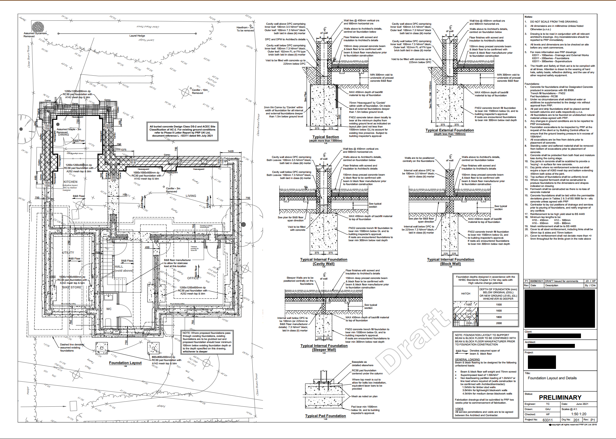

puntloos Posted September 16, 2021 Posted September 16, 2021 This is a provisional design, but are there any cold bridges in here? I understand there might be, but I can't see where.. anyone a bit of a passiv designer?
Olf Posted September 16, 2021 Posted September 16, 2021 All the beam and block floor and wall junctions are. You can mitigate it with adding internal wall insulation (if going PB with service cavity route), the higher it reaches, the better - and contributed to wall U value. Or make a thermal break at the slab perimeter insulation level with Thermoblock or alternatives. Depending whether you use UFH or radiators the rationale may change a bit - with rads these cold bridges are of less penalty, as the floor is relatively cold, with UFH they'll turn some of the effort of warming inside into heating the foundations instead (perimeter insulation helps, but only so much as 25-30mm can, and then unprotected wall sponges the heat and takes it to teh dungeon underneath). Saying that, most people just move on and live with the standard detail as on your drawings. Calculating losses due to psi values is a bit more esoteric than U, so it is harder to get return on investment in extra insulation/thermal break calulation.
puntloos Posted September 16, 2021 Author Posted September 16, 2021 There's a few other things that I'm missing: Specifications for wall ties seem incorrect for low energy building No thermal breaks on kitchen frame steel structure Anything else that we should consider adding?

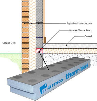

Mr Punter Posted September 20, 2021 Posted September 20, 2021 Another vote for the Marmox Thermoblock installed at the same level as the floor insulation on the inner leaf of the perimeter walls.
puntloos Posted September 20, 2021 Author Posted September 20, 2021 3 hours ago, Mr Punter said: Another vote for the Marmox Thermoblock installed at the same level as the floor insulation on the inner leaf of the perimeter walls. Ah this seems to make sense. 5 hours ago, AliG said: This is similar to the blockwork in my house and you can feel the floor is colder next to the block walls that go down to the foundations. Don't... all ground floor block walls go down to the foundations? 5 hours ago, AliG said: What I don't know is whether the cost of eliminating these bridges pays for itself. The thing that more surprised me is the cavity internal walls. I have some thick supporting internal walls, but they are made from wider blocks (Porotherm). I would have thought the normal construction for these is blocks laid on their side, not a cavity. Do you have any drawings so I can understand what you mean? 5 hours ago, AliG said: I have one small area where there are two internal block walls with a cavity in between. No one thought to insulate this wall, but it connect through to the outside wall and is obviously colder than all the other walls in the house. It is also a problem for airtightness and the cavity is connected to the outside cavity. It is also an enormous waste of space, you have some 400mm internal walls, why are these not solid 200mm walls? Oh, partially loadbearing, partially noise reasons. Home Cinema. 5 hours ago, AliG said: Those doors sliding into the wall cavity are also an airtightness problem. You need to make sure the builders seal up the cavity behind the doors, which they won't do unless they are made to do it. I don't think they're supposed to slide all the way into the cavity wall indeed, but I'll make sure. What should be used to seal it up? Spittle mixed with wood shavings?
