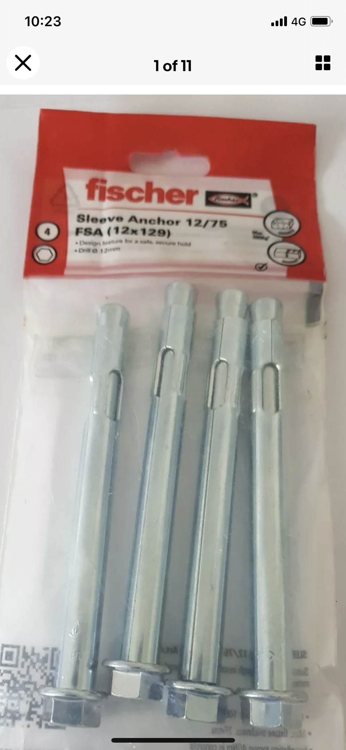

Pocster Posted September 14, 2021 Author Share Posted September 14, 2021 The fixings I’ve ordered look stainless steel . But when I drill the concrete with the stringer in situ bound to catch the coating around the hole . If I do that and some powder coating comes off - what should I repair the chips with ? Link to comment Share on other sites More sharing options...
Onoff Posted September 14, 2021 Share Posted September 14, 2021 If your fixings are stainless they'll likely say "A2" on them or the packet. You can tell if they're stainless pretty well by putting a magnet on them. If it sticks they're not stainless. Is it painted to a particular RAL number? Best start is to get some polyester powder coat touch up pens or better a pot of touch up paint from whoever did the PPC. The use the same paint powder in a solvent so it matches exactly. You can get it from 3rd parties online but they expect you to have some powder. Some of course will sell you the powder. The touch up paint pots have a little brush in like for solvent weld. If you just want to get on and do it then drill your hole, small brush, zinc rich primer and let it dry for a bit. If you go brush then any anti corrosion primer ideally with a zinc base. I see TS do a Rustin's one. At work we'd use Galvafroid generally on steelwork or Zinga sometimes. I say brush rather than a spray but I use the Pro-Cote Cold Galv Spray from Toolstation a lot for my various mad projects and garden repairs (at work too tbh). If you feel you can spray in the holes accurate enough without overspray (or mask up). I'd still probably spray. For this I might even splash out in some Zinc 182 spray (Halfords do it). It's good stuff. Let it dry in the hole. The Pro-Cote stuff dries real quick btw. Slap some grease in there, nut it up with a smear of anti seize on the threads. Go round later and wipe any excess off if it annoys you. For ongoing protection around the fixings a squirt of ACF-50. Periodically check the torque too. Link to comment Share on other sites More sharing options...
Onoff Posted September 14, 2021 Share Posted September 14, 2021 Are the fixings they supplied with the stairs stainless steel? On the head of the bolt it'll be be stamped say "A2-70", best is "A4-80". If mild steel then I would hope they'll be stamped "8.8". Similarly I'd expect galvanised fixings rather than bright zinc plated for this. Link to comment Share on other sites More sharing options...
Pocster Posted September 14, 2021 Author Share Posted September 14, 2021 16 minutes ago, Onoff said: Are the fixings they supplied with the stairs stainless steel? On the head of the bolt it'll be be stamped say "A2-70", best is "A4-80". If mild steel then I would hope they'll be stamped "8.8". Similarly I'd expect galvanised fixings rather than bright zinc plated for this. Here’s the wall fixing bolts I’ve ordered . I’ll check the supplied bolts when on site Link to comment Share on other sites More sharing options...
markc Posted September 14, 2021 Share Posted September 14, 2021 I would say they are BZP (zinc plated) decent drill, good clean hole and they will be fine 1 Link to comment Share on other sites More sharing options...
Onoff Posted September 14, 2021 Share Posted September 14, 2021 I think they're w@nk. For the few quid it'll cost I'd go stainless. https://www.orbitalfasteners.co.uk/products/m12x7075-sleeve-anchor-stst Then what do I know having worked on all forms of holding down units for man riding equipment, staircases and ladders etc for 40 years? ? 1 Link to comment Share on other sites More sharing options...
Pocster Posted September 14, 2021 Author Share Posted September 14, 2021 49 minutes ago, Onoff said: Are the fixings they supplied with the stairs stainless steel? On the head of the bolt it'll be be stamped say "A2-70", best is "A4-80". If mild steel then I would hope they'll be stamped "8.8". Similarly I'd expect galvanised fixings rather than bright zinc plated for this. Supplied bolts are indeed stamped 8.8 Link to comment Share on other sites More sharing options...
Pocster Posted September 14, 2021 Author Share Posted September 14, 2021 10 minutes ago, Onoff said: I think they're w@nk. For the few quid it'll cost I'd go stainless. https://www.orbitalfasteners.co.uk/products/m12x7075-sleeve-anchor-stst Then what do I know having worked on all forms of holding down units for man riding equipment, staircases and ladders etc for 40 years? ? Ok , ok ffs ! , I’ll order those . But I’ll see if they do longer ones …. Link to comment Share on other sites More sharing options...

Onoff Posted September 14, 2021 Share Posted September 14, 2021 Fyi these are all galvanised fixings a few years old. The one on the left stamped 4.6 a lower tensile grade that the 8.8 on the right. Treat any unstamped bolt as the lowest grade unless proven otherwise. You can see some have a little rust on them. Periodic spannering may damage the galv coating on the head. Similarly you can see rust where a couple passed through other steel plates and moisture would have lodged. These are bright zinc plated bolts, much shinier, not as good as galv: You can also get a "yellow zinc" finish. Slightly better than bright zinc plated...but still w@nk for this! ? 1 Link to comment Share on other sites More sharing options...

Onoff Posted September 14, 2021 Share Posted September 14, 2021 Talking ball park then to achieve similar tensile strength to a mild steel 8.8 you want to aim for A2-80 or A4-80 if using stainless. The 80 bring a higher strength that 70. A2 and A4 refers to the corrosion resistance properties. A4 basically the best, for marine and harsh chemical environments. Those fasteners I linked are 316 which is aka A4 so top flight corrosion resistance. They'll be good. 2 Link to comment Share on other sites More sharing options...

Pocster Posted September 15, 2021 Author Share Posted September 15, 2021 (edited) On 14/09/2021 at 10:48, Onoff said: I think they're w@nk. For the few quid it'll cost I'd go stainless. https://www.orbitalfasteners.co.uk/products/m12x7075-sleeve-anchor-stst Then what do I know having worked on all forms of holding down units for man riding equipment, staircases and ladders etc for 40 years? ? Don't seem to do them any longer. I would prefer a deeper fixing.... any thing else you recommend? Just worried it's only 70mm. Remember 2 top fixings have to go through the wall lip steel then the stringer steel ( that's at least 20mm just there ). 100mm I would be happy. Edited September 15, 2021 by pocster Link to comment Share on other sites More sharing options...
Pocster Posted September 15, 2021 Author Share Posted September 15, 2021 (edited) https://uk.rs-online.com/web/p/masonry-plugs-anchors-fixings/6221988/ ????? for example or https://www.ffx.co.uk/product/Get/Spit-055345-3439510553459-Fix-Z-Through-Bolt-Anchor-Stainless-Steel-A4-100Mm-X-25?gclid=Cj0KCQjws4aKBhDPARIsAIWH0JX3BNFpcYhnYZktHBNgznaXMXYPXDFYxW9IhTzNeEGFRfbuRyr48BoaAsP2EALw_wcB#FPD ?? Edited September 15, 2021 by pocster Link to comment Share on other sites More sharing options...
