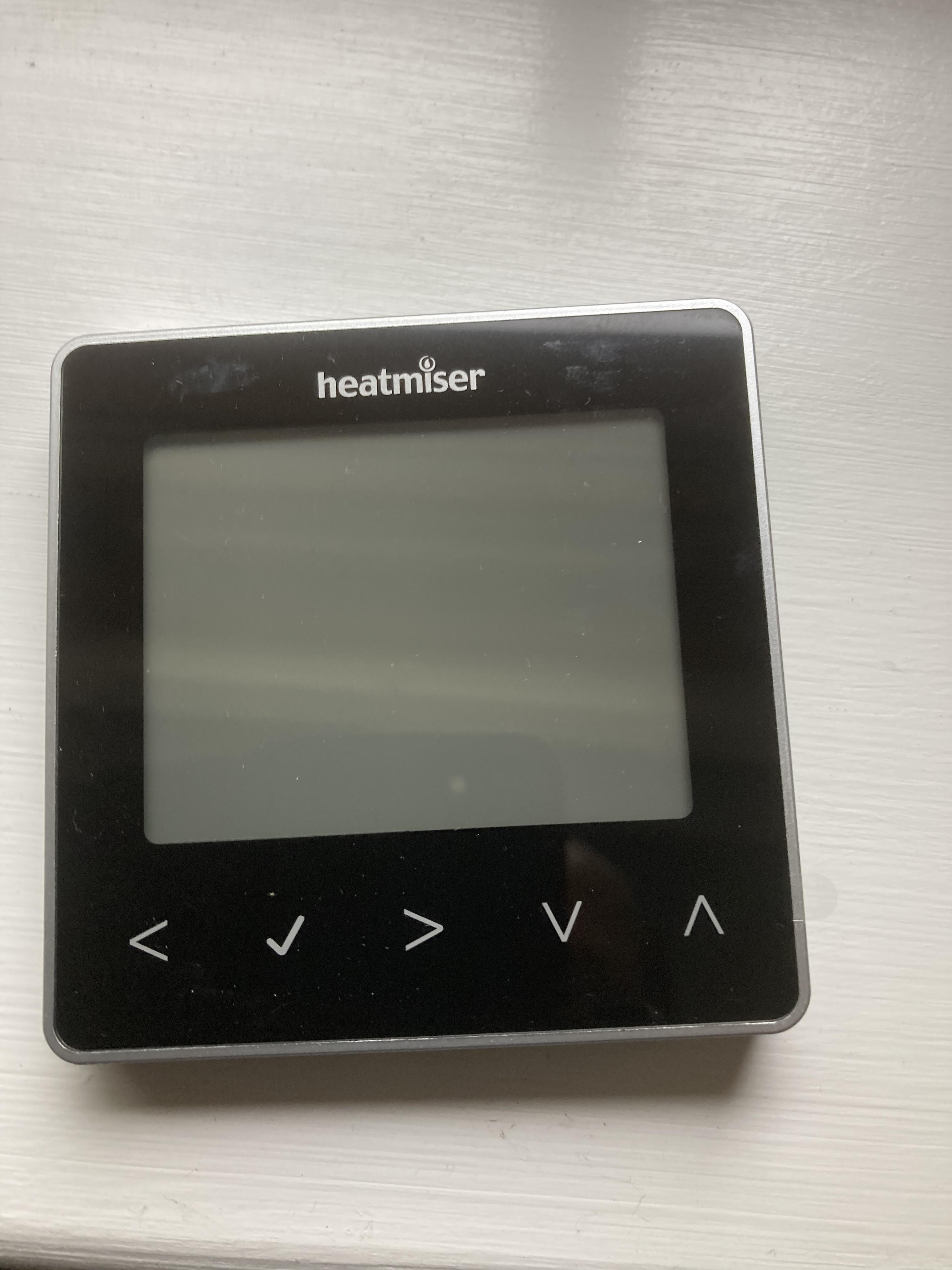

nod Posted September 11, 2021 Share Posted September 11, 2021 I wondered if anyone else has had a problem with these stats I had one pack in after three months and another after eighteen Three years on two different ones have failed The curious thing is that when I get a replacement The stats are fine It’s the back box that has failed Is this something that anyone else has come across Can the back boxes be purchased separate Link to comment Share on other sites More sharing options...
wozza Posted September 11, 2021 Share Posted September 11, 2021 Touch wood, mine have all been fine - are they the 240v version? There was a thread a while back, someone had some problems with them getting too warm so he made his own vented surrounds. Link to comment Share on other sites More sharing options...
nod Posted September 11, 2021 Author Share Posted September 11, 2021 (edited) 20 minutes ago, wozza said: Touch wood, mine have all been fine - are they the 240v version? There was a thread a while back, someone had some problems with them getting too warm so he made his own vented surrounds. Yes 240 I could understand more if the stat was falling But it works fine when I try it on another plate I’m building up a collection of stats Edited September 11, 2021 by nod Link to comment Share on other sites More sharing options...
dpmiller Posted September 11, 2021 Share Posted September 11, 2021 is the power supply built into the back bit? Link to comment Share on other sites More sharing options...
RHayes Posted September 13, 2021 Share Posted September 13, 2021 Screwing Heatmiser back plates back too tight is a common problem causing the back plate to bend away from the front screen and causing the pins between front and back to loose connection. I'd advise checking that the are just held in place and not wound back in to the wall. Link to comment Share on other sites More sharing options...
