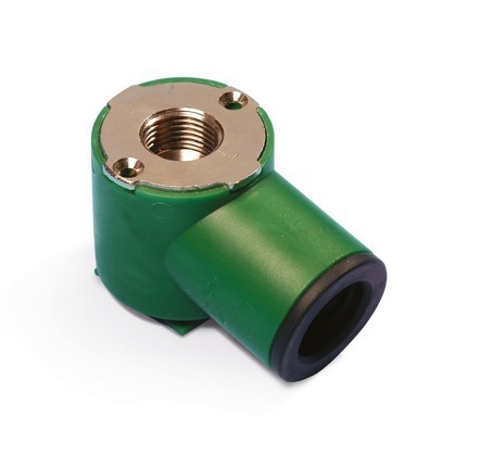

dogman Posted March 28, 2017 Share Posted March 28, 2017 I am fitting 22mm insulated pipes to the first floor terminating near to the heat pump. If we get too much overheating then i will fit fan coil rads capable of using the air source heat pump in reverse to cool upstairs. Only thing i need to look at is if you need to bypass the buffer when cooling? trying to find 22mm versions of below to tidy up pipework at floor level Link to comment Share on other sites More sharing options...

Barney12 Posted March 28, 2017 Author Share Posted March 28, 2017 3 minutes ago, dogman said: I am fitting 22mm insulated pipes to the first floor terminating near to the heat pump. If we get too much overheating then i will fit fan coil rads capable of using the air source heat pump in reverse to cool upstairs. Only thing i need to look at is if you need to bypass the buffer when cooling? trying to find 22mm versions of below to tidy up pipework at floor level So that angled connector is in the floor of each room? Link to comment Share on other sites More sharing options...
dogman Posted March 28, 2017 Share Posted March 28, 2017 two in each room under the floor and fixed in position and you can cap them with stop ends or something if you don't use them. The picture is a 15mm hep fittting Better than pipes coming through floor or left loose and cutting hole later Link to comment Share on other sites More sharing options...
