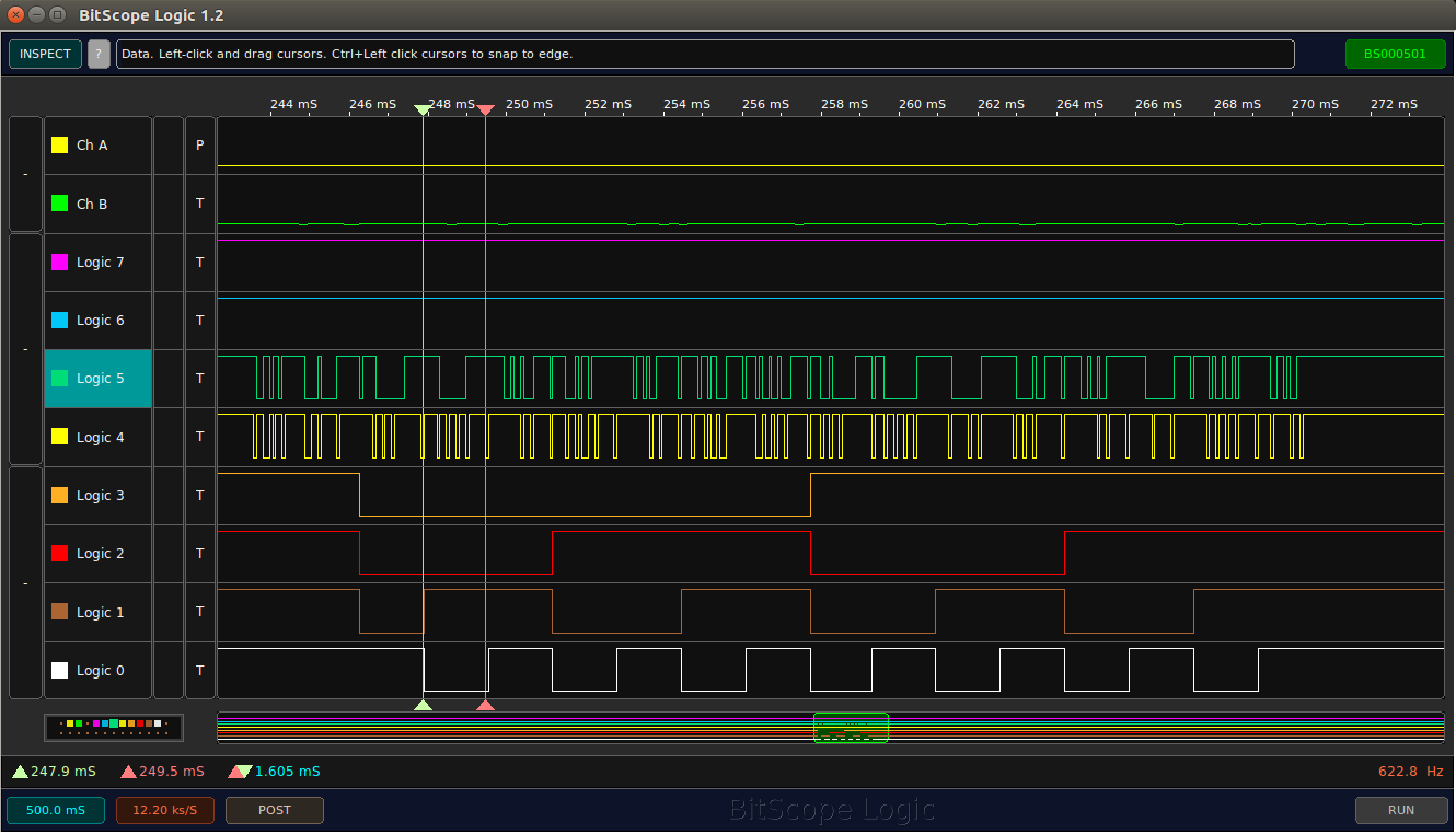

TerryE Posted March 26, 2017 Author Share Posted March 26, 2017 Not directly related to this thread, but something that I recommend for anyone needing to do hardware debugging is a Bitscope which you can get for around £80 (though I bought mine pre-vote for nearer £60). Even so it's for more than an order of magnitude cheaper then the DLOs we used to buy. 1 Link to comment Share on other sites More sharing options...
