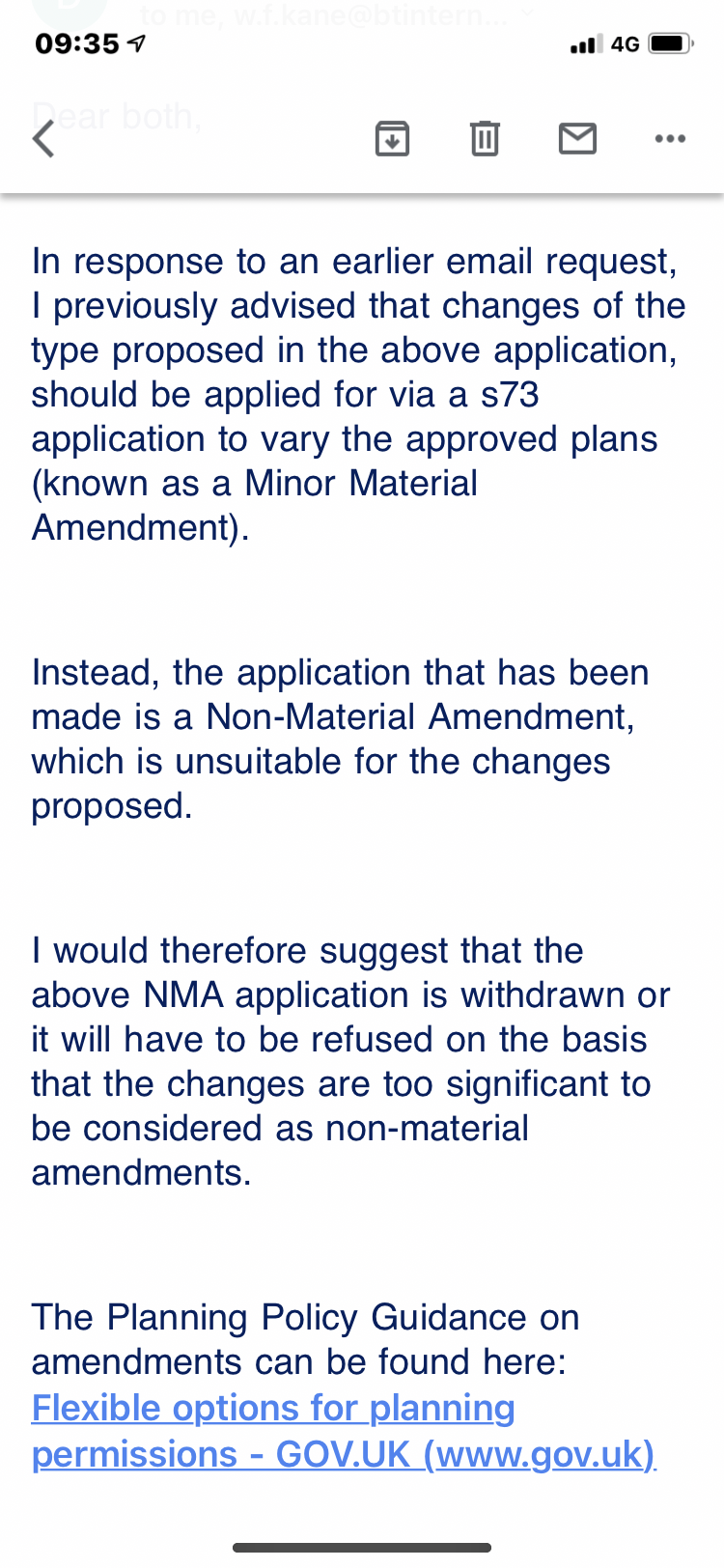

Temp Posted August 27, 2021 Posted August 27, 2021 Yes, sounds like the planners considered the proposed changes were too great to be an NMA and requested a MMA instead. But your architect went ahead with an NMA anyway. 1
DragsterDriver Posted August 27, 2021 Author Posted August 27, 2021 6 hours ago, Temp said: Yes, sounds like the planners considered the proposed changes were too great to be an NMA and requested a MMA instead. But your architect went ahead with an NMA anyway. i believe that’s the case. Actually spoke to the duty planner today about discharging my pre commencement conditions which was another task the architectnologist had and didn’t do- the planning officer is away for 2 weeks now. duty planner was really helpful on the phone- completely took me by suprise, happy to talk through forms and processes. Top service!
