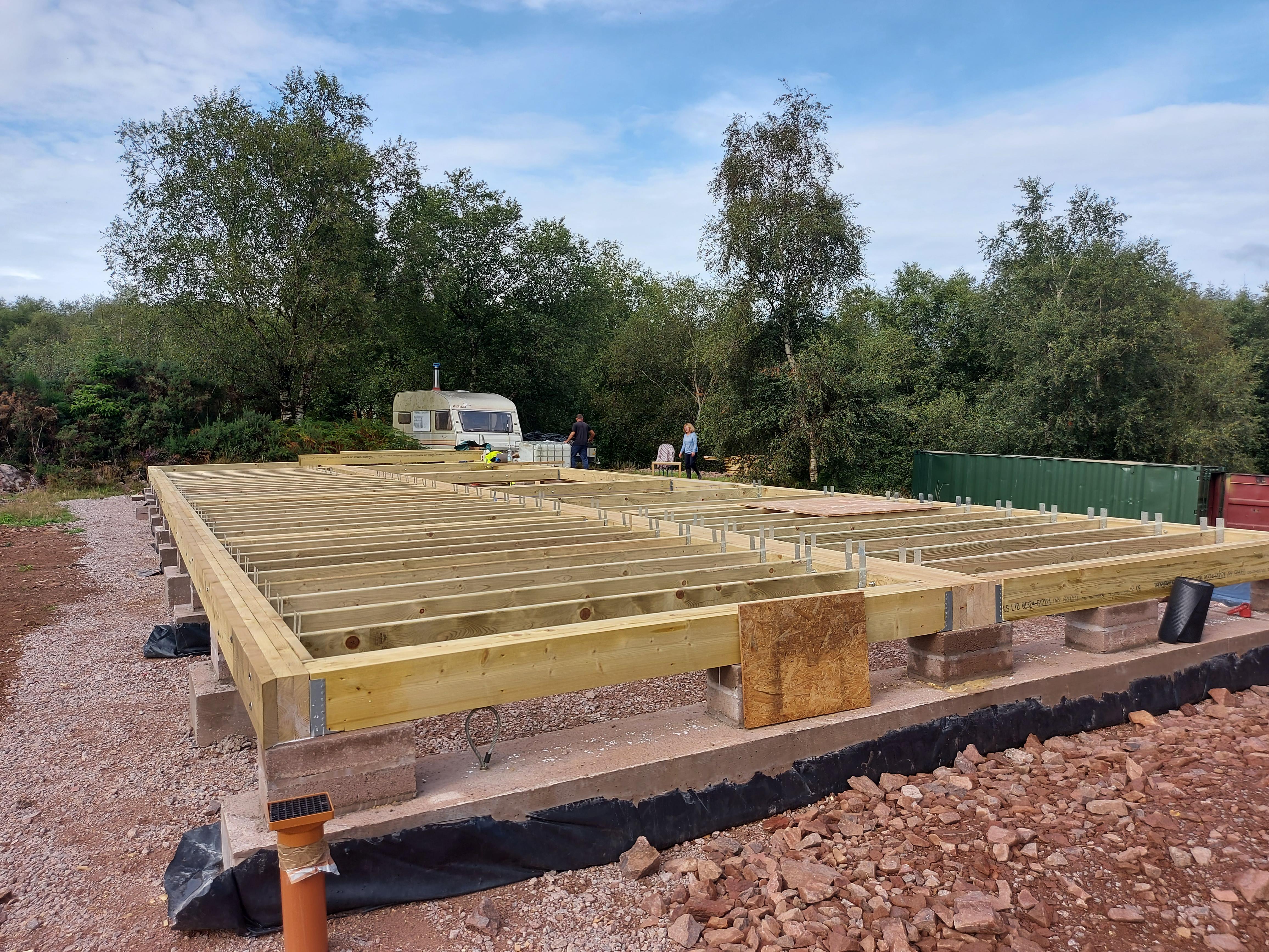

iSelfBuild Posted August 22, 2021 Posted August 22, 2021 Just building the subframe for my log cabins (200mm round log - hence it's so chunky) I need to deck this out with either OSB or Plywood so we can build the log walls safely. It will be replaced with 28mm Pine T & G once the roof is on. What is the minimum thickness OSB you think is safe at 400 centres? Trying to find a balance between burning loads of money on a temporary floor and it being safe! Also does anyone know of any paint that you can roller on which makes it waterproof and SLIP PROOF! No doubt we will be having some rain in October and November and we won't be throwing tools down.
ProDave Posted August 22, 2021 Posted August 22, 2021 We used 13mm OSB on 600mm centre joists. Yes it was a bit springy but nobody went through.
