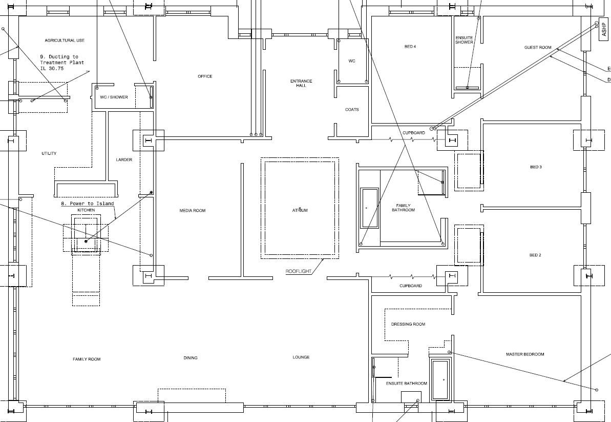

Thanks @Redoctober , The structure is a portal-framed, ex-cowshed, I've grown to appreciate it...
Here's a snapshot of the planned interior layout. Planning restrictions mean we'll be on a single level, although will have ceilings in some rooms with "Service Area" above.

What are you doing for the roof?  Will you just insulate under the existing roof or are you creating a "roof" under the existing one

@Calvinmiddle  I had seen the Glastonbury holiday home previously, and like what they have done. I looked at all options and have a very conservative LPA that insisted on maintaining the shape and form of the agricultural building. The banner image on my profile shows a rendering of what we have Approved.
There will be a new timber frame warm roof under the existing. And then I'll ply deck the existing and put on a standing seam rainscreen.

@PeterW  Yep, UFH clipped to the EPS and A193 mesh laid over the top. I felt there was less chance of any damage to the UFH pipe.
Floor is 300mm EPS - 0.1 U Value
Walls are 300mm blown cellulose fibre - 0.12 U Value.
Roof is 350mm blown cellulose fibre - 0.11 U Value.
Structure is cold-bridge free.
