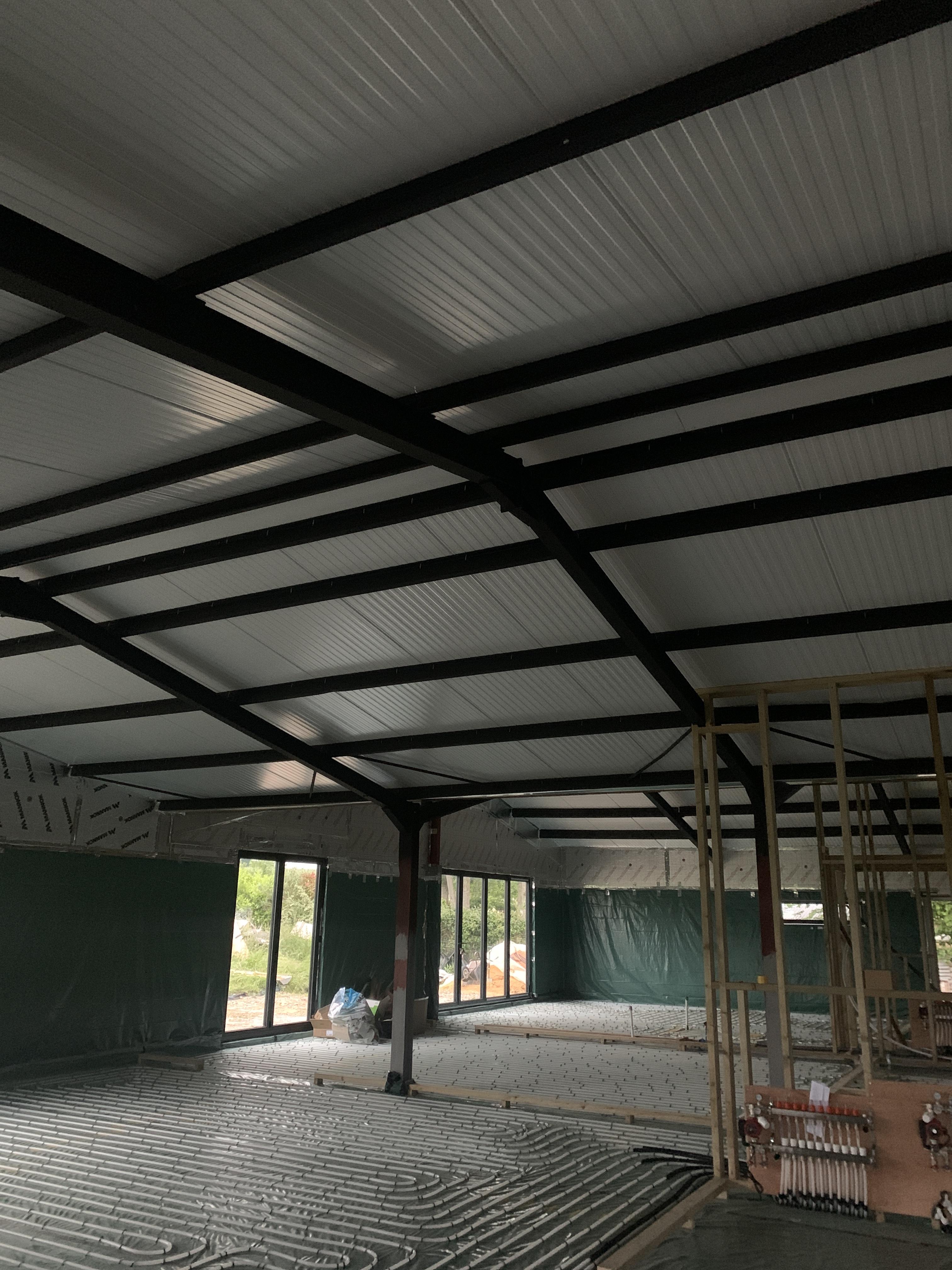

jen and mark Posted June 6, 2022 Author Share Posted June 6, 2022 We went for QuadCore KS1000RW Roof Panels thickness 137mm to give a u value 0.13W/m.K. https://www.kingspan.com/gb/en-gb/products/insulated-panel-systems/insulated-roof-panels/quadcore-ks1000rw-roof-panel This is our final finish - no plasterboard or additional insulation. We love it and it gives a nod to the industrial/agricultural steel barn that it used to be! Although the panels are not cheap it has saved us money on plastering! I will try and post a photo tomorrow so you can see! 1 Link to comment Share on other sites More sharing options...
jen and mark Posted June 6, 2022 Author Share Posted June 6, 2022 Forgot to say ... we have not had a blower test yet but the panels where well sealed as they were installed. Sound is a lot less than a poly carbonate conservatory roof when it rains which was a worry of mine 🤣 Link to comment Share on other sites More sharing options...
jen and mark Posted June 6, 2022 Author Share Posted June 6, 2022 1 Link to comment Share on other sites More sharing options...
jen and mark Posted June 6, 2022 Author Share Posted June 6, 2022 Sorry it’s a bit dark! Link to comment Share on other sites More sharing options...
daunker Posted June 6, 2022 Share Posted June 6, 2022 Very cool! You are well on with it, looks great! But I presume the stanchions are outside the insulation on the perimeter of the build? Are you going to leave the internal stanchions exposed, I guess no point in insulating them given the rafters are all exposed anyway. Looks an amazing space!! Be transformed once screed is down! Link to comment Share on other sites More sharing options...
jen and mark Posted June 7, 2022 Author Share Posted June 7, 2022 Cheers @daunker not to everybody's taste but we do have the option to plasterboard at a later date when we have more money - everything has doubled in price since we originally costed it out in Nov 2020! These things are something we can do anytime (though disruptive and messy). The main money has gone in the fabric of the build! We had to think hard about the insulation, thermal bridging and condensation (and class Q restrictions) so we wrapped the external stanchions in sprayed on closed cell insulation with a small amount of exterior insulation over the complete outside shell and the remainder inside. The roof provides full exterior insulation so the rafters are inside. The inside stanchions will also be fully 'wrapped' in foam and insulation apart from 1 which will remain open. We will always have an issue with thermal breaks from the stanchions in the ground but as had plenty of head room, we built the floor up with plenty of insulation! We got the idea from @IanR - see previous post that has some good photos of what he had done with his build. Hope this helps - we found it one of the most head scratching times in designing the barn as we have no architect. Everyone was telling us we would have condensation issues with no thermal breaks but our structural engineer and building inspector said that this would be very unlikely given what we have done and with the UFH and MVHR system - time will tell! What I have found is that compromise is the name of the game and as we hope to never leave, we are doing the best we can with the money we have - we are completely doing the work ourselves. Prior to this, we lived in an self build house built in 1963 so this has to be better! We are currently on ECP of B - 85 so are hopeful our blower door test will bring this down even further! 1 Link to comment Share on other sites More sharing options...
