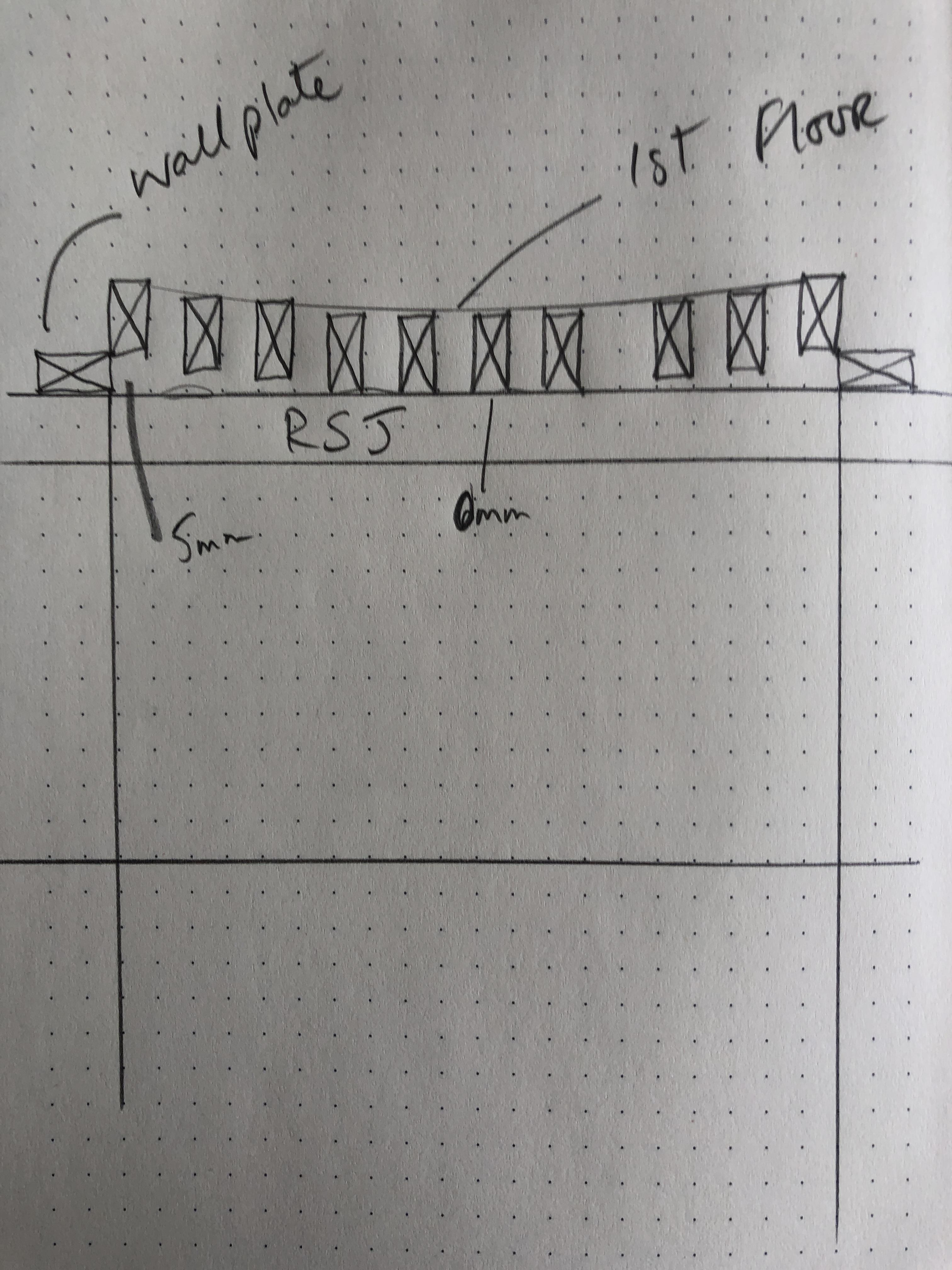

Kilt Posted August 13, 2021 Posted August 13, 2021 I have a RSJ supporting several joists that clearly suffered from bad deflection (bananas spring to mind). the worst joists are fully supported on the RSJ, but closer to wall plates there’s 1-7mm gaps between joist and rsj. Clearly these joists have less issues, so rsj isn’t needed. But to avoid any future deflection im thinking these gaps should be filled, whilst there’s access. If so… whats best way to fill these gaps? Wooded wedges, glued and whacked in? Kemfix Resin squeezed in?

Kilt Posted August 13, 2021 Author Posted August 13, 2021 15 minutes ago, markc said: @Kilt any pics? I’m struggling to get my head around this Can’t really get any photos… but Hope drawing makes more sense. Rsj runs across centre of room with joists flying over. it’s clearly been installed after joists became bananas, hence the worst offending ones are resting on the beam.
markc Posted August 13, 2021 Posted August 13, 2021 (edited) Now I see, I would go with double wedges - one from inch side sliding on each other, this creates a parallel pack that does not push the joist over just noticed it’s only 5mm at max. Plastic shims from screw fix etc. Edited August 13, 2021 by markc
Kilt Posted August 13, 2021 Author Posted August 13, 2021 6 minutes ago, markc said: Now I see, I would go with double wedges - one from inch side sliding on each other, this creates a parallel pack that does not push the joist over Thanks. Makes sense, I’ll give them a go. Access might be bit of a nightmare, which is why I thought something I could inject, fill gap, but sets rock hard. Hence thinking chemfix or some injectable mortar.

markc Posted August 13, 2021 Posted August 13, 2021 (edited) 23 minutes ago, Kilt said: Thanks. Makes sense, I’ll give them a go. Access might be bit of a nightmare, which is why I thought something I could inject, fill gap, but sets rock hard. Hence thinking chemfix or some injectable mortar. There are “gun-able” expanding grout materials out there but you really need something to contain the spill until it starts to go off, very messy, quite expensive and a pain to get right. if access is difficult and the floor is staying put then cut some long low and timber wedges and these can be knocked into place by sliding a hammer or flat bar across the top flange of the RSJ Edited August 13, 2021 by markc

Temp Posted August 14, 2021 Posted August 14, 2021 (edited) I think I would jack them up a few mm and insert one or two shims/plates cut from 1mm mild steel. Perhaps do the middle ones as well if they will move. One way to lift them a bit would be to cut a length of say 4x4 that is a few mm longer than the distance from underside of joist to the floor. Perhaps put down some plywood to protect the floor first. Then hammer it upright like a pit prop. Edited August 14, 2021 by Temp
Kilt Posted August 16, 2021 Author Posted August 16, 2021 On 13/08/2021 at 15:49, markc said: Now I see, I would go with double wedges - one from inch side sliding on each other, this creates a parallel pack that does not push the joist over just noticed it’s only 5mm at max. Plastic shims from screw fix etc. double slip wedges and some polyurethane glue has been working a treat. Thanks! 1

Kilt Posted August 16, 2021 Author Posted August 16, 2021 On 14/08/2021 at 01:59, Temp said: I think I would jack them up a few mm and insert one or two shims/plates cut from 1mm mild steel. Perhaps do the middle ones as well if they will move. One way to lift them a bit would be to cut a length of say 4x4 that is a few mm longer than the distance from underside of joist to the floor. Perhaps put down some plywood to protect the floor first. Then hammer it upright like a pit prop. Thanks, I might try this for the smaller gaps... but there's some weight on the joists (hence the bowing joists).
