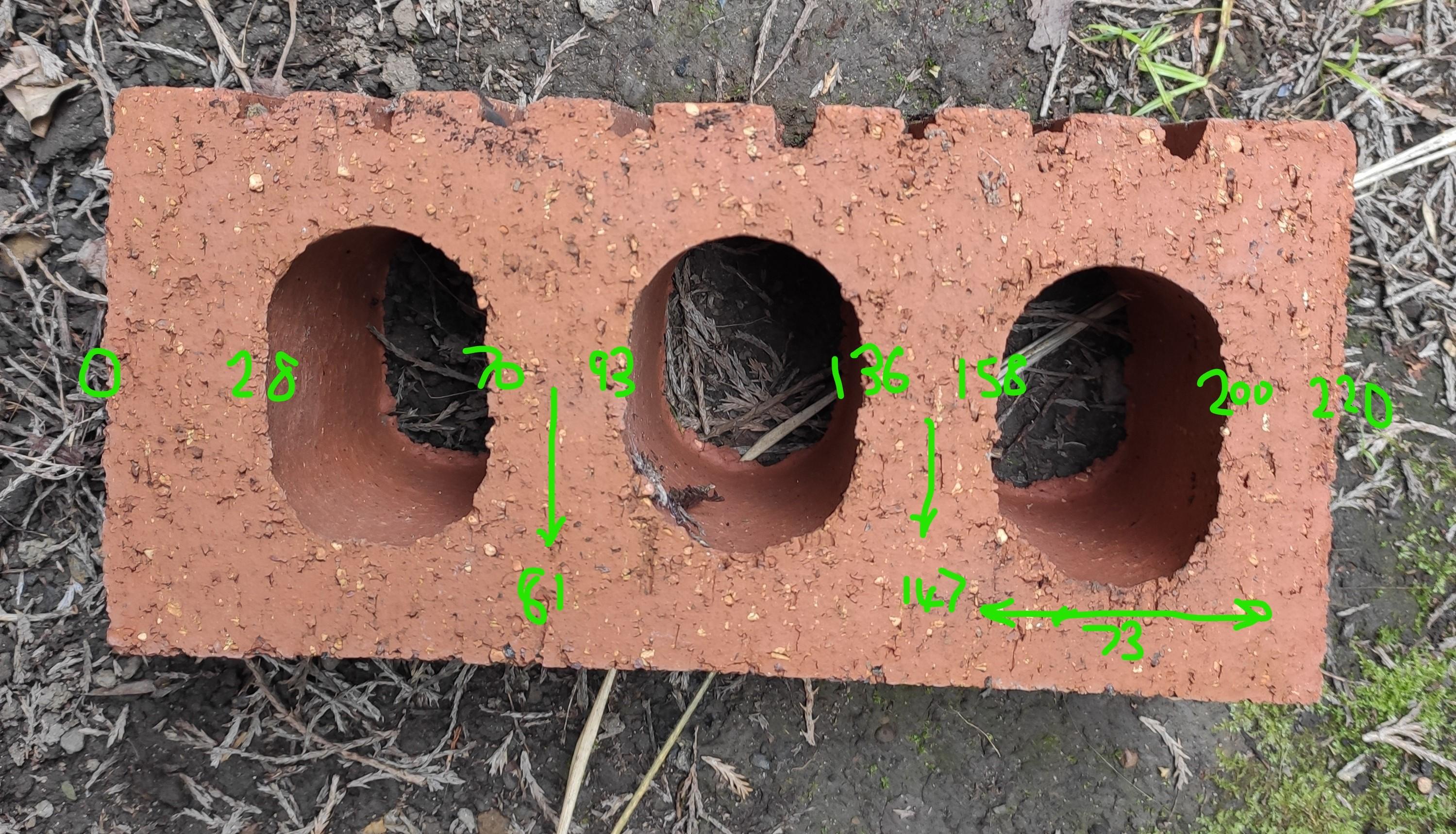

I was recommended to use concrete screws (x4) to fix the gate post to the wall but unfortunately I don't have solid bricks - there are 3 oval spaces in the brick and the spacing is not equal either (see photo). I'm attempting to use the the most solid part of the brick at 81mm but if the builder has laid the brick the other way round (rotate the brick 180 degrees) the the most solid part could be at 73mm. Therefore I could drill in and hit the side of the oval hole and get no fixing and I could make multiple errors. Should I be using a different type of fixing or should I fill the brick hole with concrete if I make a mistake (or does that have the potential of coming out with the weight of the gate when it's hung? Thanks

I would drill at the thickest point
Clean the holes with a vacuum Then resin fix some 15 mil threaded bar
You will be able to hang an Elephant off them the following morning
