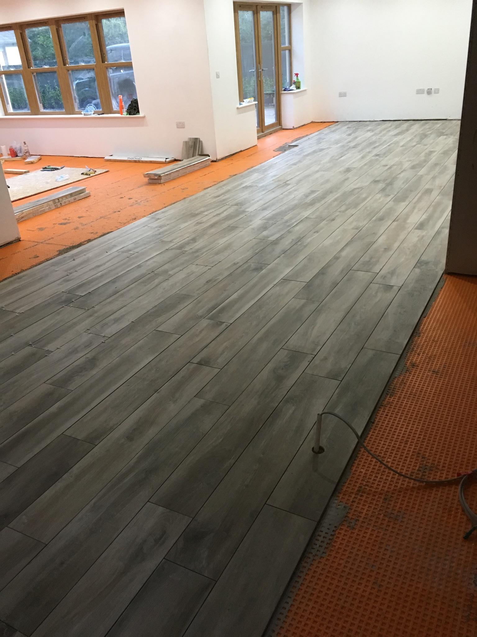

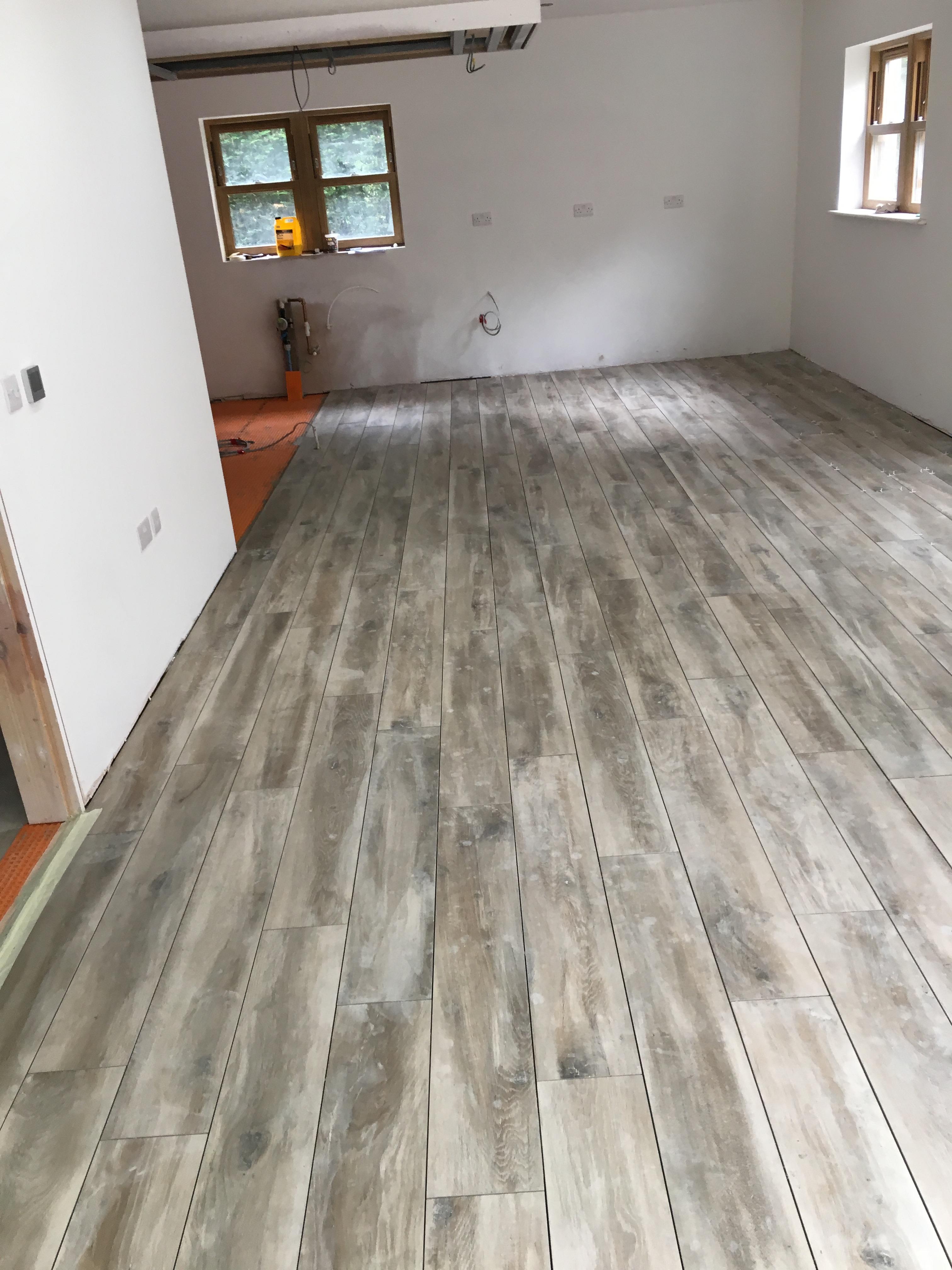

nod Posted July 30, 2021 Posted July 30, 2021 I run a tiling business and pay 22m2 and 3.50 m2 matting 1 charge 31m2 for planks They are site rates You may be up to 40m2 for a one man ban outfit I tiled our own in planks 158m2 It took me 5 days But don’t get on the tools as much as I did a few years back 1

nod Posted July 31, 2021 Posted July 31, 2021 22 hours ago, CotswoldDoItUpper said: We’re just about to pay £2750 inc. Ivory grout, flexible adhesive and sealer to lay 55sqm. (£50/sqm) plus £800 (£14.55/sqm) for the same area to have decoupling matting which we apparently need between the PIR UFH boards and limestone 600x900 tiles. think the tiling cost is ok but the decoupling matting is a That’s expensive The matting price is ridiculous Id expect one man to seal and Matt 55m2 for lunchtime Definitely 5 litres of SBR bonding agent Mixed 5-1 with water Rolled onto the floor Day before if pos 5 mil notched trowel Stanley knife and tape Get the whole room first then roll the matting up running a pencil line along the edge as you take them up So that you can put your adhesive down in narrow sections We normally use a rubber grouting float to flatten it down I put two sections down on ours and my wife did the rest over two afternoons 1
