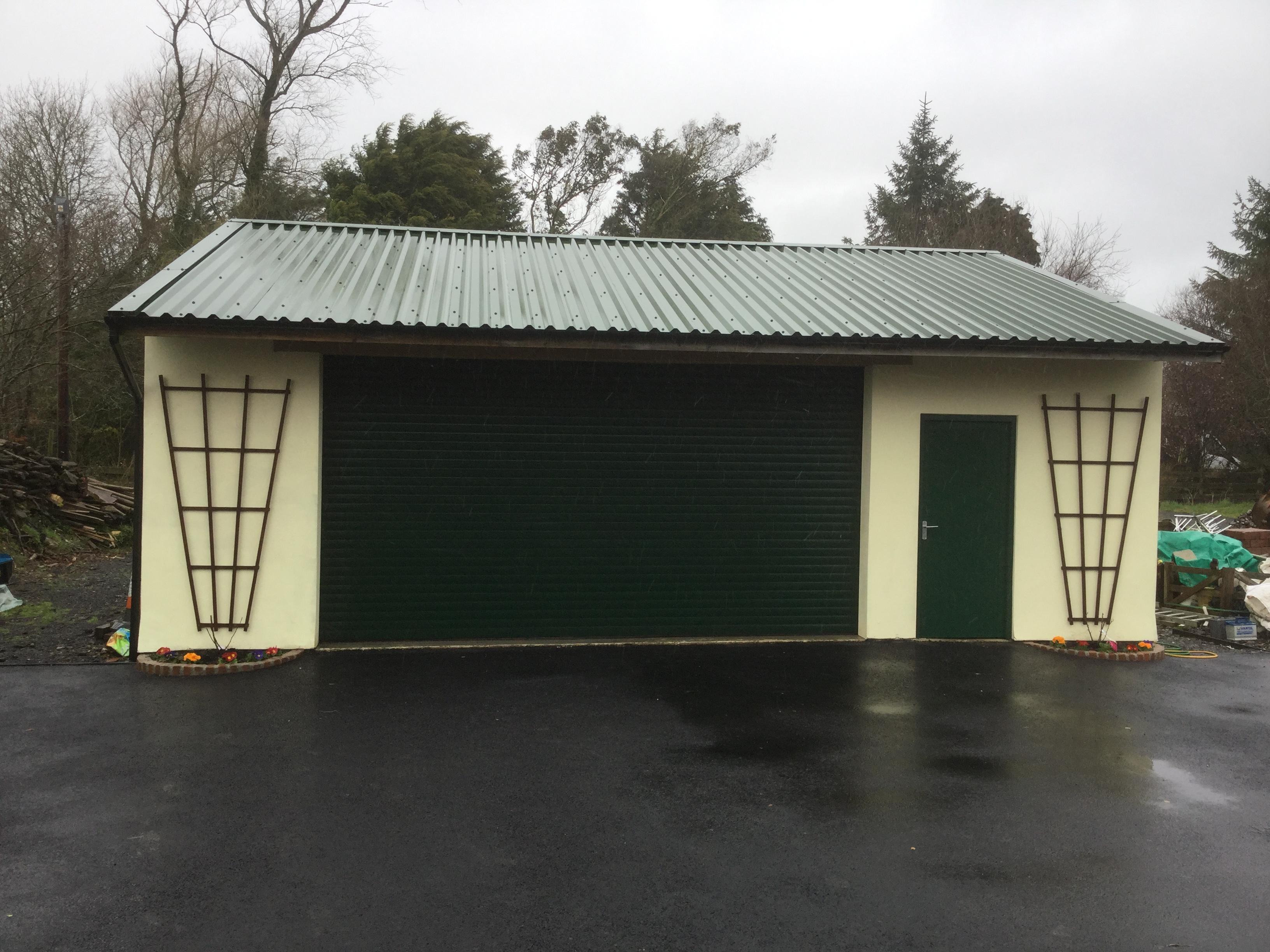

joe90 Posted July 23, 2021 Share Posted July 23, 2021 (edited) Well that sounds similar to the one I built, the only difference is I used roof trusses so no car lift ?. If you used a ridge beam you would have room for it. Trench founds, block with pillar construction, within PD rules, with the overhang of the roof I was able to keep it to 2.5m but the door clears 2.5m. I was worried about condensation from the metal roof and asked about fleece lined panels but they only really work in barn type construction (lots of air flow. Instead I simply used roofing felt under the metal roof and no condensation issues. It’s draughty enough to stop any mould, but cold in the winter (thermal longjohns ?). Edited July 23, 2021 by joe90 Link to comment Share on other sites More sharing options...
WestcountryWonderer Posted July 23, 2021 Author Share Posted July 23, 2021 Thanks. That looks very nice! I'm aiming for 2.5m clearance through the door (my Land rover is just over 2.3 high so need that and little spare for comfort!). Trusses are possibly an option for mine, but not sure if I'd spend more money getting them calculated and made than I would just stick building or going for SIPS which would be easier to keep the clearance. The insulation for me is partly having to comply with BR but also partly trying to keep a fairly stable temp summer and winter while also keeping the dampnesss out to stop things rusting! aread wise I could get in under PD as the garden would be big enough. But the height would prevent that I think and the proximity to the boundary definately prevents it. I cant afford to move it further off the bournary as that will be too restrictive so planning permission is the only option. Hence having an architecht take a look Link to comment Share on other sites More sharing options...
