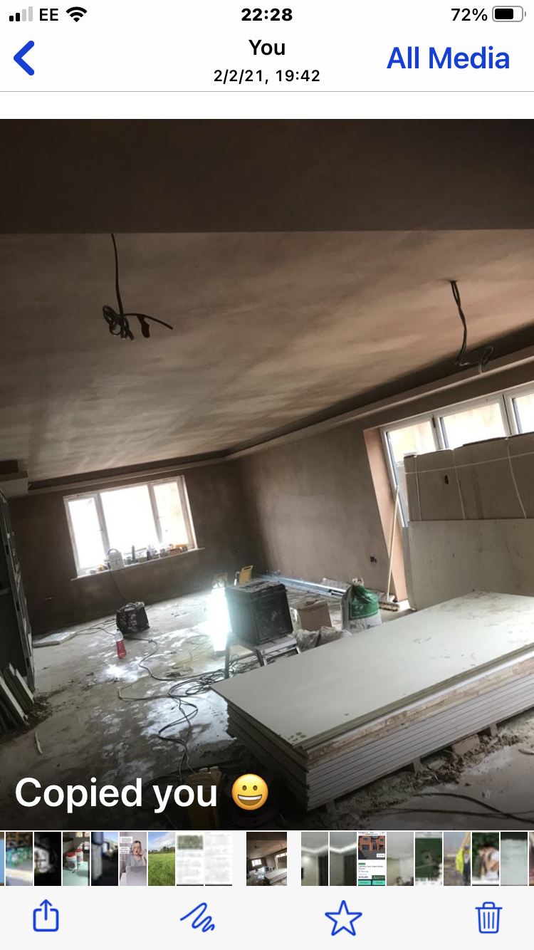

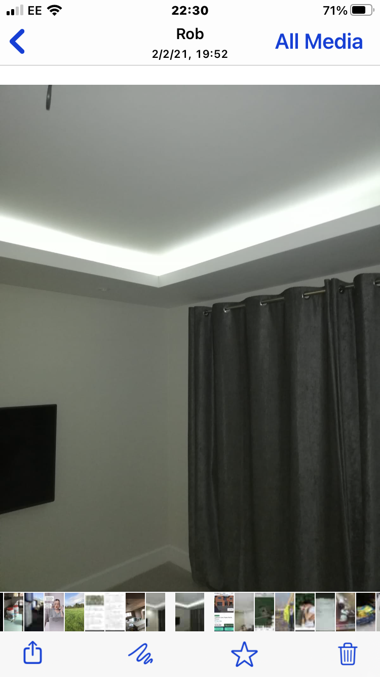

nod Posted July 15, 2021 Share Posted July 15, 2021 While I don’t do the wiring I’ve built lots bulkheads and coffers for lighting I did this one as a freeby for a friend a couple of weeks ago 1 Link to comment Share on other sites More sharing options...

Donegalsd Posted July 15, 2021 Author Share Posted July 15, 2021 Looks 22 minutes ago, nod said: While I don’t do the wiring I’ve built lots bulkheads and coffers for lighting I did this one as a freeby for a friend a couple of weeks ago Looks Great, it's a bit of a spin from Preston to Donegal though ?. How wide/deep do people usually make these? I'm thinking about doing the strip the other way round, with the recess/gap immediately beside the window/wall edge. Thanks Link to comment Share on other sites More sharing options...
nod Posted July 15, 2021 Share Posted July 15, 2021 21 minutes ago, Mr Punter said: Can I be your friend as well please? Ha ha He told me he was on a budget and gave me 200 quid for the board I’d a long day boarding and building the pelmets and most of a day skimming it Think I finished down on the materials also ? Seriously I’ve done some really elaborate ones for restaurants and hotels Link to comment Share on other sites More sharing options...
nod Posted July 15, 2021 Share Posted July 15, 2021 18 minutes ago, Donegalsd said: Looks Looks Great, it's a bit of a spin from Preston to Donegal though ?. How wide/deep do people usually make these? I'm thinking about doing the strip the other way round, with the recess/gap immediately beside the window/wall edge. Thanks ? Yes that would be my preference also Link to comment Share on other sites More sharing options...
