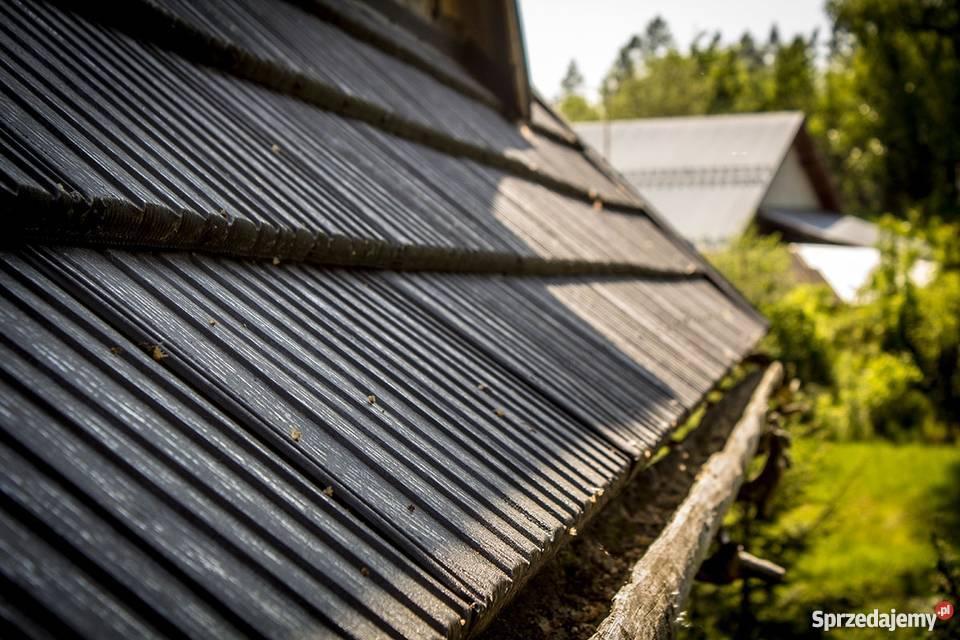

Patrick Posted July 11, 2021 Share Posted July 11, 2021 5 hours ago, JaneF said: Any thoughts on Spanish slate vs metal profile roofing for a green oak clad barn conversion? How about metal shingles? 1 Link to comment Share on other sites More sharing options...
