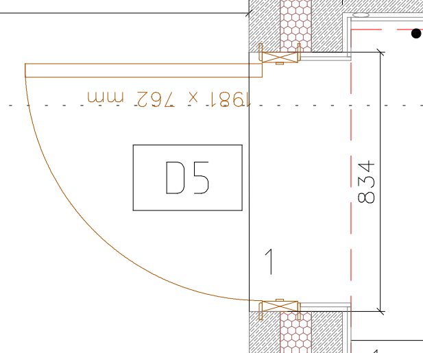

Moonshine Posted June 29, 2021 Posted June 29, 2021 I have a door from an internal space to a integral garage that is in block work as below, this is how it is shown on my BR drawings, but i want to make sure that this structural opening in enough for the 762mm door. Does anyone have a example of the detail of this type of door, i presume its need a cavity closer in it too. around the perimeter that the opening will need to account for.
Russell griffiths Posted June 29, 2021 Posted June 29, 2021 (edited) Why have you gone for a 762 door, far too small in my opinion. I would also say your rough opening is tight, doesn’t allow a lot for packing out the door lining. Edited June 29, 2021 by Russell griffiths 1
PeterW Posted June 29, 2021 Posted June 29, 2021 Cavity closer will be 2-3mm at most. You want a decent fire door frame in there - and also make it an 838mm door too. An FD30 trenched frame for a larger door is 906mm wide, so with 5mm either side you would be well to put a 920mm structural opening in and also go with 145mm deep frame too. 1

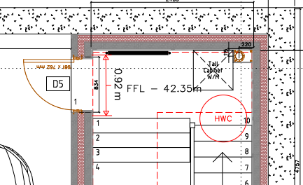

Moonshine Posted June 29, 2021 Author Posted June 29, 2021 (edited) 2 hours ago, Russell griffiths said: Why have you gone for a 762 door, far too small in my opinion. Its a tight space, as below due to the steps not shown in the previous image, though a 920mm SO may work if i shift the stairs a little bit. Edited June 29, 2021 by Moonshine
