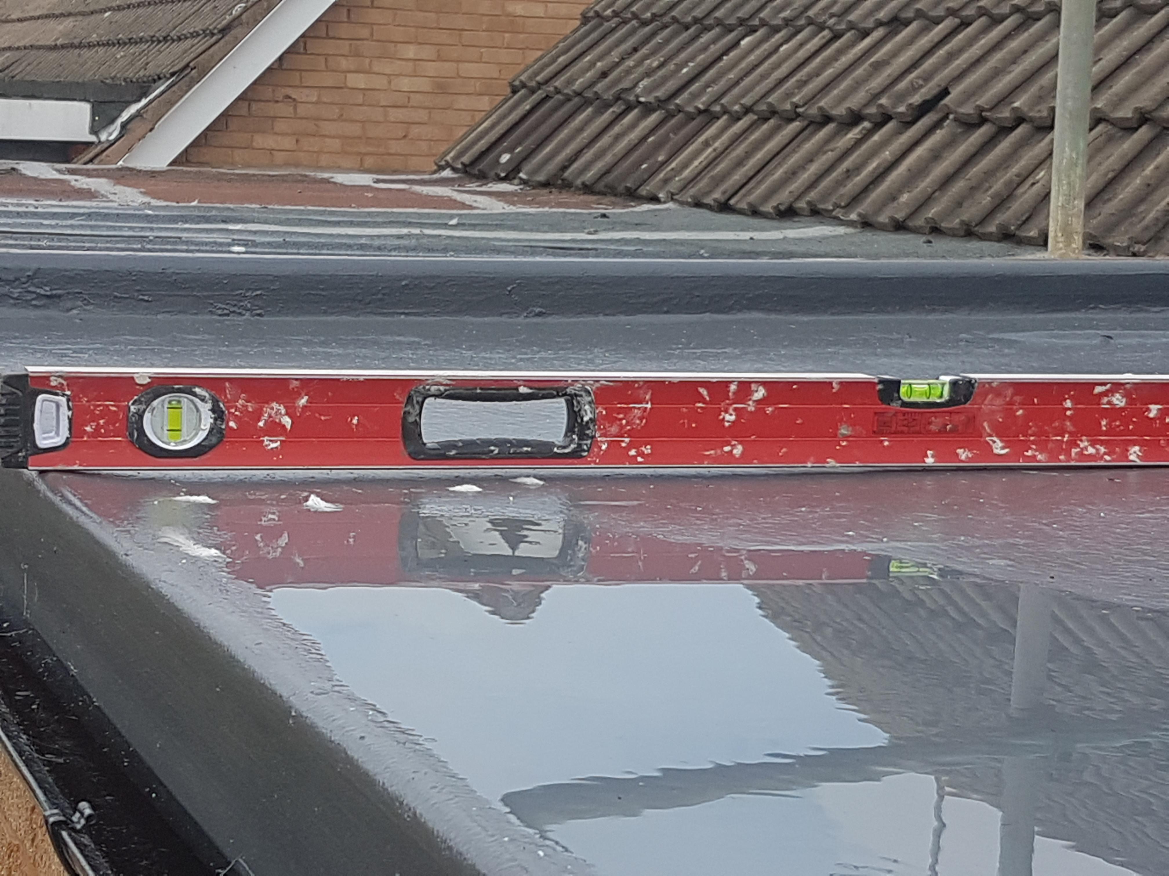

I've had two flat roofs on my dormer totally stripped, re-boarded and covered with Cromar grp, its only been done a week and there's already standing water. There is a fall on both roof's but they have a dip near the edge, I've pulled the roofing company about it and there response was simply "its a flat roof what do you expect" surely this can't be right.
Any advice would be most welcome.
Thanks
Unfortunately
It is quite normal
Not much consolation I'm sure but I have worse than this on a newly laid PVC roof:
Similar kind of response from the roofing contractor. He did acknowledge that there is a step up to the outlet and that significant work would be needed to rectify. I just wish it was pointed out to me before as I would have corrected it. I've put it down to experience.
