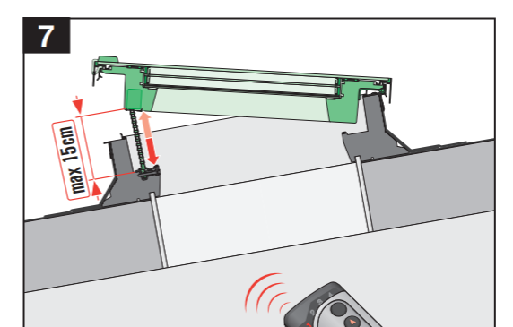

Adam2 Posted June 28, 2021 Share Posted June 28, 2021 Am about to order a couple of these 1m x 1.5m and need electric opening. Was quite interested in Fakro but the opening area seems really small only 150mm Any others have found similar but with a better opening size? Link to comment Share on other sites More sharing options...
SteamyTea Posted June 28, 2021 Share Posted June 28, 2021 4 hours ago, Adam2 said: Any others have found similar but with a better opening size Can you fit one on top of the other? Link to comment Share on other sites More sharing options...
Wumpus Posted June 29, 2021 Share Posted June 29, 2021 I will be needing two 1000x1500 roof windows later this year. Take a look at Lamilux - they have several options for motors, including a concealed option, and can open 300 or 400mm. There’s a configuration tool on their web site https://www.lamilux.co.uk/skylights/products/flat-roof-window/glass-skylight-fe-3-with-aluminium-profile.html Link to comment Share on other sites More sharing options...

Red Kite Posted June 30, 2021 Share Posted June 30, 2021 We have a sliding flat roof light from roofmaker which opens about 3/4 of the size, its electric . Its triple glazed with a rain sensor 1 Link to comment Share on other sites More sharing options...
