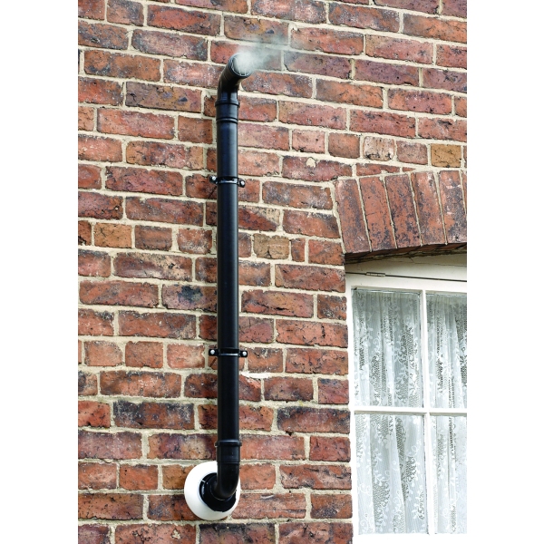

Nickfromwales Posted March 8, 2017 Posted March 8, 2017 Consider a plume management kit... Many different configurations are possible. ?
Jeremy Harris Posted March 8, 2017 Posted March 8, 2017 That looks suspiciously like drain pipe! Had we been staying in the old house then I think I'd have looked at fitting one of these, as we have a clear stretch of wall with no windows above the boiler flue, right up the end gable.
ryder72 Posted March 8, 2017 Author Posted March 8, 2017 That is an option. We can exit near the ceiling and then run up the external wall to the top of the parapet.
