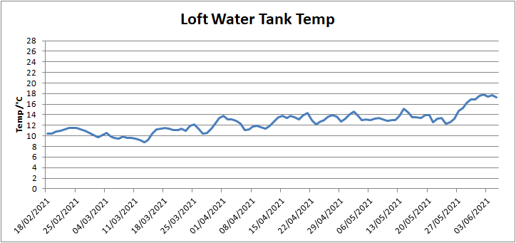

SteamyTea Posted June 5, 2021 Posted June 5, 2021 32 minutes ago, MortarThePoint said: Underneath rafters in a loft space Just remembered, a guy I know, researched some plasterboard replacements that used phase change waxes to store energy. He fell for the marketing bluff (he was an ex marketing bloke), but when we all looked at the technical limitations, it was not so impressive as you are basically stuck with the one temperature range of about 3K. You could make boards with variable ranges, in layers to increase that to say 10K, which may be useful. Or you could go back in time and put a water tank in your loft and let the ambient air increase the temperature, a tank with a larger surface area to volume ratio would heat up easier. Here is what has happened to mine the last few months.
MortarThePoint Posted June 5, 2021 Author Posted June 5, 2021 (edited) Interesting to see the tank temperature. The wax plasterboard won't do anything for you up until it starts to melt and then it should clamp the plasterboard, and therefore likely the room temperature too, until the wax has all melted. After that the temperature would continue to rise, but it's a lot of heat by then. Edited June 5, 2021 by MortarThePoint

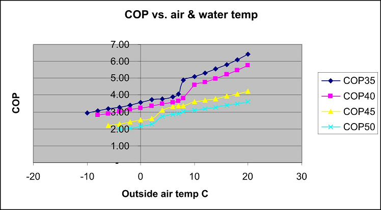

MortarThePoint Posted June 9, 2021 Author Posted June 9, 2021 (edited) Oh dear, I think I have thought of two more issues unfortunately. I hope I'm wrong on the first as that's an absolute killer for commercially available PCM for everything other than immersion heater based applications in which case they are still debatable (e.g. you'd be better of with the batteries or having a small ASHP or showering in the morning which is most likely anyway). Someone please spot the mistake as this is a bloodbath. @SteamyTea or @Jeremy Harris can you throw it a lifeline? 1. Capacity measured in Heat or Electricity Equivalent? If the 12kWh Sunamp capacity is for heat, which I suspect it is (above assumed it was electricity equivalent) then the numbers are much less favourable: 12kWh(heat) = 4kWh(electricity) [1] Sunamp charged up by running the ASHP off peak. Expected cost ~£500 - 750 per kWh electricity. 4kwh Lithium batteries charged up off peak, inverter to then run ASHP. Expected cost around £200 per kWh [£100/kWh for LiFePO4 batteries and £400 for charger and inverter guestimate] (£0.21/kWh * 85% * 4kWh) - (£0.12 * 4kWh) = £0.71 - £0.48 = 23p/day I also falsely assumed you'd have the heating on all yeah (D'oh). Guess 200 days per year so £46/year or £460 across 10 years. [1] assumes a constant COP of 300%. 2. COP worse at night The Sunamp side of things gets worse due to reduced night time COP of the ASHP as well unfortunately. At night the outside temperature will be lower and so the COP likewise. Using the graph below, the COP at 3C is around 225% and the COP at 8C is around 300% (based on 50C flow temperature which has the smallest kink). (£0.21/kWh * 85% * (12kWh/(300%/225%))) - (£0.12 * 12kWh) = £1.61 - £1.44 = 17p/day [Assuming the capacity is 'electricity equivalent'] (£0.21/kWh * 85% * (12kWh/300%)) - (£0.12 * (12kWh/225%)) = £0.71 - £0.64 = 7p/day [Assuming 1 above] (£0.21/kWh * 85% * (12kWh/300%)) - (£0.12 * (12kWh/275%)) = £0.71 - £0.52 = 19p/day [Assuming 1 above and avoiding the kink] Guess 200 days of heating per year so £34/year or £340 across 10 years best case, £14/year or £140 across 10 years worst case. Perhaps 50% of the heating days manage to avoid the kink (overnight temperature above 3C would mean £26/year or £260 across 10 years. First google result for "ASHP COP graph" https://originaltwist.com/tag/cop-for-ashp/ Edited June 9, 2021 by MortarThePoint
SteamyTea Posted June 9, 2021 Posted June 9, 2021 5 hours ago, MortarThePoint said: at 3C is around 225% and the COP at 8C is around 300% You have to use the Kelvin scale to get the true difference. To be honest, we should all use the Kelvin scale, for everything. Phase change thermal batteries are not cheap. I think in the order of things it is: PV (if used when generating) Water Storage Battery Storage PCM Storage This is more to do with the scale of production and the usefulness (entropy)
MortarThePoint Posted June 9, 2021 Author Posted June 9, 2021 1 minute ago, SteamyTea said: You have to use the Kelvin scale to get the true difference. I'm just reading of the graph rather than calculating the Joule-Kelvin effect. I suspect commercially available PCM looks to be a 100year payback candidate, i.e. never as it wouldn't last that long. If so, the environmental cost of manufacture would also never be recouped. It might work for a solar thermal hot water system, but again other technology would probably beat it there too (PV+batteries or just batteries).
