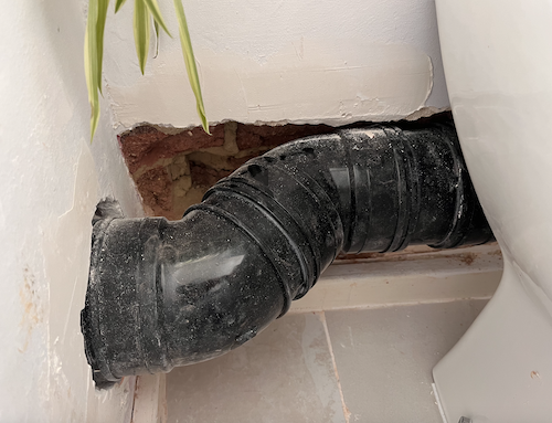

Water Posted June 6, 2021 Author Posted June 6, 2021 On 04/06/2021 at 17:13, Vijay said: Did you get a chance to measure what's been removed/left? yeah only managed to get down there today. It’s mostly 30 to 40mm with the a small section at 50mm.
Vijay Posted June 6, 2021 Posted June 6, 2021 3 hours ago, Water said: yeah only managed to get down there today. It’s mostly 30 to 40mm with the a small section at 50mm. removed or what's left?
Water Posted June 6, 2021 Author Posted June 6, 2021 (edited) Sorry Vijay removed, the whole section is about 2m long. Edited June 6, 2021 by Water

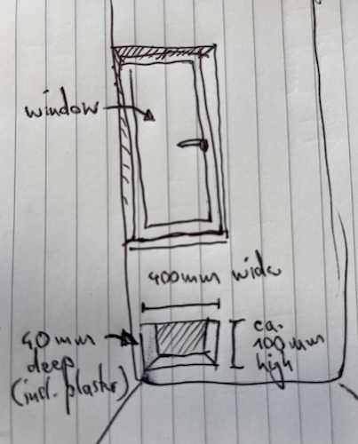

john1 Posted March 27, 2024 Posted March 27, 2024 (edited) Hi, what a challenge! Plumbers seem to do whatever,... I have a similar question. A plumber cut a hole in the external wall to make space for a waste pipe. The cut is about 40mm deep, 400mm wide and ca. 100mm high. The wall is an old brick wall, that is ca. 360mm thick. Equally, my question is whether I should be worried about structural integrity? The cut is smaller than 1/6 of the thickness of the wall - however I also understand that such cuts are not commonly done anymore. One hope is, that because its underneath a window, not much weight is put on that part of the wall - but the weight sits more left and right of the window see sketch attached Edited March 27, 2024 by john1
BotusBuild Posted March 27, 2024 Posted March 27, 2024 John - don't worry 40mm out of 360mm will make an insignificant difference.
